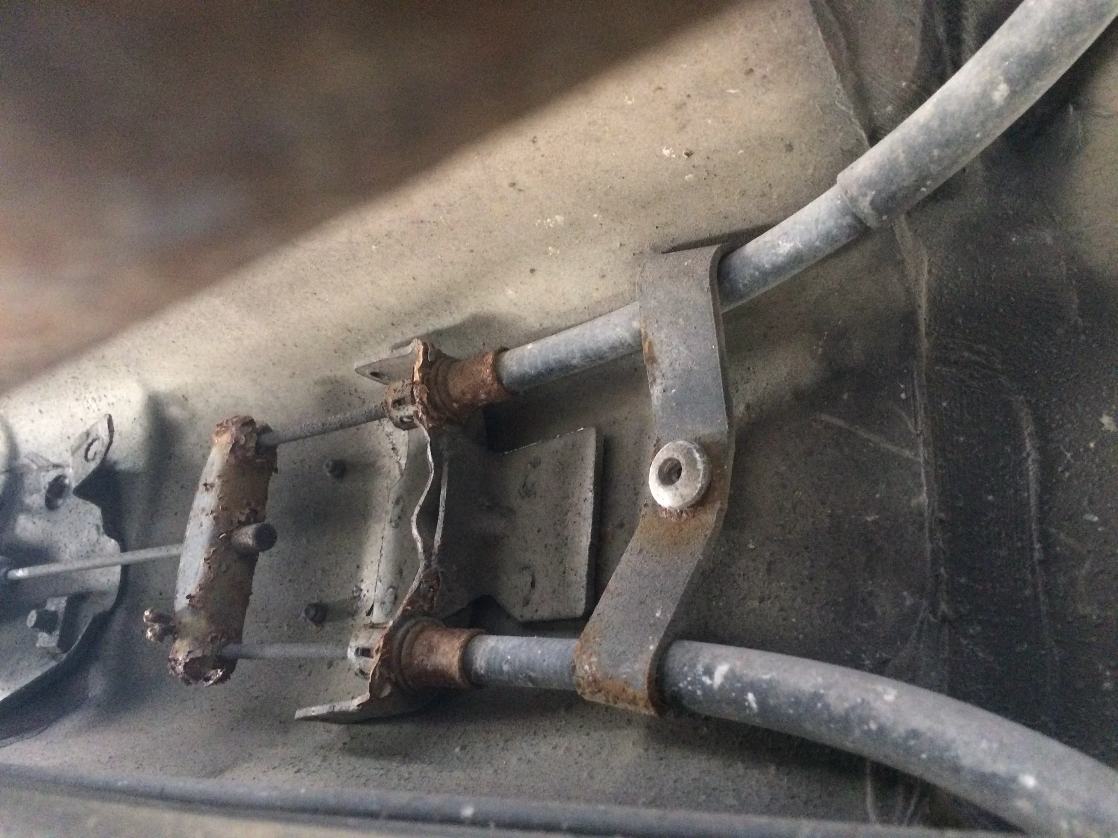

You can use the cables from the 95GT. You will need the front mounting bracket (that attaches in the tunnel) to mount the front end of the cables. I would use the e-brake handle as well from the 95. You may need to rework the rear mounting tab though.

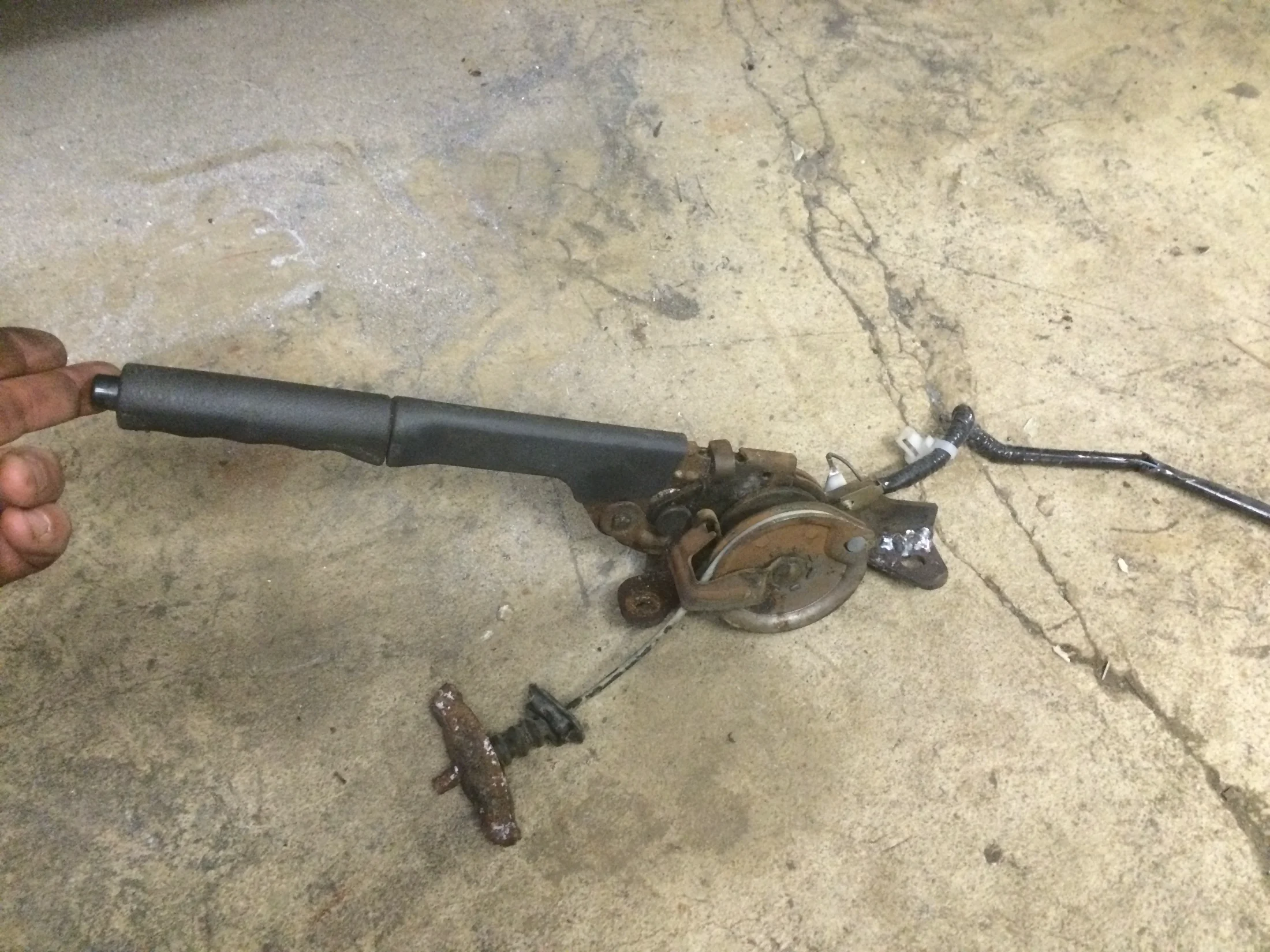

I did this same set up on my 90GT. I used a e-brake handle from a 2001 V6. I had to cut the rear tab off and reweld it on about an inch forward. The nice part of doing this is the spring on the handle is already correct - no further mods needed. You could use your foxbody handle as reference for the exact measurement.
Handle with rear tab relocated.
Front cable mount, not the holder with the center rivet.
