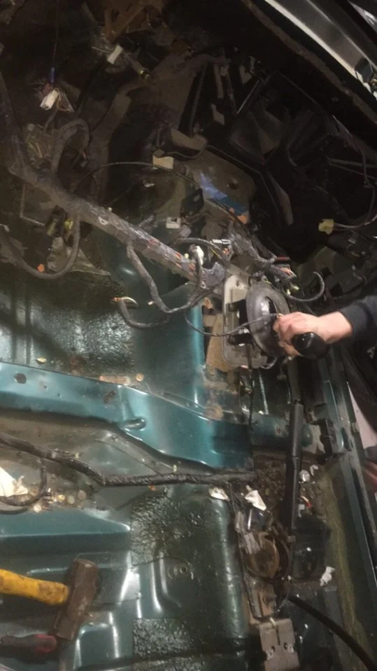

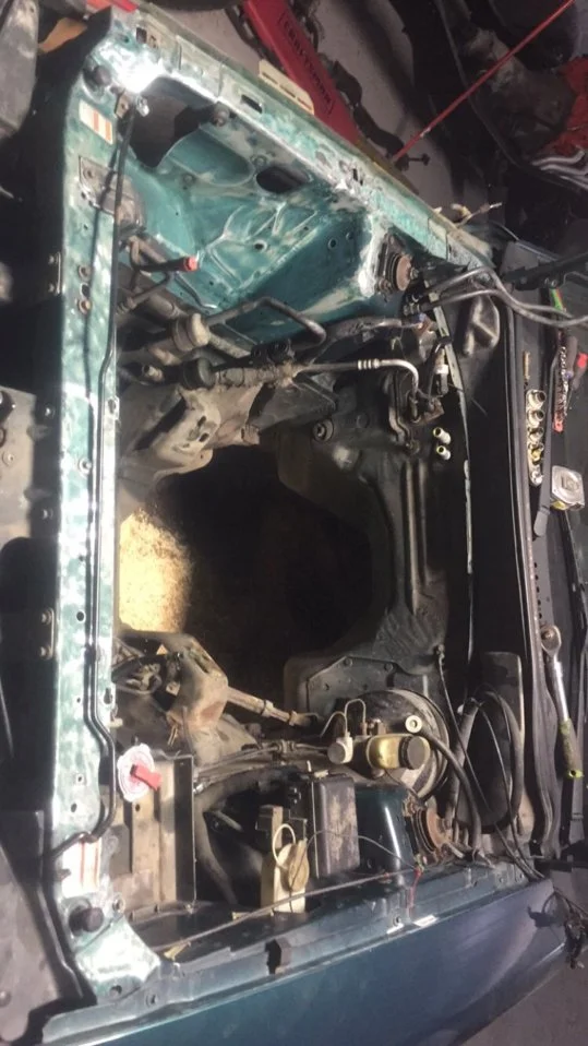

Currently started a new mustang project. Took a little time off from my fox. I purchased a 1997 mustang 3.8 and had a spare 4.6 motor and a whole donor car that a buddy of mine wrecked a while back. Anyways I just wanted to share and show everyone my progress and how to do this VERY difficult swap. I am currently about halfway through. First off. You need to pull the v6 motor and wiring harness and transmission. (Best to do them both at the same time) after you get that pos out of the way you will need to pull off the passenger fender and go inside under the passenger side dash and pull the kick panel off and the computer out. Then pull the wiring out outside the car. (Also a pain). You will need a new computer and wiring harness for a v8 car. Also you will need a new v8 gauge cluster. Some say you need a whole new dash, but I would argue against that. Next you will need a new hydro boost brake system out of the v8 car. The v6 brake booster is too large for the v8 motor. To swap over the brake system you will need to change out the power steering rack and pinion also. If you were going to change from auto to manual now would be the best time to do it. Pull out the steering column (5 bolts and some wiring I believe.) and then just unbolt the pedal assembly and reinstall the new one and run your clutch cable as you are doing so. 5 bolts. And some wiring and spring loaded assemblies. Pretty straight forward. It was pretty easy for me considering I had my dash out but it's not too bad. This is as far as I got. I will keep updating and show pictures as I go along. I know a lot of people have attempted this swap and there are always people that tell you not to but if you have to recourses and are mechanically inclined I say the hell with them. I will keep you posted. (Sorry for the disorganization).
You will need tons of different parts so buying them individually you will have a small fortune in it. So the best thing to do is find a donor car with everything you will need.

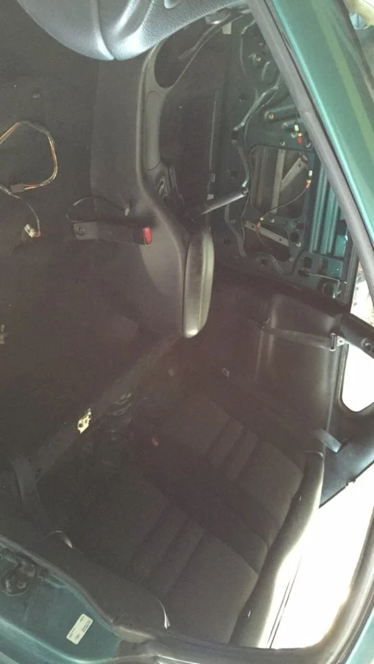

Just swapped out the rack and pinion out of the v8. Figured I better paint the engine bay and then put the hydro boost system into the car and get that all hooked up and figured out tomorrow night. Coming along nicely, not bad so far for somebody who don't know :poo: about painting. I'm about 2 weeks into this swap. Need to get the brake system hooked up so I can put my pedal assembly in and then I can get the new dash put in as well as the rest of the new interior. Looking forward to cruisin this to ocean city cruise week in Maryland next month hopefully.

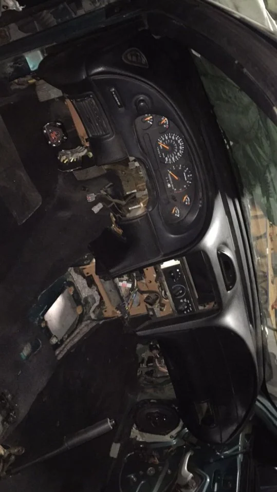

I don't know if you guys are still watching up on this post but I've got caught up in some things. Still made a little progress though. Finally got the pedal assembly and dash installed as well as the back part of the interior and the carpet. Still working on swapping all the motor :poo: around. I ran into an issue with hooking up the clutch pedal. There is one wire that is missing in the main wiring harness that goes to the front for headlights and all the way to the back for the taillights. Do I need to swap all that wiring harness out or how?

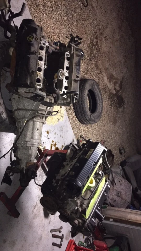

Whoops, I didnt mean to press post. But what I was saying is that I bought the motor and turns out they are very different it seems for the explorers and truck motors. I don't know if it would be worth it swapping everything over and not even be sure if it's going to work. 200 bucks in gaskets probably if I was to swap everything over. I'm gonna put the motor up for sale and hopefully one of my local hookups has another motor reasonably priced. I've already made a few calls asking around. I can buy one all day for 500.

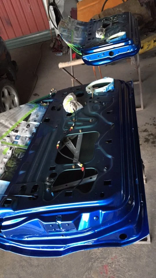

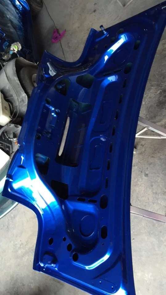

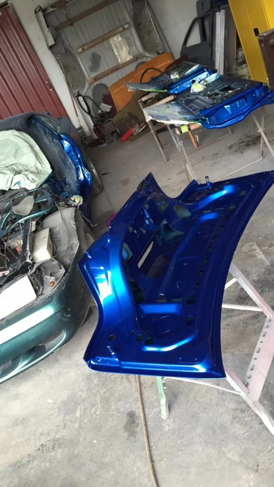

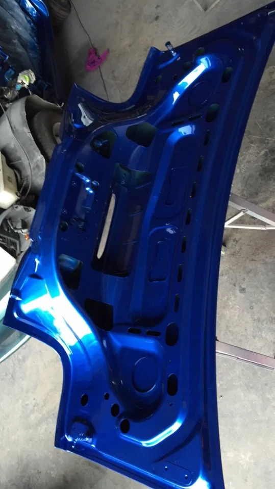

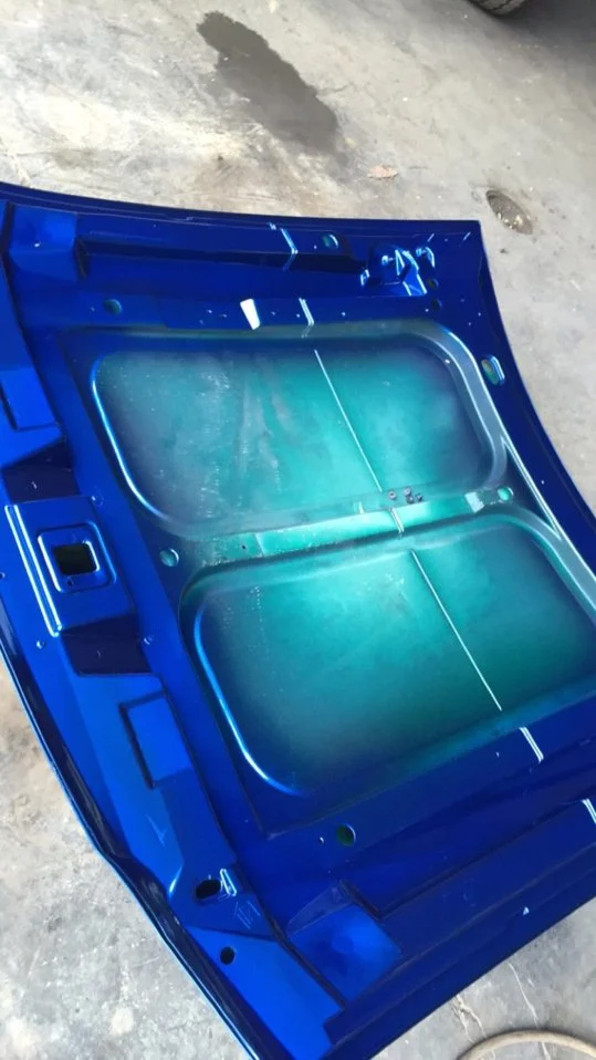

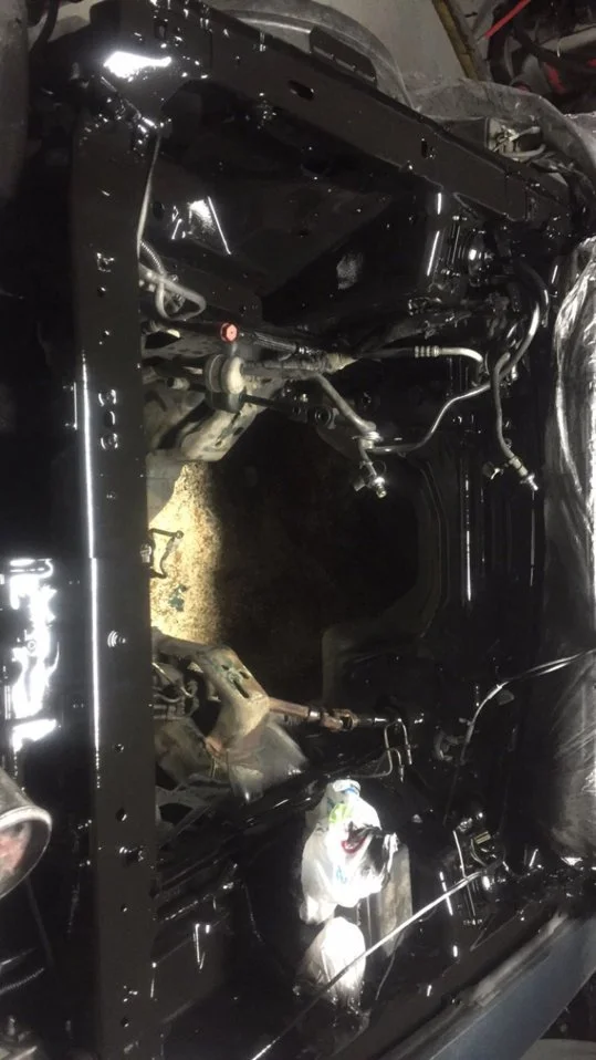

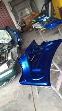

Well still waiting on the motor guy to get back to me. Went ahead and got some paint and did my door jams and stuff. Let me know what you guys think
