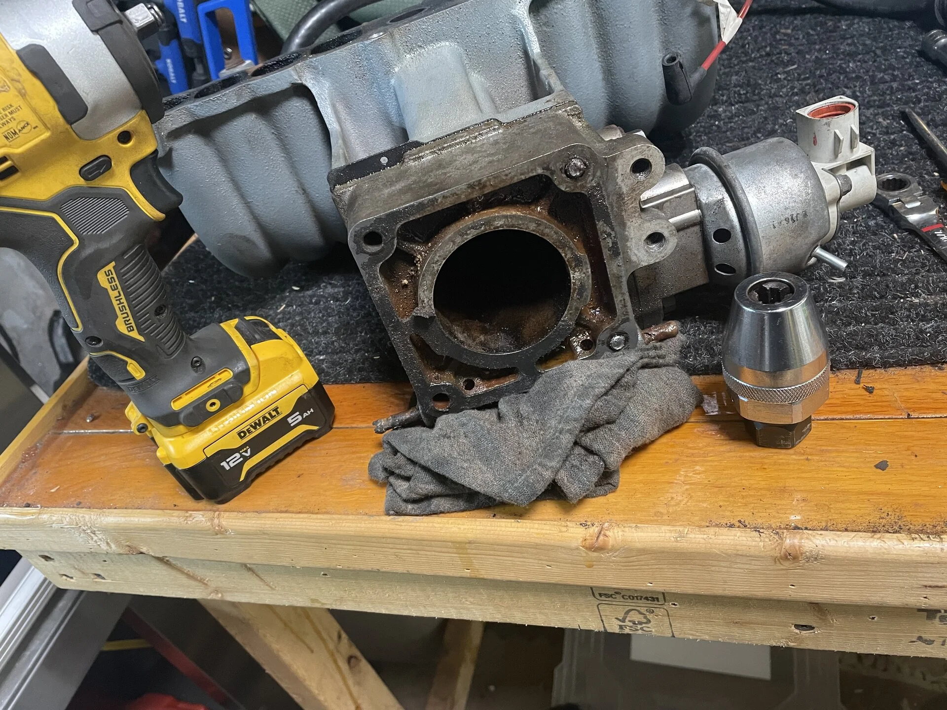

Anyone off-hand know the tap needed for the throttle body spacers? Mine are rather nasty.

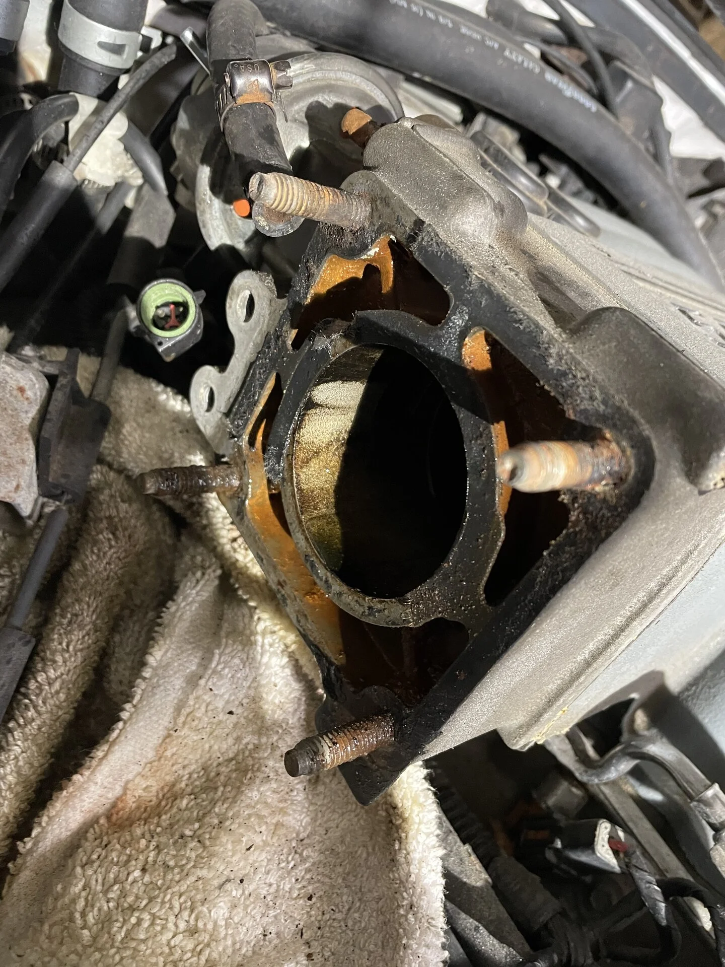

I’m thinking of trying to take out the studs. The egr spacer doesn’t seem to want to move.

Did my best. 2 for 2

Progress is progress

Brace the intake with the tb opening facing up, spray PBBlaster or equivalent on the studs that are left and the holes of the removed studs, also around the base of the egr spacer, let it set over night. Tap the spacer with a hammer a few times and spray again, tap, spray repeat a few times throughout the day, a good metal scraper tapped between the spacer and intake can help too.

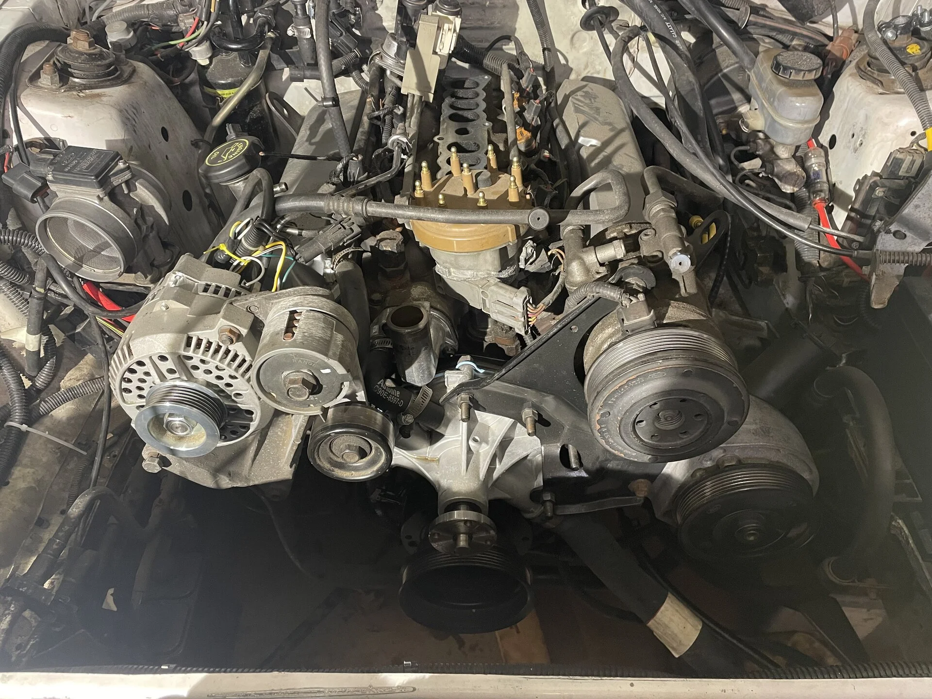

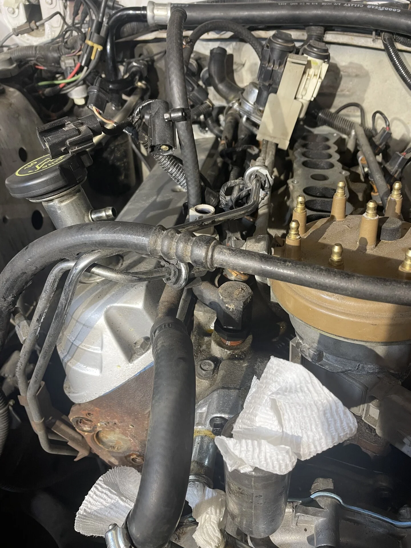

Is there a trick to removing the heater tube assembly? Specifically, this big guy:

Big crescent wrench on the skinny nut.
