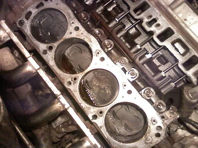

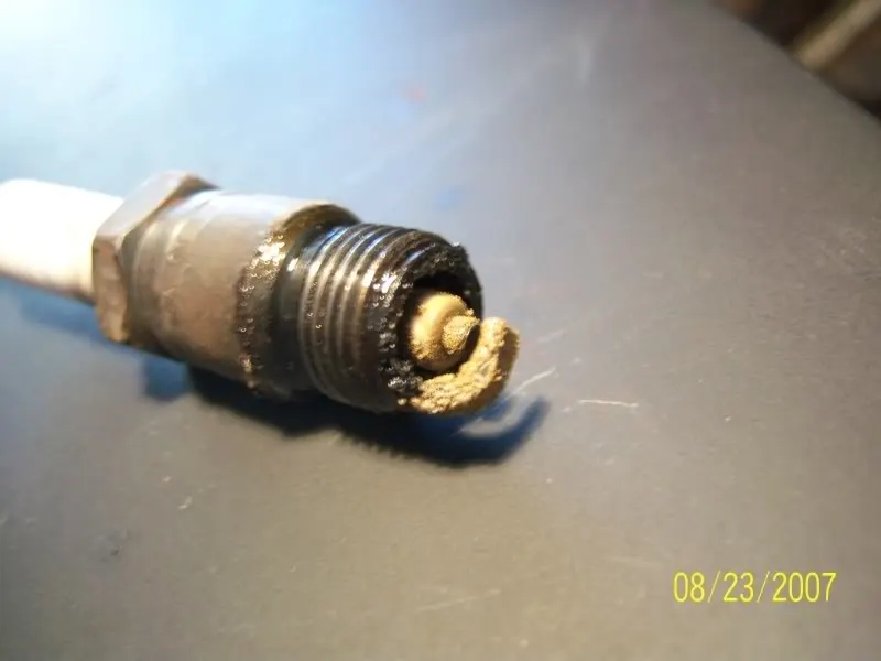

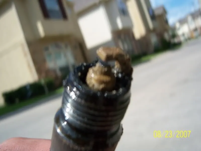

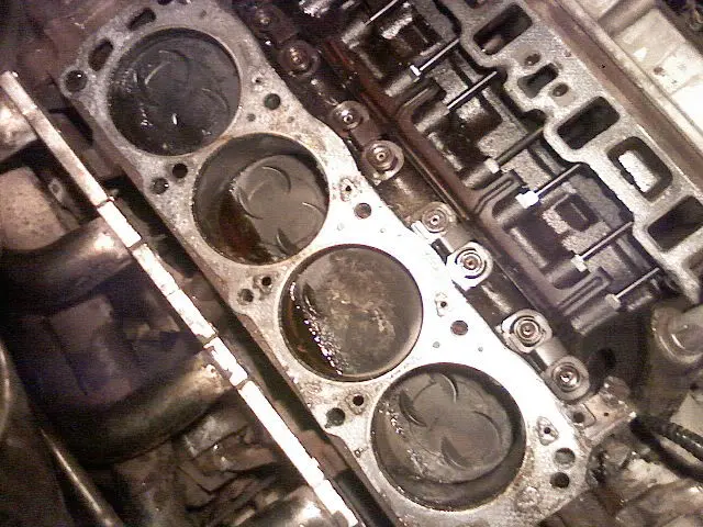

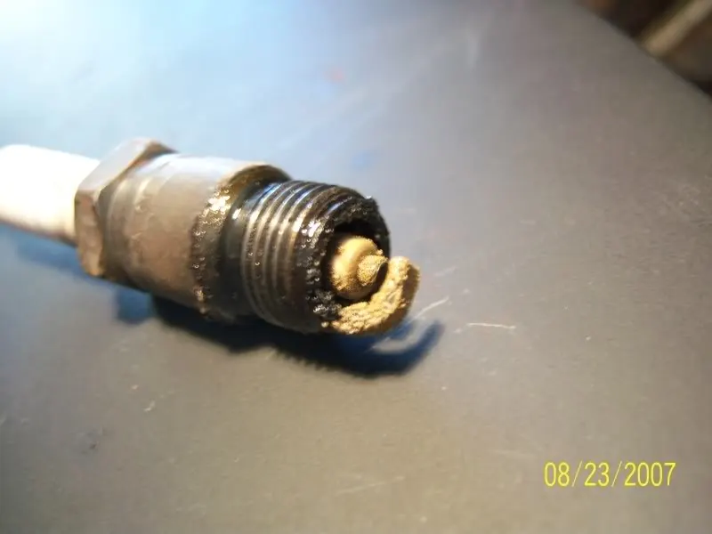

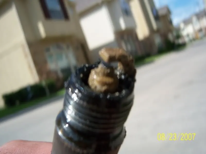

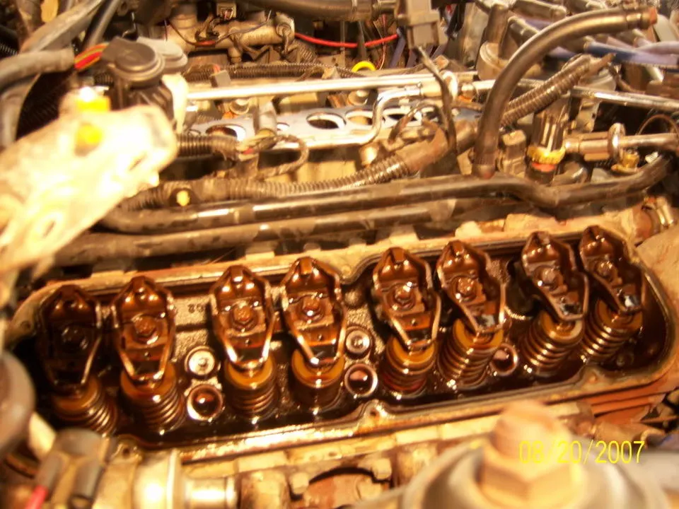

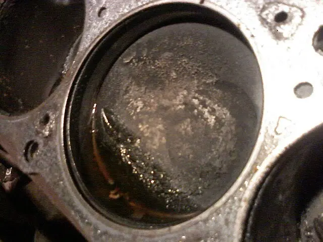

so i pull of the upper/lower and i dont see any cracks.. etc all the gaskets seem to be in great shape as well. The dipstick is fine.. no coolant in the oil. pull all the plugs and the only one that looked bad was the #2 cylinder here is a pic

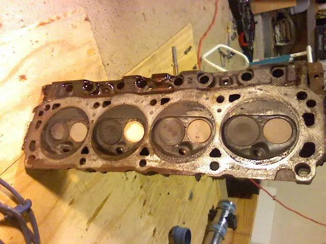

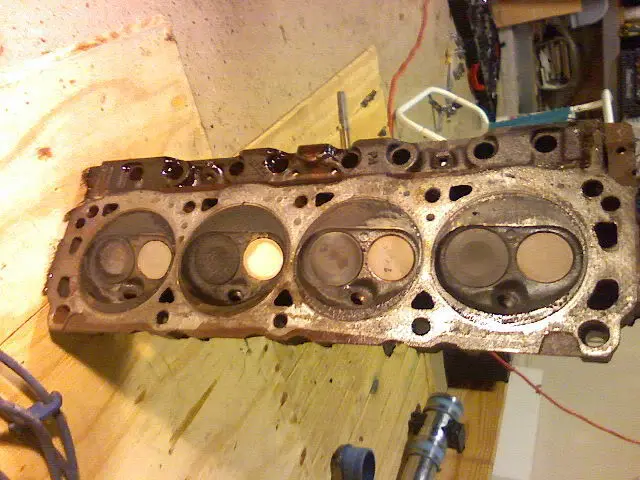

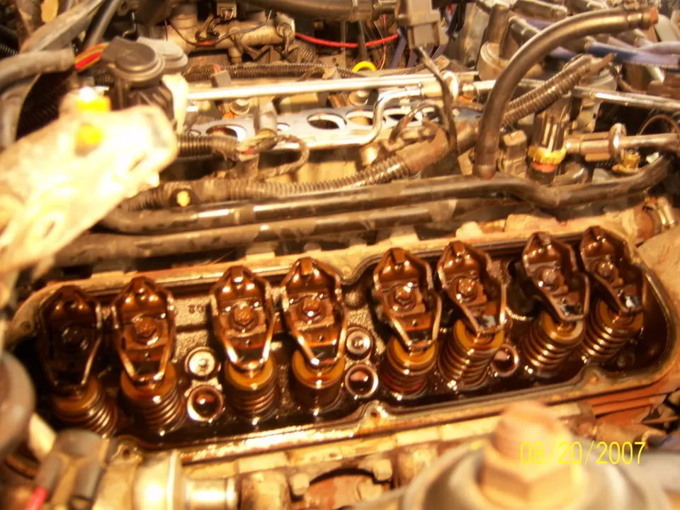

i pull the head and the headgaskets looked fine... the freeze plugs in the back of the head seem to in place and not leaking (which was where i thought it was blowin out coolant..). I think all the coolant in the cylinders was coming from the head as i took it off.

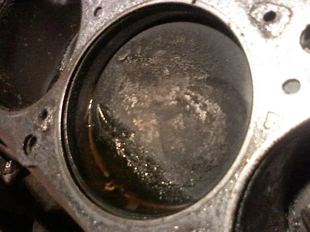

The number 2 cylinder looks dirtier/worse than the others.. wonder why.
So i am still wondering where i am billowing coolant from.. ??

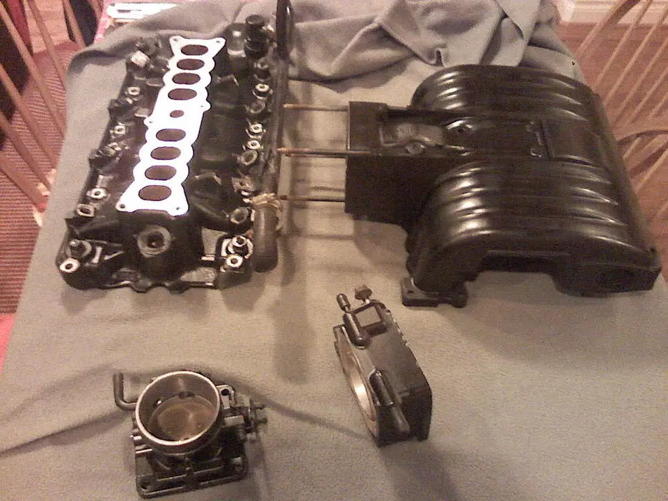

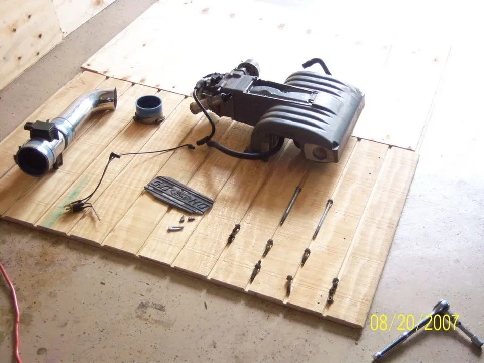

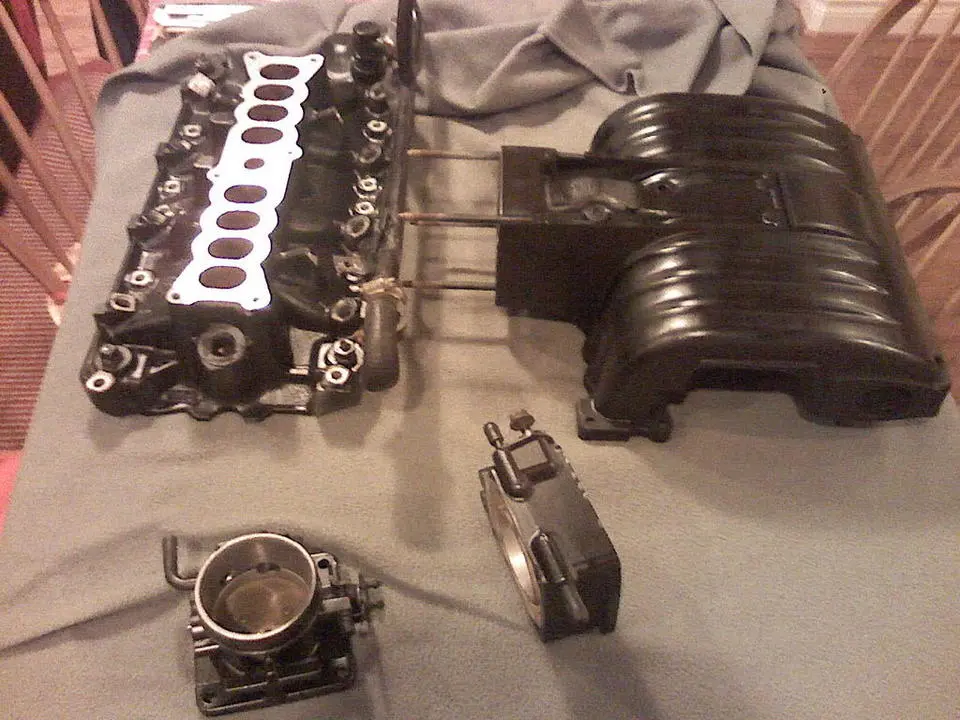

okay ive been keeping myself busy while waiting on parts by cleaning/painting stuff. Its not show quality but it looks a hell of a lot better than it did. I painted the upper/lower, tb, egr spacer, and both Valve covers black. It should look alot better when i put it back together.

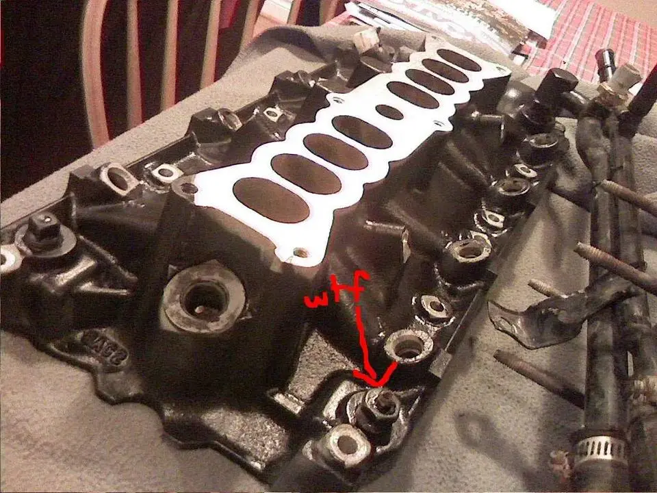

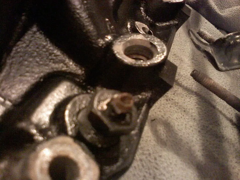

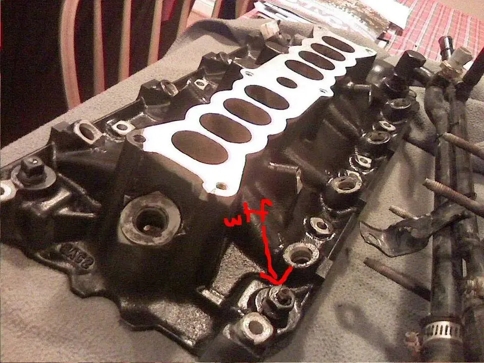

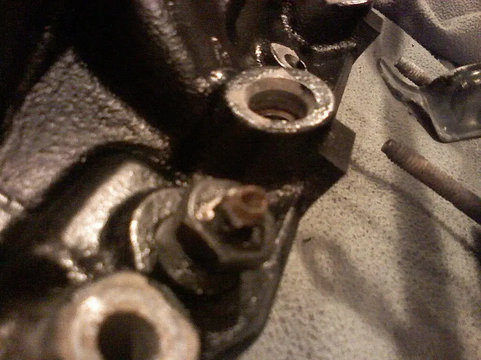

On to some important stuff. While painting my lower i noticed this bolt in the back that has a hole through the dome of it.. wtF? is this in one of the coolant passages? because if it is than thats where the coolant has been billowing out of. Someone clue me in on this plug..
sorry bout Shietty quality.. my phone is all i got

3. What should i use to clean the piston walls? There is some kind of deposits on the walls ( i think dryed up coolant or something..)

3. You can use the green spongy type dish scrub pad and some degreaser to clean up the carbon ring at the top of the cylinders. If you are pulling the whole motor apart you may want to use a ridge reamer and maybe a quick hone.

AHA! That used to be the nipple for one of your EGR spacer coolant lines. It apparently has rotted apart and all that is left is the pipe-threaded portion. You can either replace it with a new nipple (get one at any NAPA or Autozone), or just block it off with a pipe plug and then cap the other outlet end on the heater pipe - same cost either way (less than $5 for a fitting).
Don't know why it would result in chocolate milk or foul the plug - you likely have something else going on with that, maybe the head gasket - but that fitting certainly will spew a bunch of crap underhood when it turns loose. When I first bypassed my EGR spacer coolant lines, I tried capping that with a rubber vacuum cap and a hose clamp; the cap apparently couldn't handle the pressure and split one day when I was doing the same thing (romping on it from 1st through 3rd) and it started spewing a little geyser of green terror all over everything under there.
thanks for the input. come to think of it there was a capped off line coming from there and i always wondered what it was... it is no longer there obviously. thats why stuff was spewing everywhere :bang:

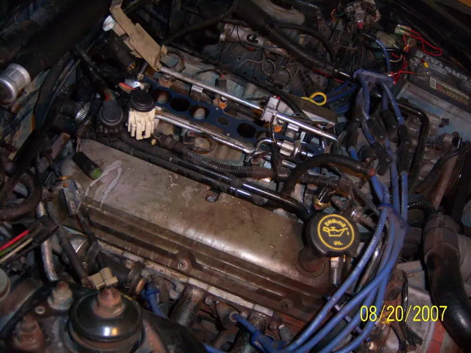

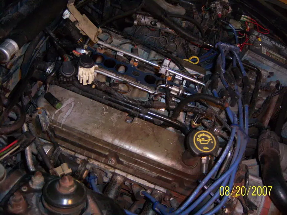

got a lot done this weekend.. heads are back on the car, valve covers are on, lower intake, the wiring harness, fuel rails/injectors and put in the new Kirban AFPR. Bolted the headers up, and put on the AC & Powersteering pump. All i got left is to bolt the H pipe back on, put on the alternator, and the upper. i cant wait to get her running. I also got an ashcroft Fuel Pressure gauge but its a male to male connection and it looks smaller on the fuel rail side too. Anyone know where i can get an adapter?
