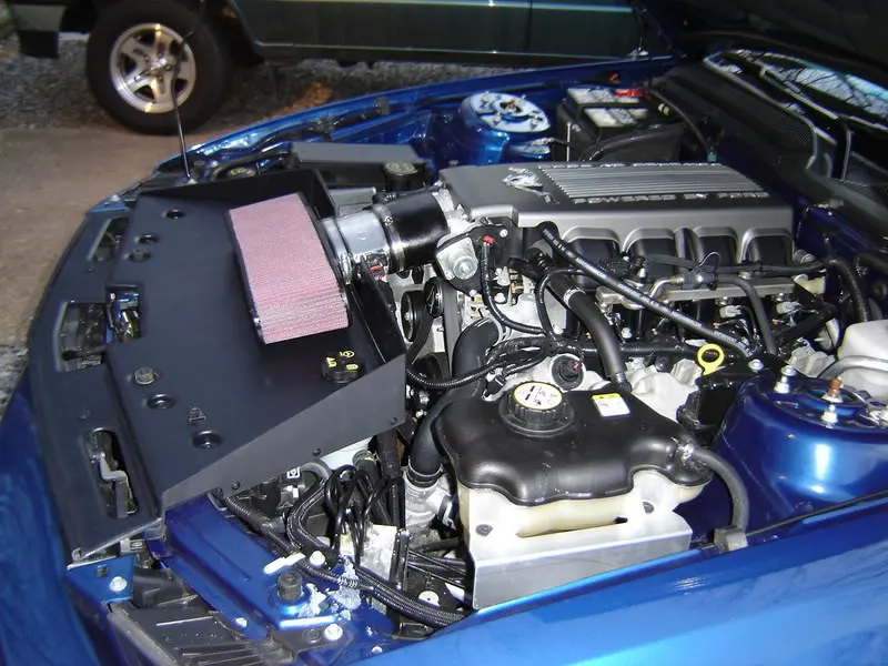

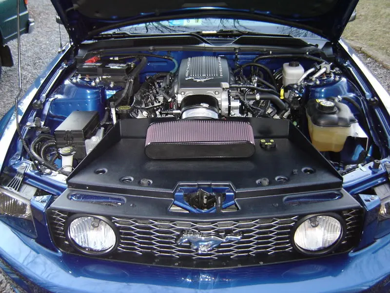

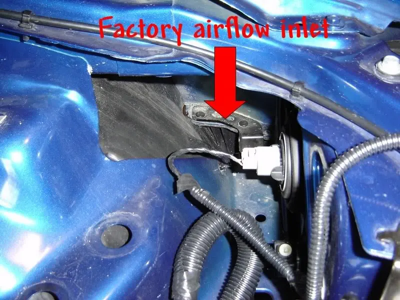

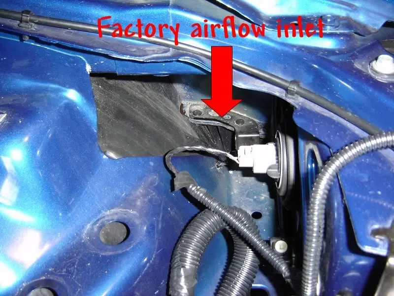

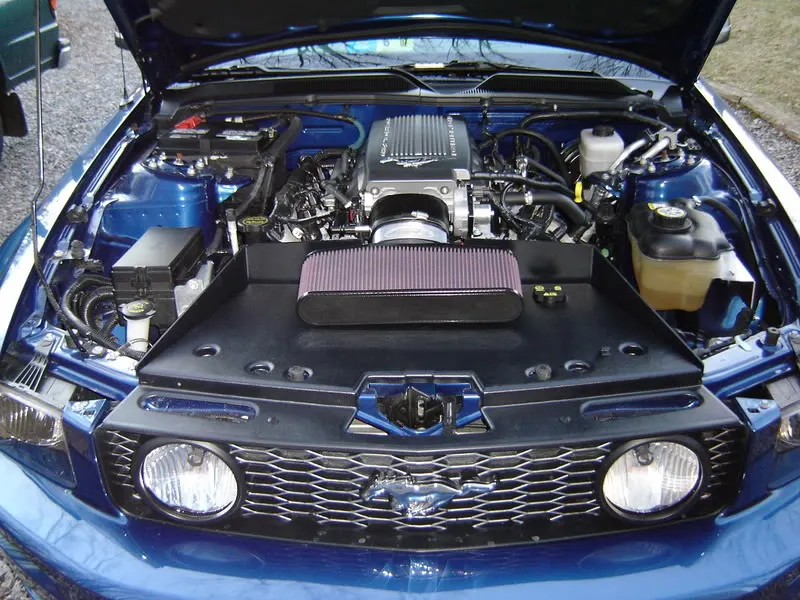

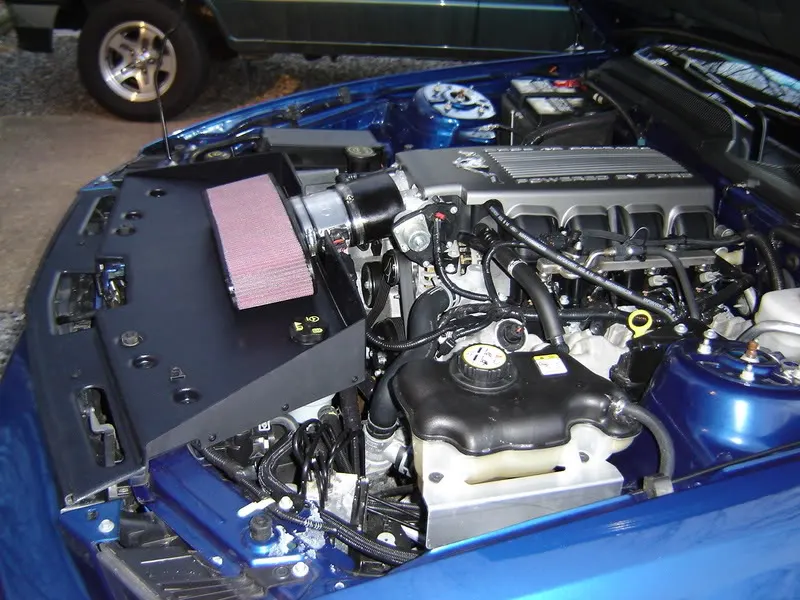

It's been mentioned several times in different threads, but even the stock airbox is indeed a cold air intake. It's not a great one by performance standards, but does it's intended job very well. It does get cooler air from outside the car via the front fender, although that is VERY restrictive(I will post a pic of that restrictive air inlet). One of the reasons I chose the WMS w/ram air tray was the fact that it gets its air flow through the grill openings and up through the 3 large holes cut in the radiator cover(also a pic posted to show these). I briefly thought about getting a hood with scoops to greatly intensify the shot of air to the filter, but I care more for a cowl hood. I will get the Cervini grill to replace the stock one(that will let in a bunch more air).
