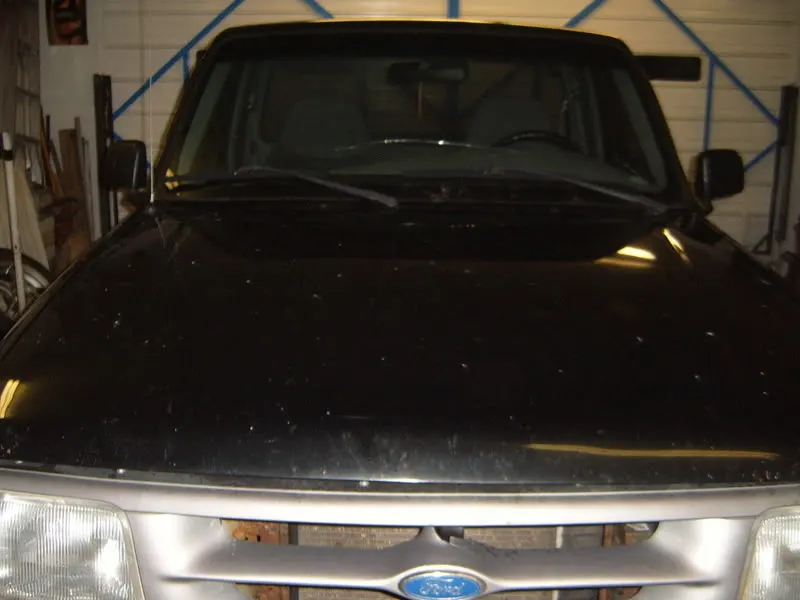

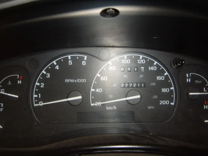

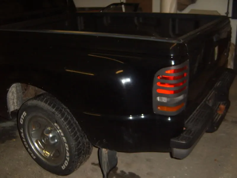

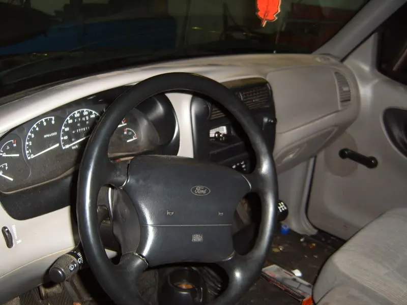

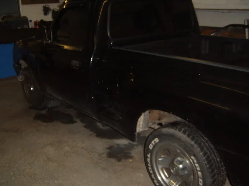

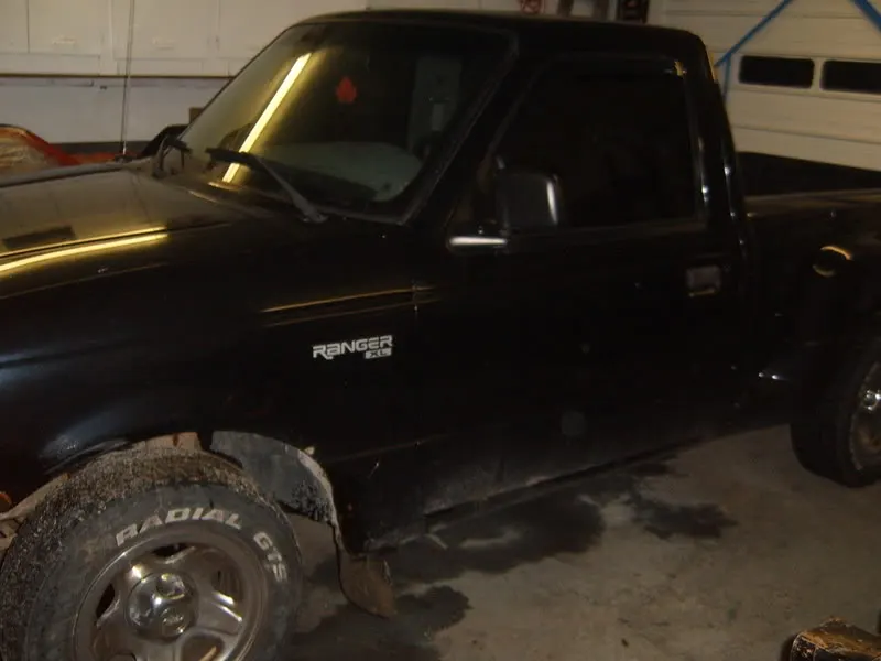

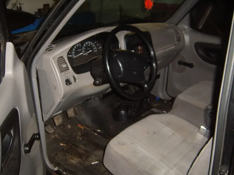

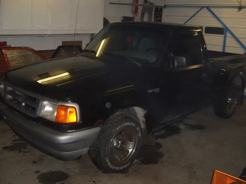

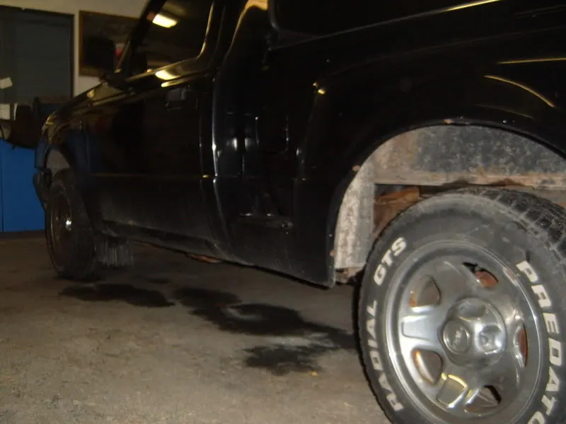

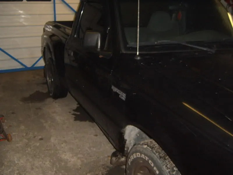

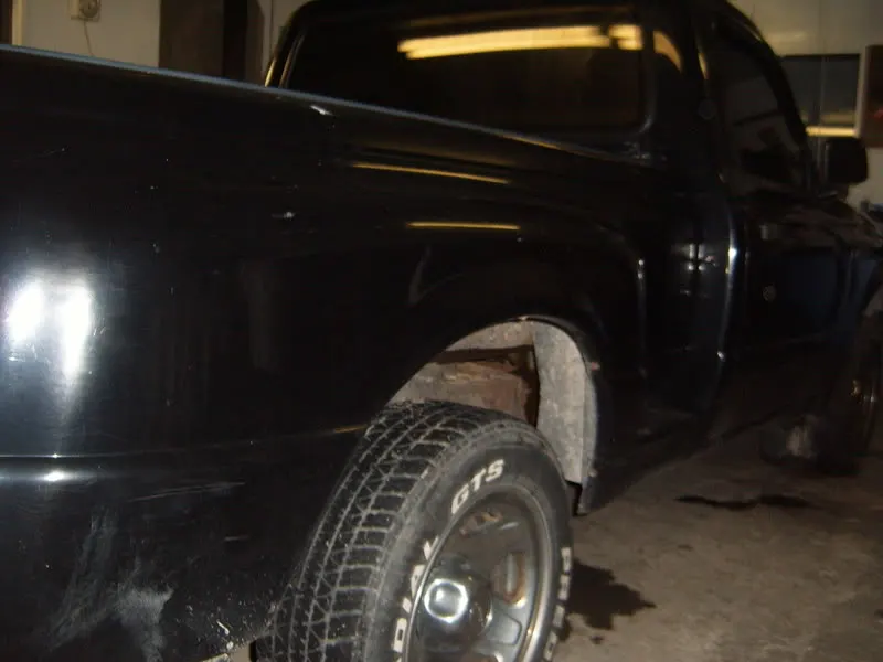

needs a little cleaning and pretty much needs an engine...replacing it with another 3.0L or maby a 5.0L H.O. I have like a year and a bit to have it on the road before school for my apprenticeship so I may do a 302 swap but we will see what happens. And I might get the father to help me repaint it black again

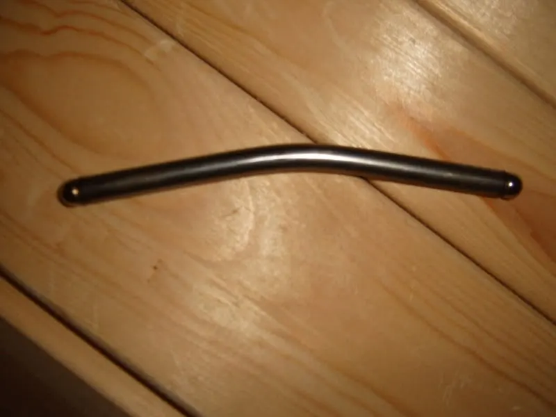

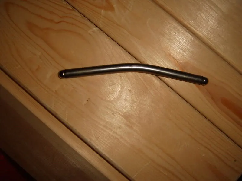

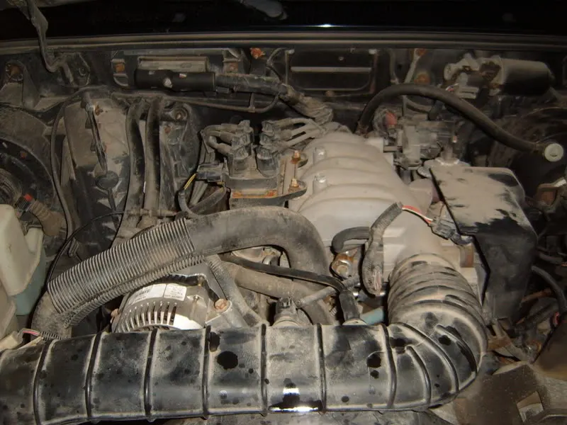

so when I did a compression test at work cyl's 3 and 6 had no compression and tonight I was looking for something to kill a few minutes time so...
so tonight I was borred so I went to my parents house (where the truck is in the shop)and I took the passenger side valve cover off and seen that #3 cyl exhaust rocker was loose. then I seen the push rod sitting down in the hole so I pulled it out with a magnet (with the rocker still in place) and it was bent probly at a 135 deg angle...then I got loking a little closer and the valve spring is compressed almost all the way so I assume the valve is bent. I didn't pull the other cover off cause it looked like a pain and I was in a hurry. I would think the same thing is going on with cyl #6 cause they both had no compression. now what may have caused this I was leaning towards the timing jumped?. Are they belt or chain. I think i am going to pull the heads off and see what I can do to fix it...or maby buy another 3.0L and maby re gasket it and freshin it up a little.
are the heads off say a 3.0 taurus or any ford/merc FWD 3.0 car the same heads. any help or sugustions are welcome.
I might pull the driverside cover off and see what went wrong there probly the same thing I immagine. But here is cyl #3 exhaust valve pushrod...my new drinking straw :rlaugh:
