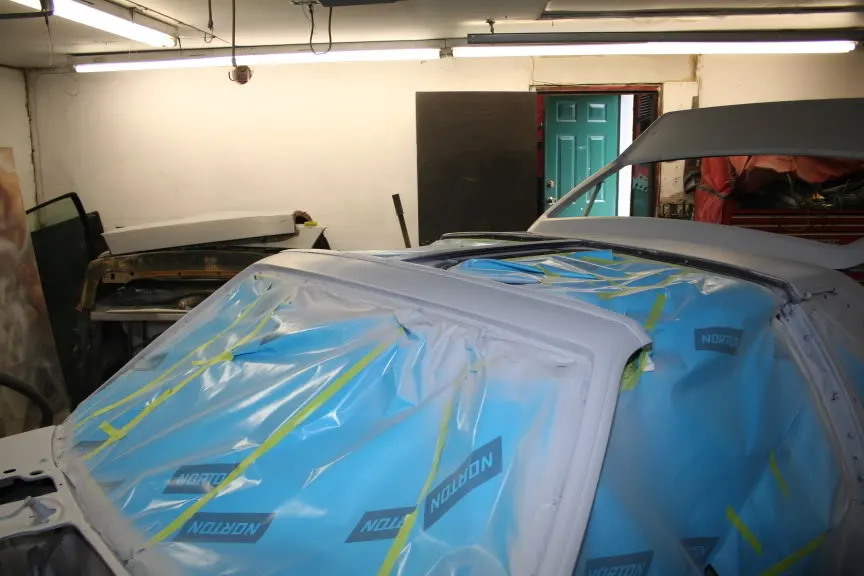

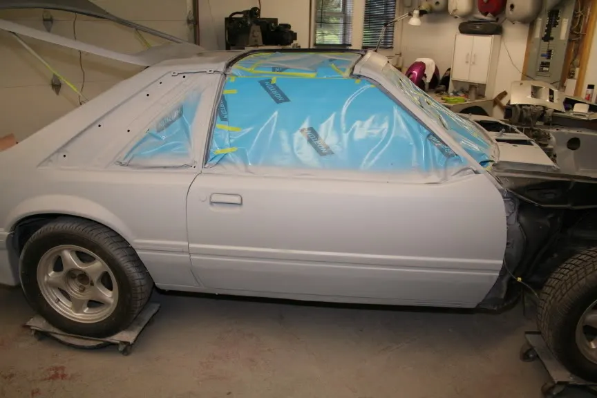

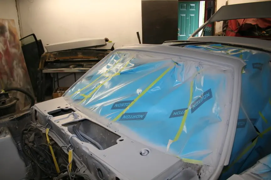

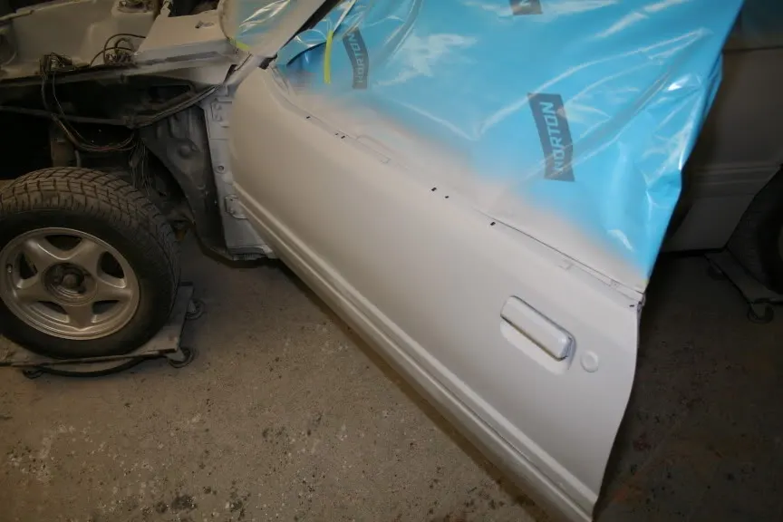

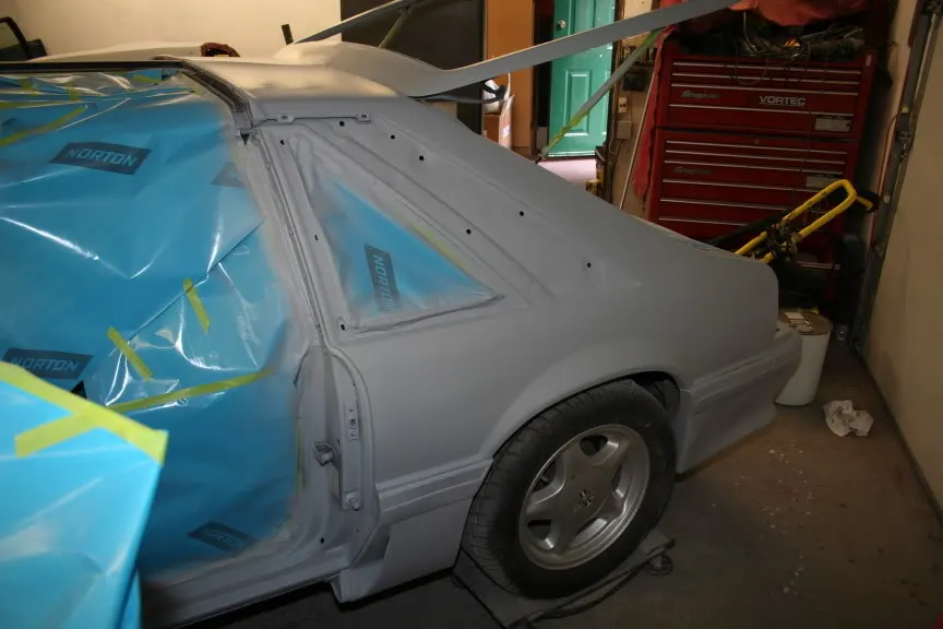

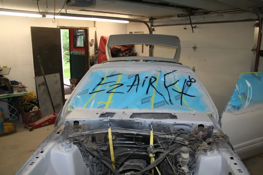

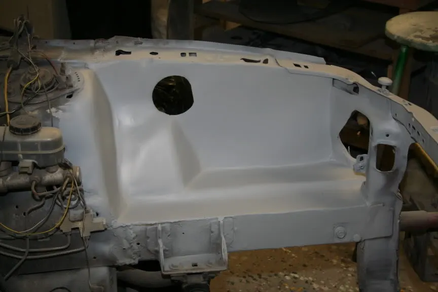

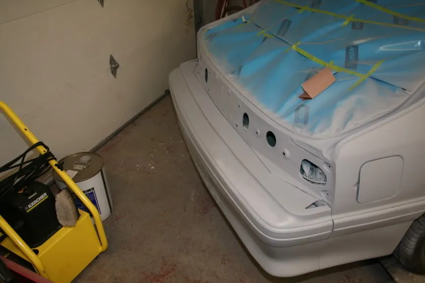

Well another 14 or so hours on it today, and my painter is about ready to shoot himself :D
Car is primed, will do the ground FX and wing hood etc tomorrow, and then sand putty, and prime again untill he is satisfied with it, then starts the color :D

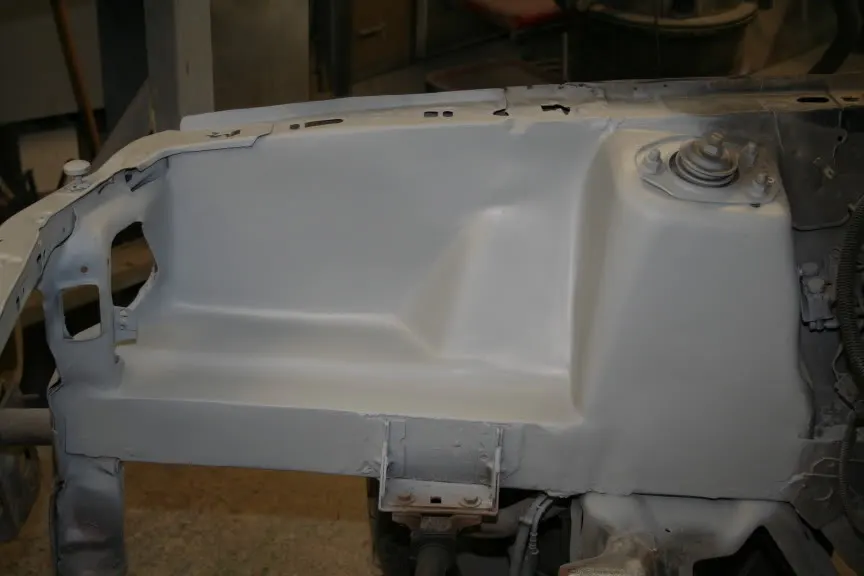

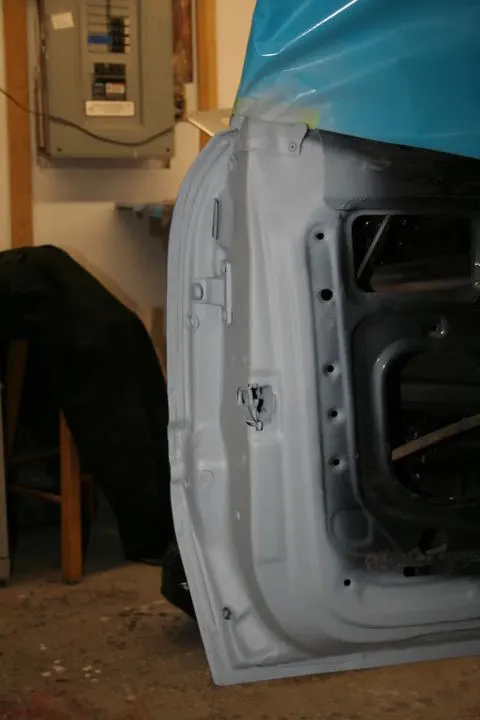

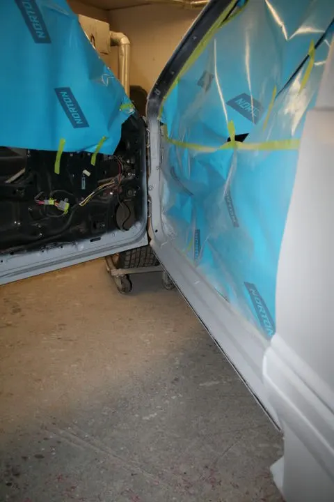

Some more for anyone who is following along. Now that we have the primer we can see the high and low spots and start getting everything 100% :D

jpctln said:
Looks good, but I noticed that one of the fender aprons is still a little crooked. Do you plan on fixing that?
Yeah we have some high and low spots to still finish, and it is eaiser to see with the primer on it now. We have them marked out in marker with X's now, and will put some fill to make them all level.

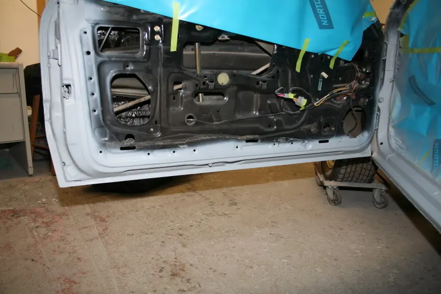

Looks nice, but a couple of critical comments, and I dont want to come off like a jerk or anything,
its appearant that you have put a lot of work into the car. My question is if you are going to remove
all the door trim, locks, handles, door latch, strikers, all the stuff that you have painted over with primer?
You could get a much more complete paint job if you removed all that stuff so the paint is complete under
everything. Even behind the rear bumper and the gas filler cap. Im sure it will look great either way, but
youve gotten this far, dont cut corners, those will be the things that people will notice and pick at about
it when its done. Just a suggestion, again, not trying to come across the wrong way, but it wouldnt take
much more work to do all of it right.

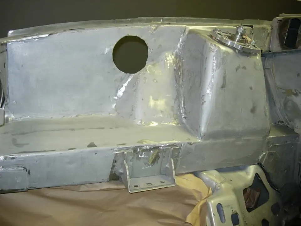

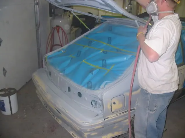

Heres mine getting ready for primer/paint. Strip everything down.
The finished product
