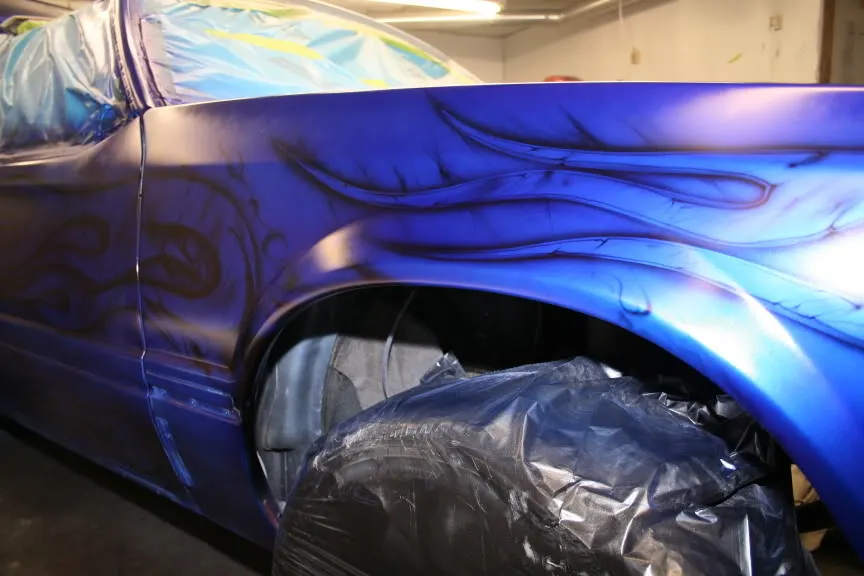

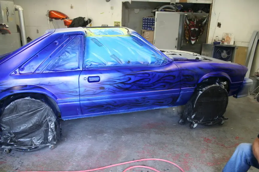

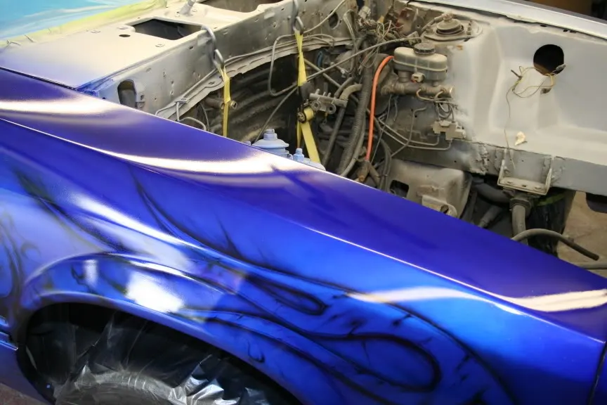

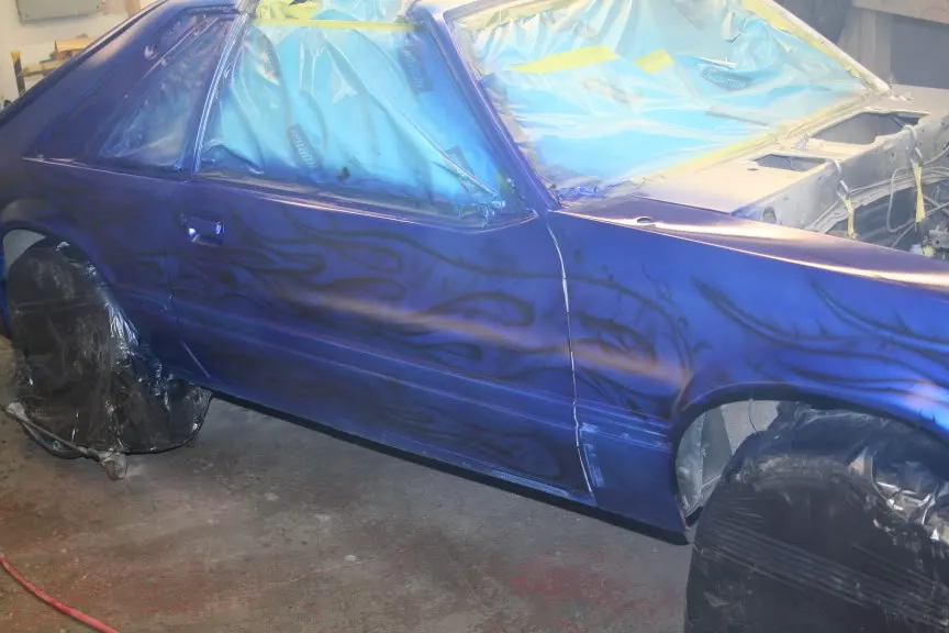

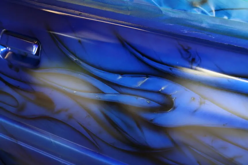

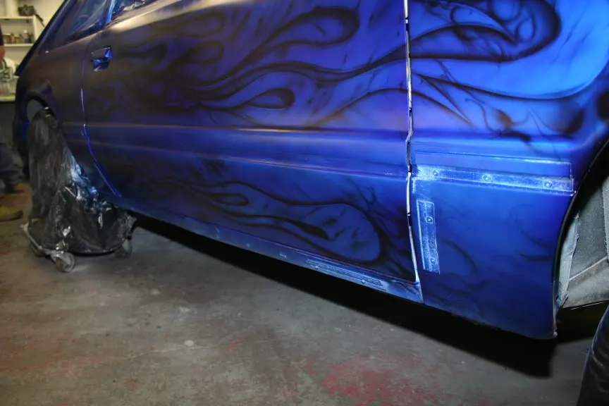

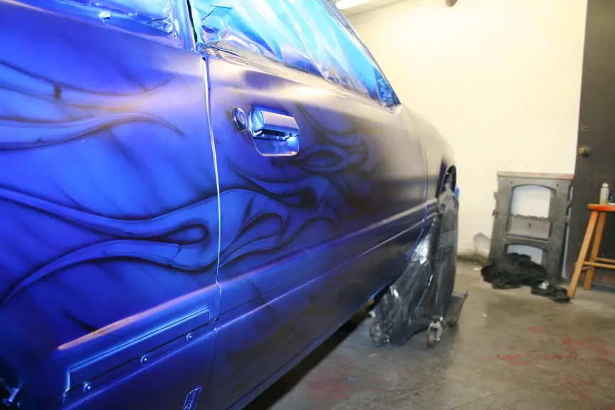

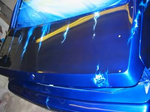

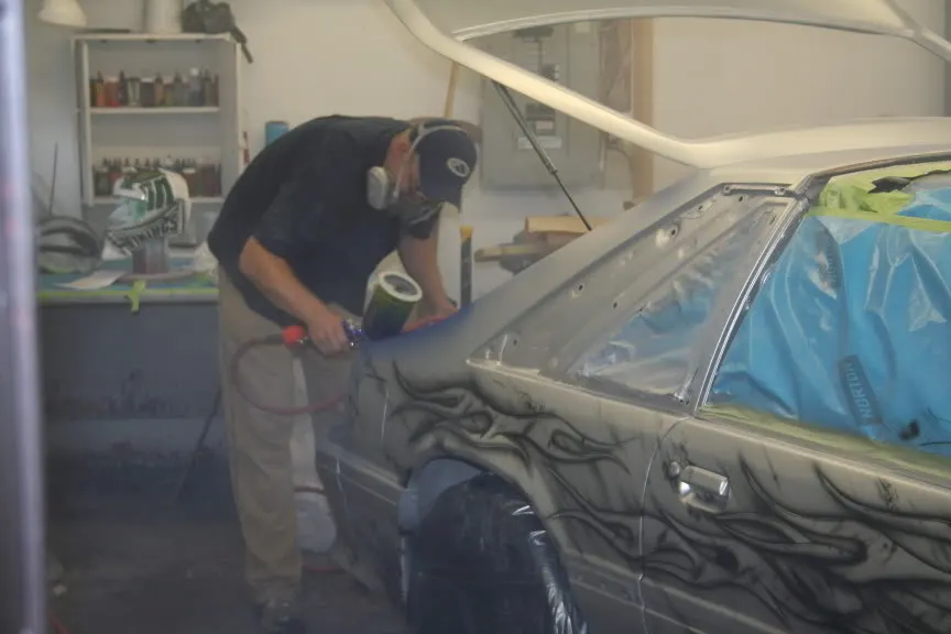

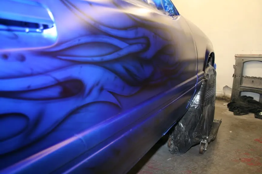

First Stage of Candy went on today, followed by adding in some white on top more candy to cover it more art. Ways to go yet but getting there.

Man, this is looking good. Real good, but I have two questions for you. First, what about the inner door and the other panels. This looks like a big money job and even though I understand the need for continuity in the graphics, why do you still have the doors and fenders attatched to the car?

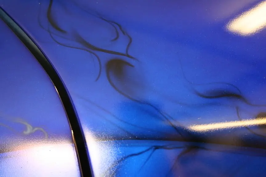

Second, When it comes to candy paint and graphics, do you still have to worry about the "orange peel"? will there be any wet sanding invlolved in this? Just curious because I love a good paint job. Great Work and keep it up. :nice:

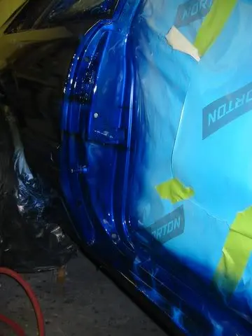

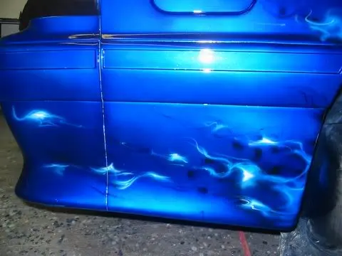

Door jambs will have the art design continued into them as well. The front clip and fenders will be being removed again once he is happy with the blend of the color. The dye candy is in a holding clear, so it can be wet sanded and buffed just like a regualr clear, but leaves him a window of time that he can still do art work before he has to sand and prep for the paint to adhere. I actually gave him a picture of Tunedin302's car for the kind of shine I wanted, and he assured me that will not be an issue to do. Lots of wet sanding and buffing, but he said he will make it shine the same way. (If he even comes half ways close I will be happy as hell. Since his car has one sick shine to it)
All said and done should be 9 coats of clear wet sanded in between each one to give it a very deep shine.

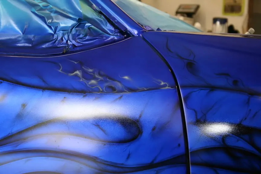

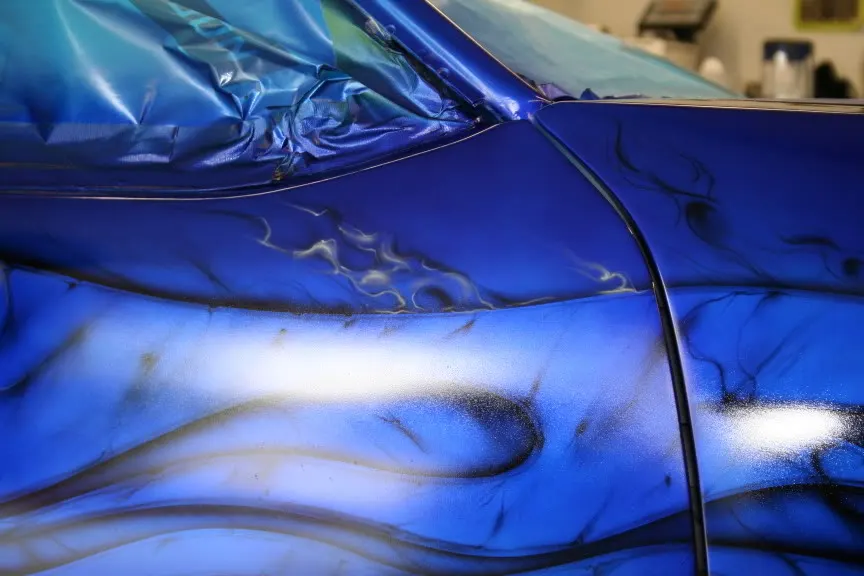

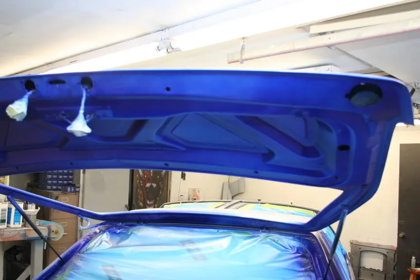

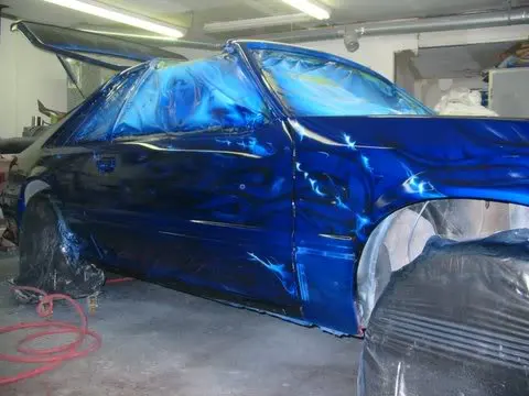

Few more pics took the fenders and stuff back off and painted all door jambs. Re-assembled and did some more art work.

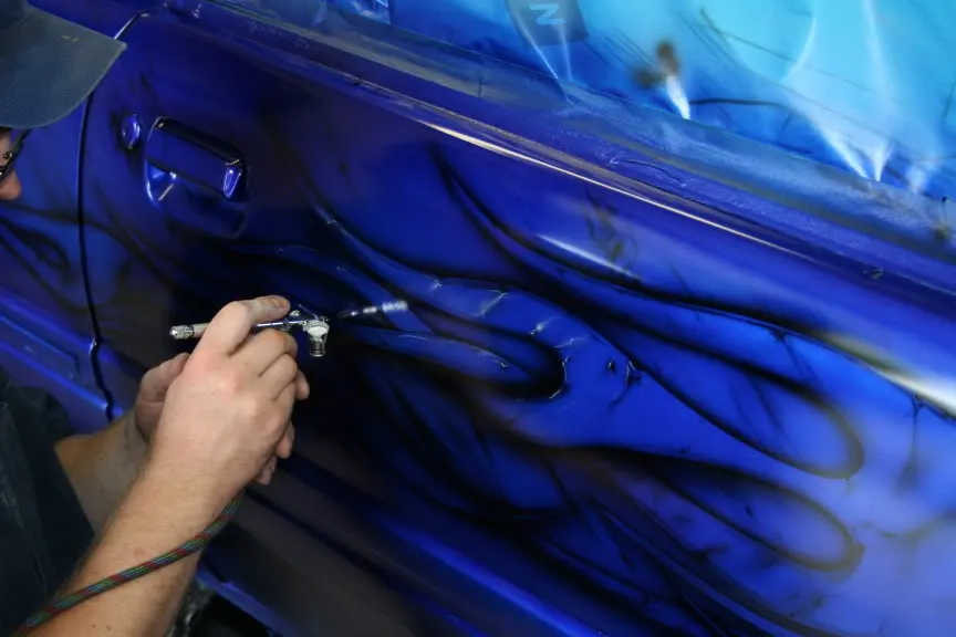

All paint and art work was/is being done by www.ezairfx.com

The design comes from the Owner and artist Heath Morrell of Ez Airbrushing Fx
The guy has talent, and ideas coming out his @$$ and his past work, and just all around awesome guy to work with made me go with him. Best artist in Eastern Canada IMO.
His Site address is in my sig, he has done some awesome bikes and has tons of awards to back up his work.
