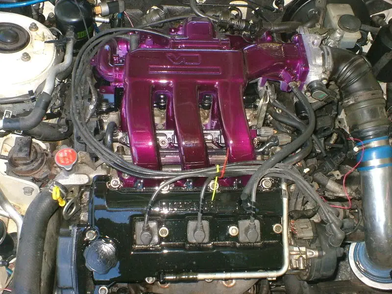

Thanks for the info!!! alright im bidding on some 24lbers and a lightning maf... LOL... what cars can i pull the 24's from if needed... ive heard cobras, some trucks, markVIII, and even someone said a ford probe... but certian connectors dont fit... can someone tell me what fits and what doesent..
http://forums.stangnet.com/attachment.php?attachmentid=44598&d=1147531571
I found taht but does the does not fit apply to the cobra... or explorer....
I cant rember what size the probe was.... BUt i think the mazda melinia S had 24lbers... i cant really see in this pic... its the only thing i have that you can really see the rails..
I can't really help you as far as which ones are interchangeable....but I can tell you this:
My 24# injectors look like the stock mustang...but with a light blue top instead of the orange.
Also (not 100% sure here), I believe you need a pigtail for that LMAF to work on our cars.
hopefully someone else can confirm
EDIT: heh, I guess Chaos posted right before me....guess the pigtail is confirmed now.
