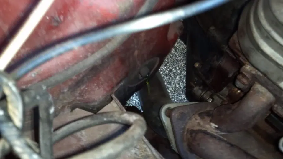

So i got back from my lunch break a bit early today, so i parked my car, and started smoking a cigerette. As i was sitting there, listening to the noises outside, i hear a hiss, every so often, almost like someone was slowly dripping drops of water on a hot skillet...
so i look under my car, and dont see anything thats leaked on the ground, so i take a look under the hood - and i see a partial hose coming from the firewall that is slowly dripping coolent onto my hot exhaust pipe! :jaw:
So i took a pic, i think it is somthing that is supposed to connect to somthing that has to do with my heater core - or is it safe to clog up? I havent needed to turn my heater on in my car here due to the weather, but i dont want to turn on the heat and have it blast coolent out of this hose (if that was it is connected to)
Does this mean my heater core is going out? or do i just need to plug the hose and call it a day?

should that hose be open like that, just sticking out the fire wall?
Yea, i know they are not fun to fix, but i can live without one, as this is my summer car (have another to drive in rain/snow)
Will leaving the heater off and that hose hang open hurt anything? Im figuring if i plug it, that coolent will just find some other place to leak out (like inside the car)
Don't plug it, it is there for condensation to drain from the ac evaporator. your leak looks green like anti freeze so its gotta be the heater core. If you don't fix it you will want to by pass it under the hood so you don't keep losing coolant.

It seems a little heat/AC 101 is in order here.
The heater core and the ac evaporator core are both located in the black plastic box under the dash.
The hose you see sticking out from the firewall is not supposed to be connected to anything, it's simply a drain tube coming from the heater box that allows normal condensation that forms on the evaporator when running the ac to drain out onto the ground.
Even if you don't have the dash controls set to ac there can still be condensation because the ac is designed to cycle on and off when you have the control set to defrost.
If the heater core is leaking, the fluid will not be water coming out of the drain tube, it will be coolant.
Even if you don't have the dash controls set for heat, there is still coolant flowing through the heater core at all times while the engine is running... so not running your heat will NOT keep the heater core from leaking.
If it's determined the heater core is leaking and you chose to bypass it until it can be replaced, the correct way to do it to disconnect both heater hoses at the firewall pipes and use a short plastic or metal pipe to connect the two ends together so the coolant path is not obstructed.
Be aware when removing the heater hoses for any reason that there is a small metal restictor that looks like a bushing installed in the inlet hose. Don't lose this and always reinstall it when replacing the heater hoses. This restictor does NOT reduce the pressure of the coolant entering the heater core like many people think, it simply slows the movement of the coolant through the heater core so there is time for heat exchange from the coolant to the air passing over the fins of the core.

Hope all this information has helped you understand the heat/ac system... but in the end, you're going to have no choice but to eventually pull the dash and replace the heater core to fix your car properly.
yea, the liquid coming out is definatly green, not condensation - so im 100% sure it is the heater core -
So to bypass, the hoses you are speaking of are the ones that come from the firewall and go into tubes attached to the rail on my lower intake manifold?

Yep, that's definitely coolant from the heater core. (it's green)
Bypass it for now, and later on you can remove the HVAC system behind the dash and remove the heater tube from the intake manifold. (if you really have no intentions of using the HVAC system in the future)
