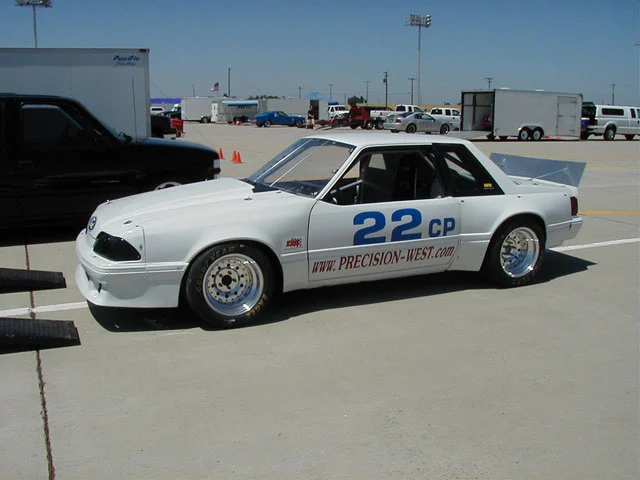

Good luck with that, I've always wanted something like that as well. People suggest the asc spoiler to me but I can't stand that thing. I've also thought about modding a Monte spoiler, or trying to copy this Griggs spoiler that they made for a short time (only I don't like how it's mounted to the decklid):

Anymore pics of that? Is there a way to get one anymore?
That's the only pic I have, I saved it from the Corral. The owner goes by Brutal04 there. He's posted other pics there in different posts. The spoiler was discontinued a while ago, and I've heard they didn't make very many when they were selling them. They may be pretty hard to find.
That's exactly the kind of spoiler I'm talking about! Nicely subtle, doesn't stick out like a sore thumb (as opposed to the huge Saleen whale tail or other such nonsense). I would look for a Grand National spoiler, but any little piece of anything off of those cars is highly sought after because they're like gold to the GM folks. Probably better off looking for a Monte Carlo SS spoiler, since it's essentially the exact same car.

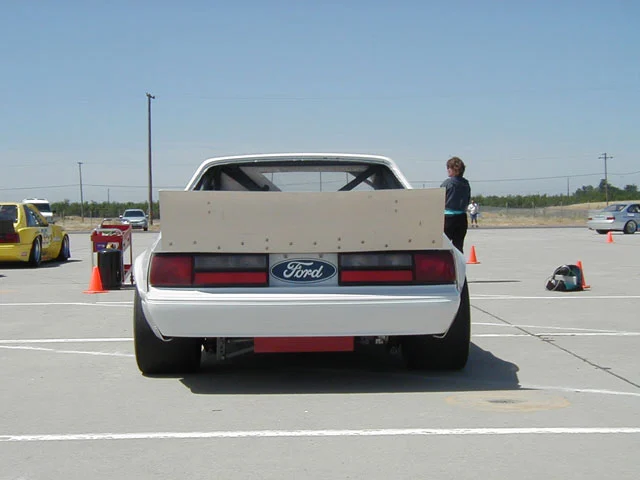

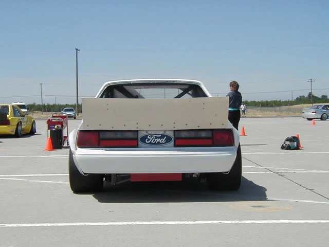

WING-ING-ING-ING-ING!!!
Really, this is pretty ghey looking but, it is a racecar....if you can run faster on a road course without it, i'd like to see it :D
By the way, most that you see like this (smaller though) are just home made...so if you want one that's really low key and simple, you might have to go that route.

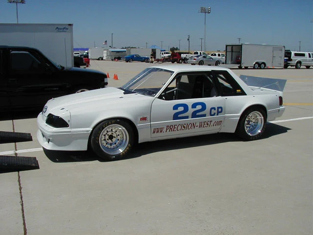

I really like that first wing alot on that blue car. I have a silver notch that I was thinking of getting someone to customize a 03/04 cobra wing for. I dont like anything very big though because I like the body lines of the notch. Something that just goes off the body a bit. I also have thought about a front spoiler on the front of the notch like an old boss style would look good.

I wonder how the spoiler on that blue notch is held on? I don't see anything above or below it for a mounting base of any sort - it almost looks like it's somehow molded onto the trunk, itself, like it's welded or otherwise fused.

If you look closely at the first pic you can see that it's just one piece bent at an angle (could be two pieces welded together, not sure). You can see the hole around the trunk lock and the rivets/screws holding it on to the edge of the trunk lid. That's the only thing I don't like about it, but if I found one I could live with it.:D
