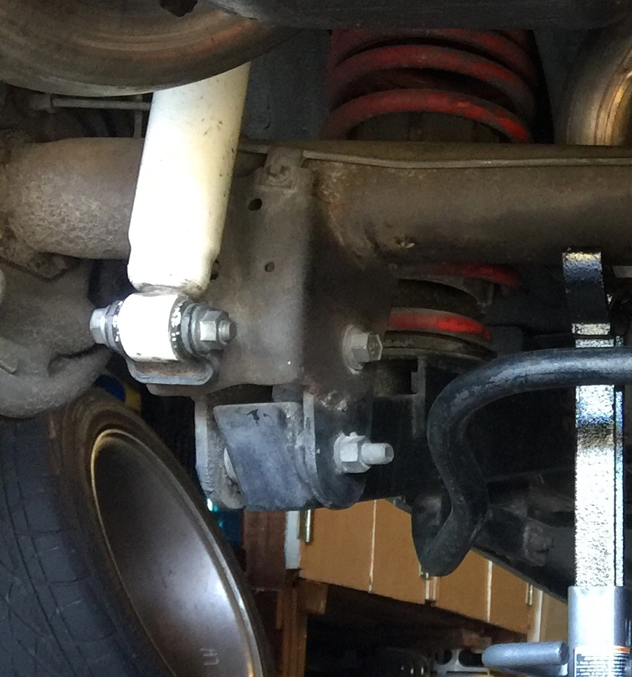

i plan on taking them off, but wanted to be clear if i needed to grind off the section that appears to lower the axle end of the lower control arm mounting point.
Looks welded, and i dont think i can leave it on if i go MM
I think they were always welded, at least all the ones I've seen.
I couldn't remember if the brackets were on the inside or outside and your pic answers that.
Looks like you are grinding. It really shouldn't be that hard the only spots they could probably reach with the welder was on the bottom left and right and maybe the front.
With a couple good grinding discs it should only take a couple minutes.
