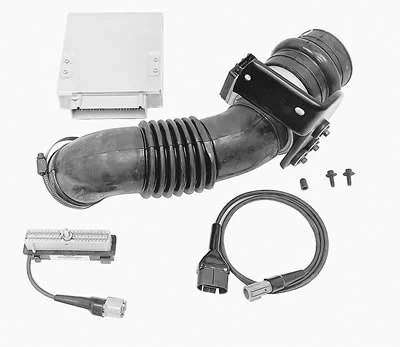

Ford Racing has an SD to MAF kit but it's $550.00. I don't want to spend that kind of money right now (or ever if I can avoid it).
I just want that pigtail for the MAF sensor and the plug for the back of the computer. Everything else I can find in the salvage yard.

I was just going to post and tell you about FRPP's Mass Air conversion and warn you that the price is prohibitive. Don't waste time and money on the Crown Vic system. Get all the parts you need off of an actual mass air Mustang and you will probably save money. You can get a Pro-M Bullet mass air meter fro under $200 these days and I would recommend that unit over stock. The entire wiring system out of the salvage yard inlcuding the computer and injectors should be under $500 depending upon where you get them. Mass air cars are hard to find in the salvage yards so you minth have to pay a decent amount and get them from a Mustang specific salvage yard. I can get them from a friend but I'm pretty sure the harnesses and computer will run right around $400. I can ask if you like.
