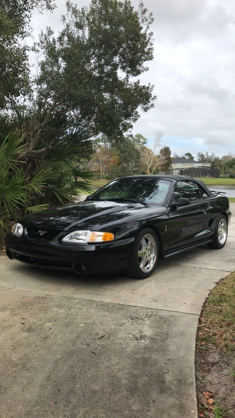

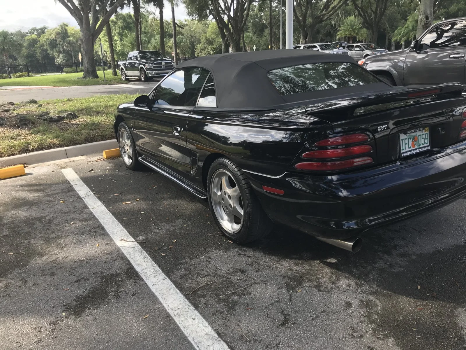

Vin is the best method as stated. Other cues to look for:

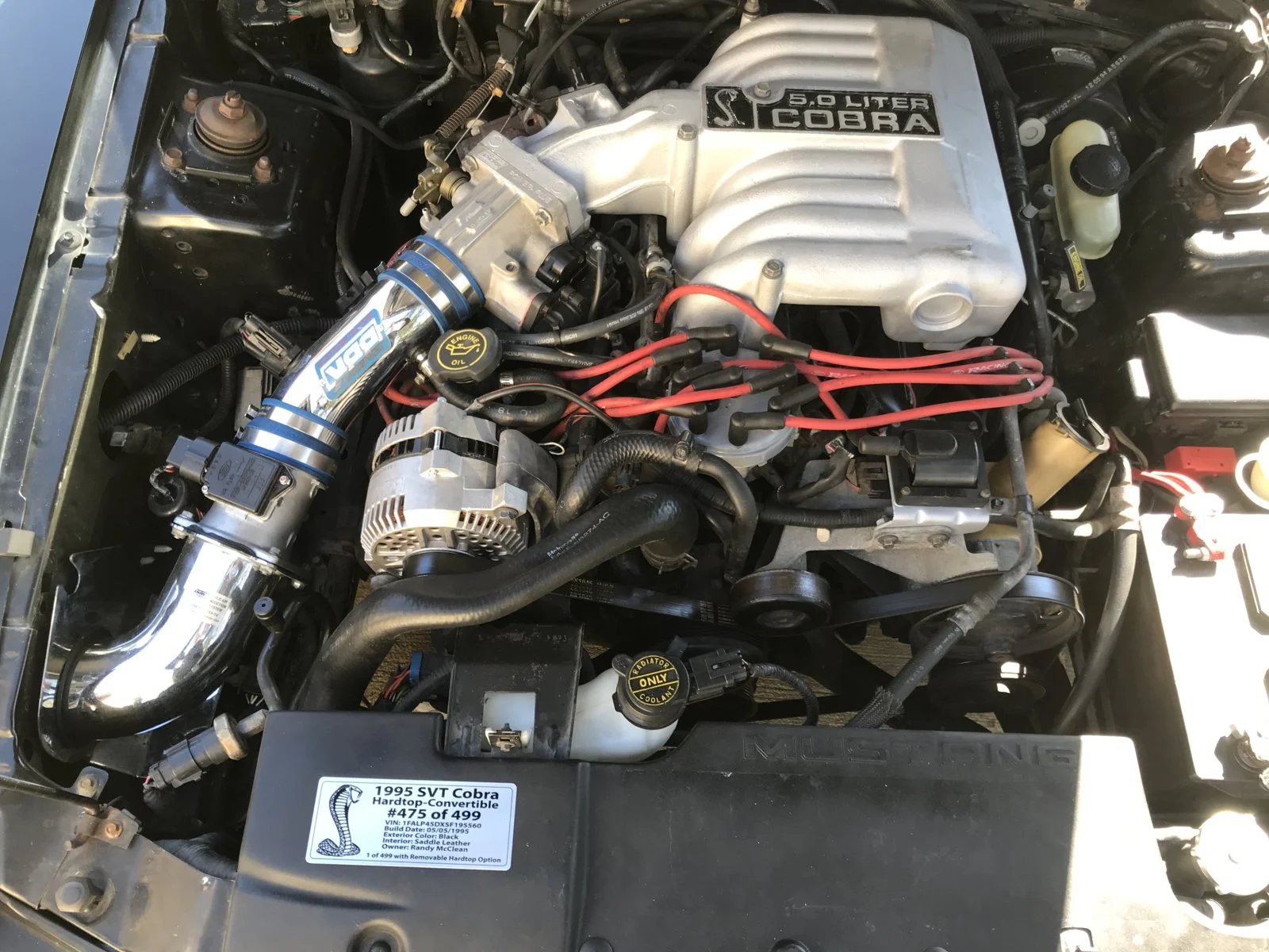

-Cobra stamped valve covers
- Cobra labeled brake booster

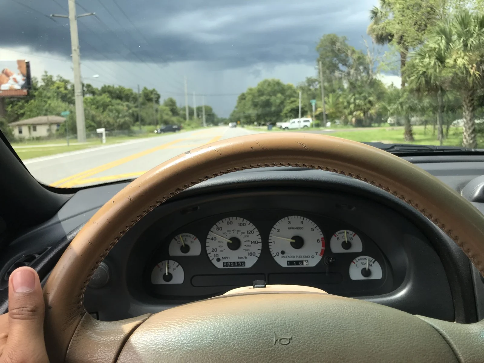

-Cobra stamped airbag on the steering wheel
-17 inch alloy wheels
- Cobra marked PBR brakes

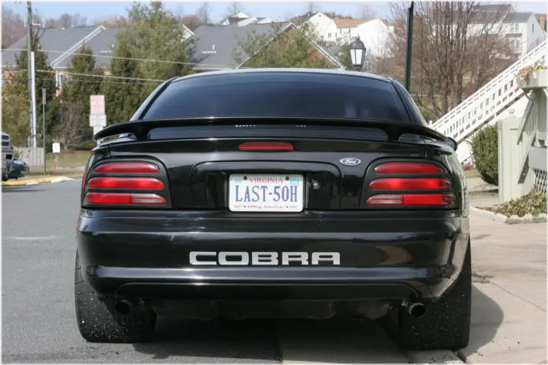

- Crab claw rear spoiler with the third brake light in the spoiler! Many clones don’t do this
that’s all I can think of off The top of my head

Rear bumper cover that says COBRA not Mustang GT

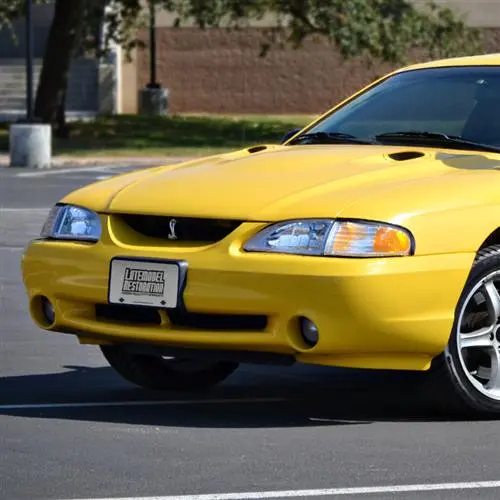

The hood has those distinctive pits in them that look more like a snake
The front bumper looks different as well.

actually the 94/95 bumpers are the same as the v6, they only say mustang. Not cobra.
