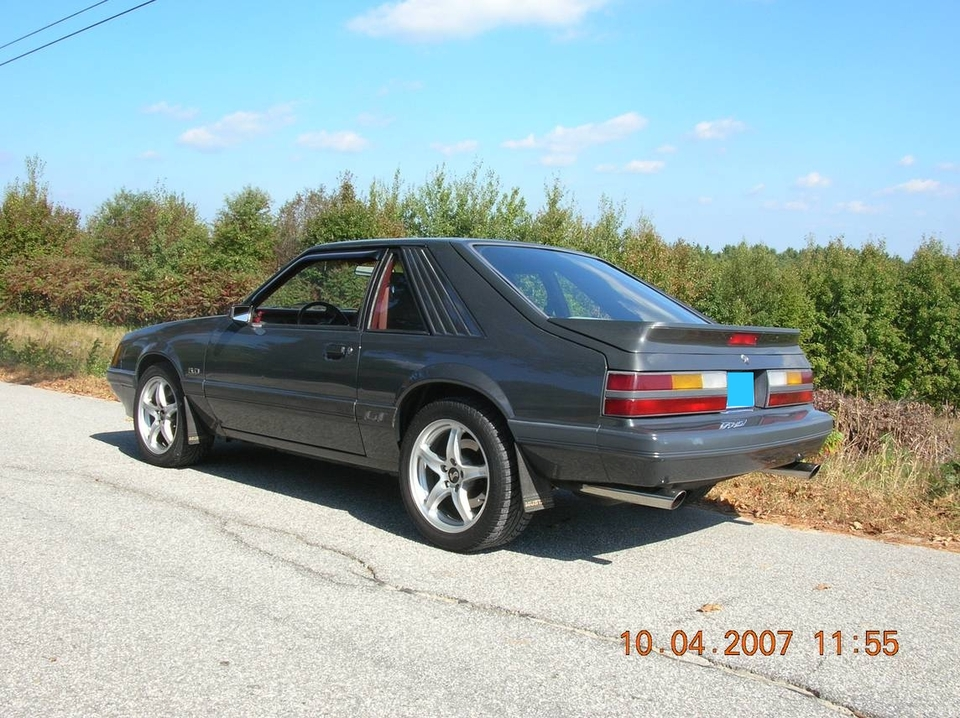

BTW: More pictures of my car:
http://www.veryuseful.com/mustang/tech/misc/Mustang1986_with_Mach1_springs/
http://www.veryuseful.com/mustang/tech/tmp/OTC-spring-tool/
I have an AOD, 3-core radiator, and I have wide tires (245/45/17 RE720s) with the smaller '86 fenders. So, I needed very little drop. I use the Steeda spacer to gain ~0.4" with the Mach1 springs. The 3-core radiator holds more water and that's further up front (more leverage). Add that to an AOD in a GT and the Mach1 springs would have dropped my car by over 3/4". Like I said, there are many considerations in choosing a spring!
