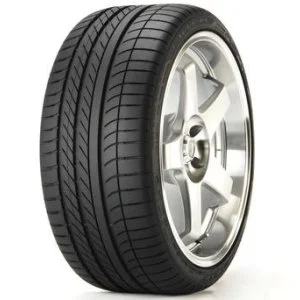

Mine is lowered with eibach springs and sits real nice on the 17x8 cobra Rs. They came fitted with 245/45/17s.. they rubbed like a mofo... on the arch lip, the front bumper and the arch liner!
I did some calculations and figured a 225/45/17 would work best. I went to my local tire place, we tried on a Continental Sport tire they had used in that size. I tore around the industrial estate and it was fine, didn't rub at all so I ordered a pair of 225/45/17 Goodyear Eagle F1 Asymmetrics.
They fit fine and dont rub at all, and according to reviews they're meant to be the best tire on the market
not sure if that helps you out any, hope it does....

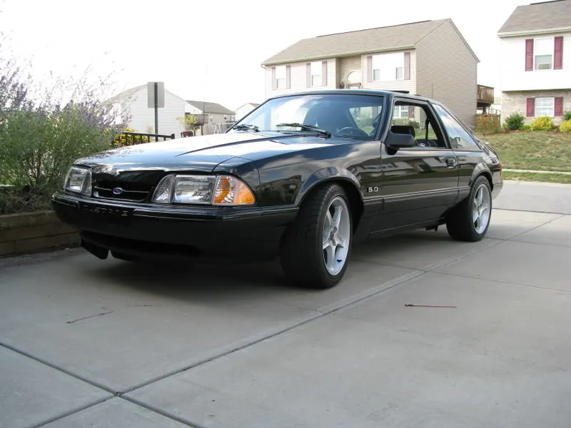

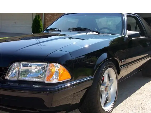

I don't really have any good pics yet that show how close they ride....here's a couple I have. I'll take some better ones tomorrow afternoon when the sun is back up. Is there an easy and accurate way of measuring my rim width? I just got the car about 4 days ago so I don't have a clue what size rims are on it. I might be able to find out from the last owner I guess.
