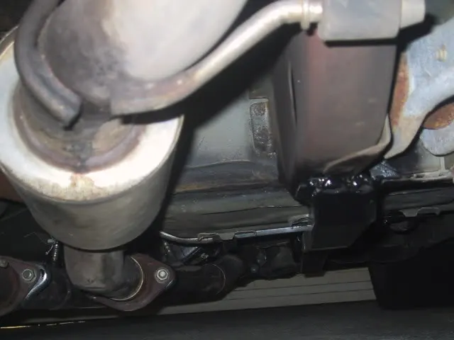

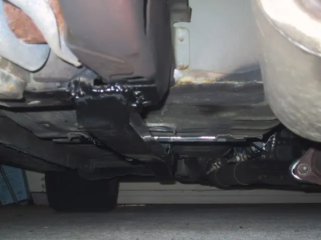

Ok the MM's shouldn't be a problem seeing how they mount UNDER the front Frame section BUT lots of the others onthe market run alongside the frame and I seriously doubt those will clear a Cat, I know for a FACT I couldn't finish welding mine in till they were removed. Also seeing as how they sit lower than the frame how bad is scrapping on them then?
Looks like you have plenty room for cats.
