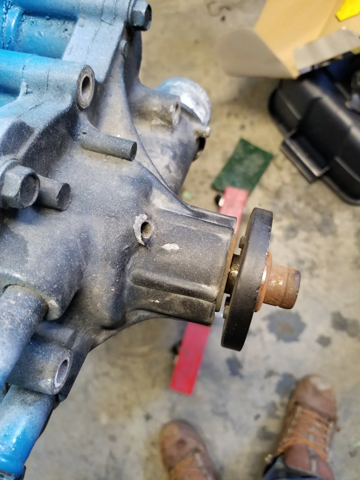

Hey I'm trying to change my water pump to a standard rotating pump and cannot seem to find a pump that lines up with the other pulleys.

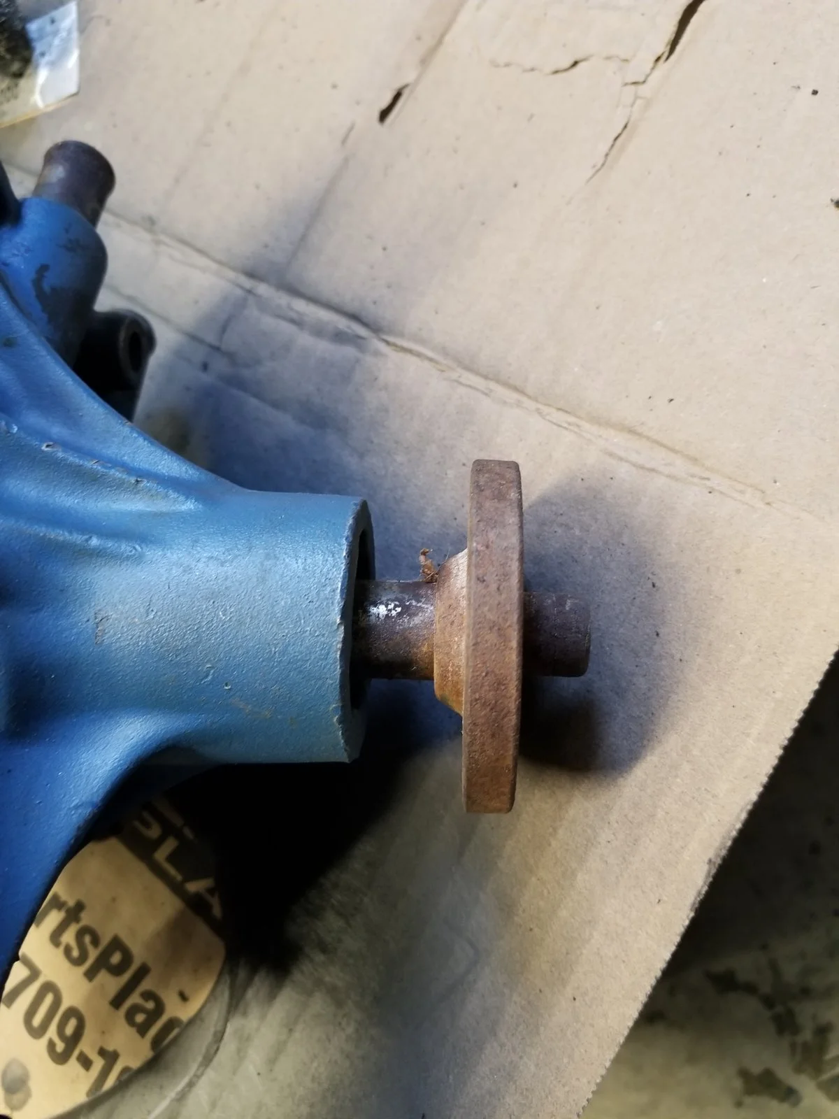

This is the pump I'm currently using and all the other pumps I seem to find with a standard rotation are longer like this one

You probably won't find one. When I used a forward rotation WP, I had to space out the crank pulley almost an inch, and fabricate the brackets to hold the alternator where I needed it to be. I just bought a March pulley set, and made everything match the WP standoff.
