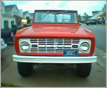

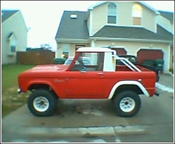

yes the bronco has been restored, like 5 years ago however the the axles have been replaced it isnt stock, the front is a dana 44 with 4:10's and the rear is a ford 9er wiht 4:10's it did have the 170 inline 6 but right now it has the 250/260? inline with the factory column shifted 3 speed tranny.....any more info needed bout the truck? i really just need to know if any one has or knows if the motor can be efi and run properly w/o ou the rest of the harness? thx for the info and help guys
