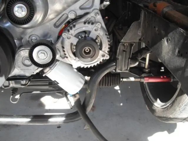

I set my engine back in. The alternator has plenty of clearance with the SN-95 sway bar mounting brackets installed in the fox location. Just one more problem solved.
I was told using a late model swaybar will cause rack turning issues and some rack stops would need to be used as well as other issues.
I plan to just use the MM sway bar relocation brackets and see if that will allow it to clear.
I used the fox sway bar with the SN mounts. There are no turning issues. I had to cut down the end links to get the bar strait.
