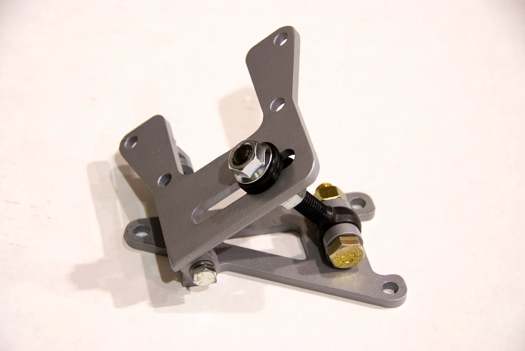

I designed the pedal to place the new 2011 pedal in about the best and only position. I plan to have these produced for people doing the conversions as well as could be used in any vertical firewall application. This pedal is not designed to be mounted on a vertical surface.
What are you putting your engine in? Is the factory pedal mount stud locations in the exact same place as the FOX pedal? I have one left from the first batch I could sell you if you need it.

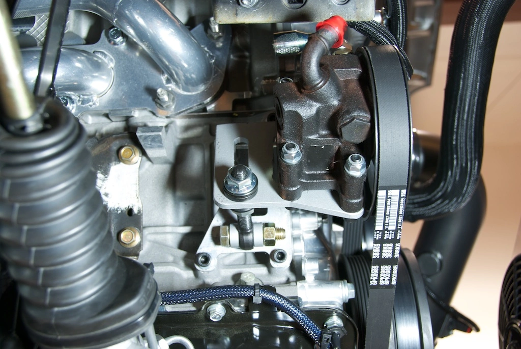

We ended up designing our own, as there were not any real options we liked. We plan to switch to the KRC setup in late August to allow for A/C but this bracket works nicely in the A/C location. We will probably produce these with a production run soon for those that are interested.
The Alternator is still in the way of the swaybar and this pump location will also interfere in early FOX's, so we are working with J&M on a blade type swaybar.
