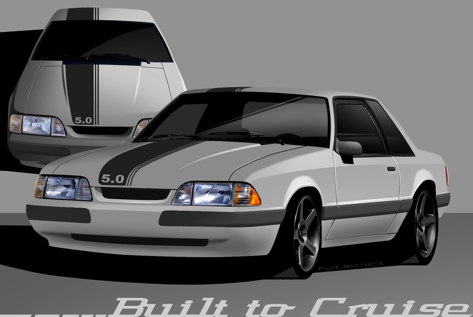

Here is the exterior view of what we have planned.

Suggestions are welcome. As stated, we are still planning the entire process and once all features are decided, we will document clearly, including all parts needed/found to convert a FOX to the new 5.0.

That rendition is sick. I would drive/own that car with no complaints, but for some reason that 5.0 on the hood looks out of place. A possible suggestion would be to remove the 5.0 and put a floating running horse in the grille. But again... sick... can't wait to see some real pics.
I think the whole point of the 5.0 is to kinda advertise the new 5.0 maybe? Probably a marketing thing maybe??
I was wondering who would be the first to put a new 5.0 in an old 5.0. Can't say the idea hasn't crossed my mind. Since this engine will be mass produced in the new Mustang and possibly other Ford models, i'd imagine it might be fairly easy to pick one up 3-5 years from now. I'd love to do a 5.0 swap in my 5.0 down the road. Right now..it's just too expensive
Looks awesome, would be a powerful, yet reliable and efficient little notch! Ide like to know how much is involved in swappin the motor and makin it run, would be an interesting swap in the future!

+1
I actually love the whole concept. 5.0 in the stripes and all :nice::nice:
Thanks for the replies.
The 5.0 in the stripe is still in debate. It would not be as large as pictured here and actually we would use the actual new 5.0 font on the new 2011.
