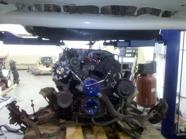

We got the old 5.0 engine out yesterday. We were waiting on some parts before moving forward.
attachment.php
The Griggs front suspension kit is here including the Fox K-member with modular motor mounts. The next step is to put the new 5.0 engine in and check for clearances.
How much room do we have for/a the brake booster?
Will the stock hood work with this new motor?
Where do the stock headers on the new 5.0 end up at the firewall?
One of the many issues we have to consider is there are NO headers, exhaust parts etc for this car. We can't even get our hands on the stock 2011 x-pipe to play or modify that. The heads are completely different from the 4.6L (manifold bolt locations), so using some kind of setup from earlier mod swaps is not going to work. However, motor mount locations are the same.
Once we get the engine in, we will post our findings and solutions and may ask for solutions!
