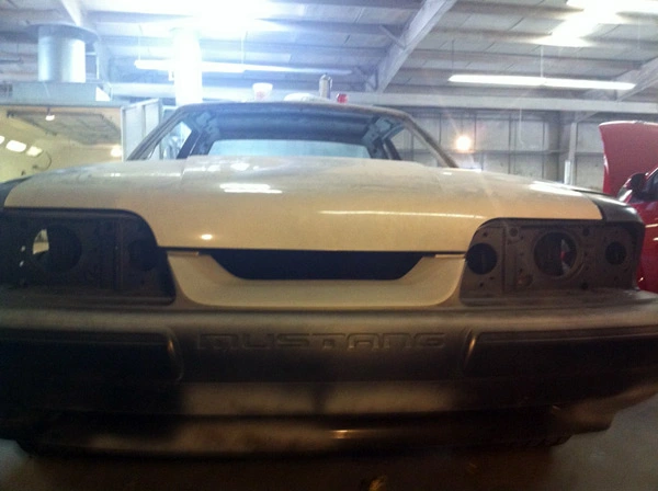

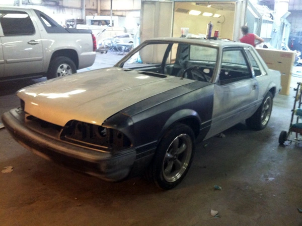

Gosh, body work takes to long IMO! We are close, expect to have the build back in the shop next week so we can start assembly.
Check out the Grill Delete from CDC, think its gonna be a nice addition!
Mike
