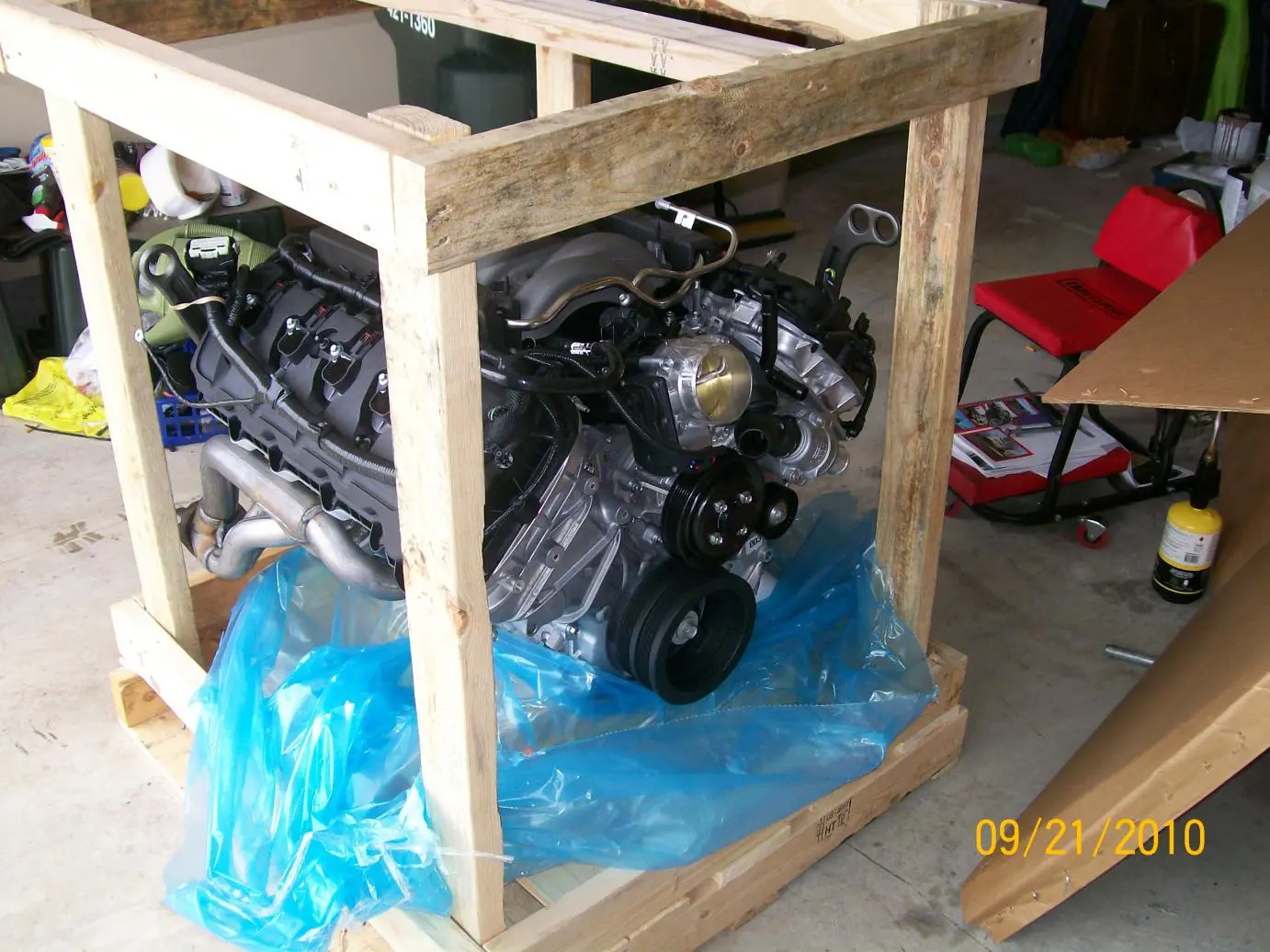

My engine arrived today!
Nice
He's got the Engine! The K-member that we worked together with J&M is here, the engine fit in nice, will confirm fitment in the car soon, Ill post pics tomorrow, I think you are gonna like it!

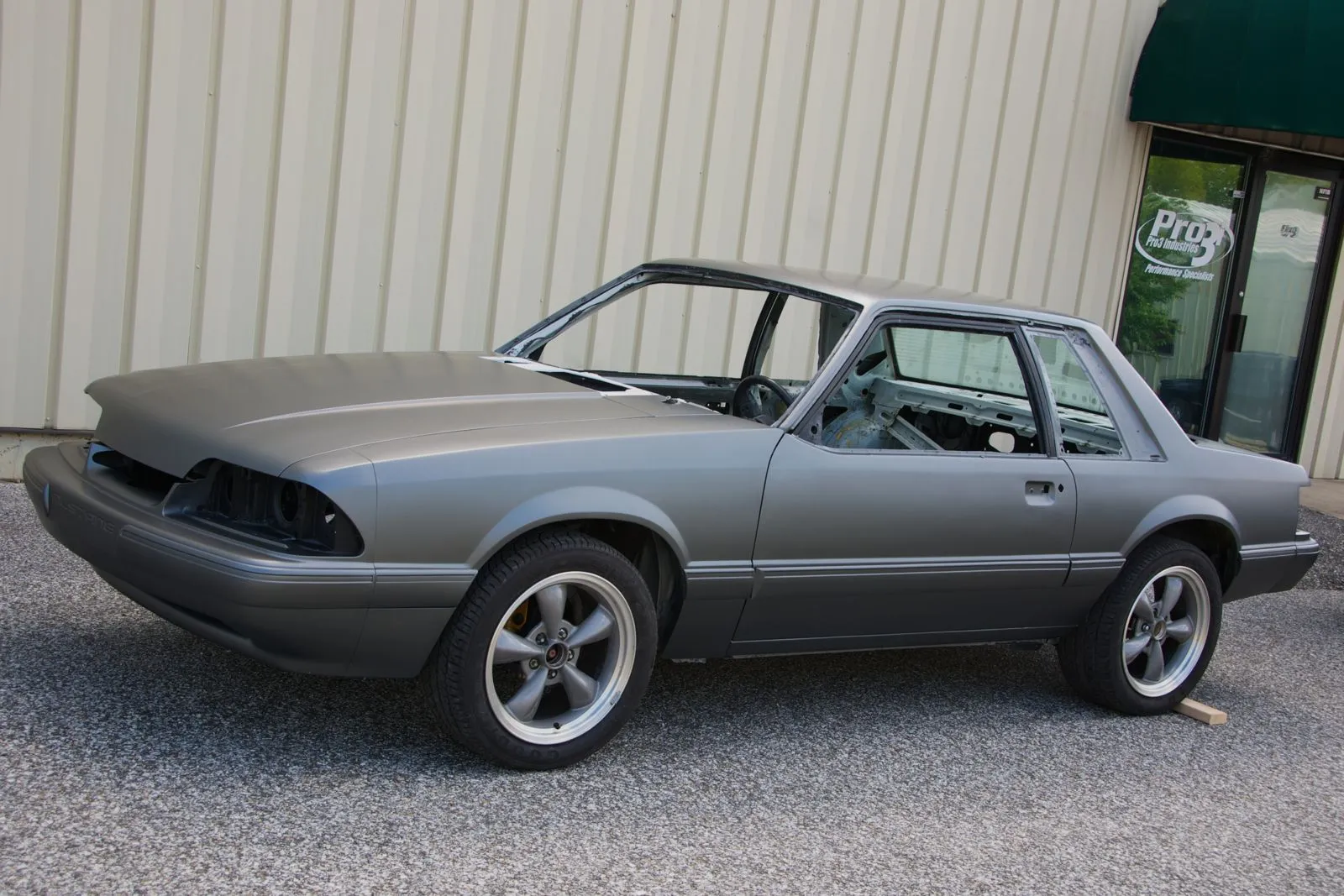

Got the car back to my shop today, check out the paint job! ;)
attachment.php
so what was the final call on the grill insert? is it gonna be body color or black?
You know it's a tough call really. I think Im going to go Body Color for now and get CDC to send us another one to do one in black. That way we can see what is best and also showcase maybe for them 2 different looks.

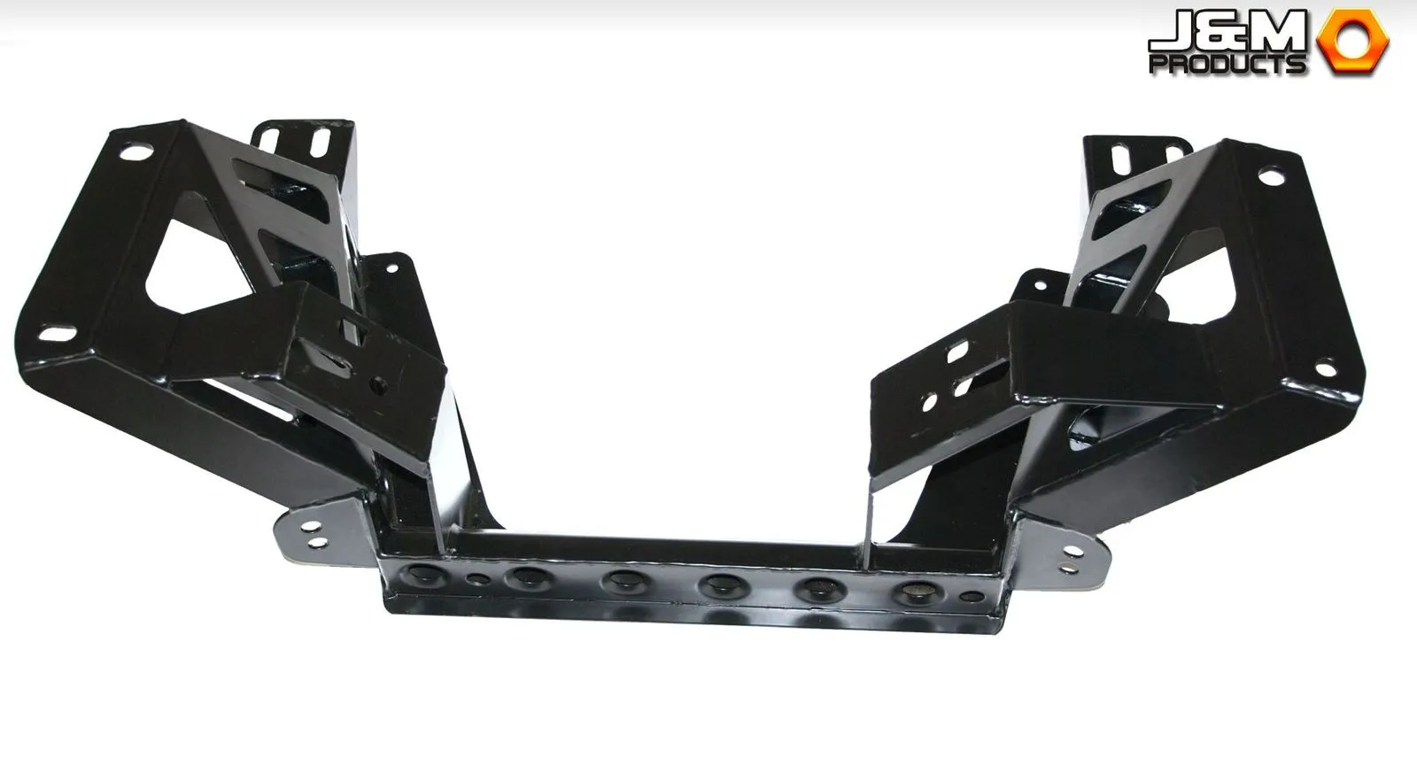

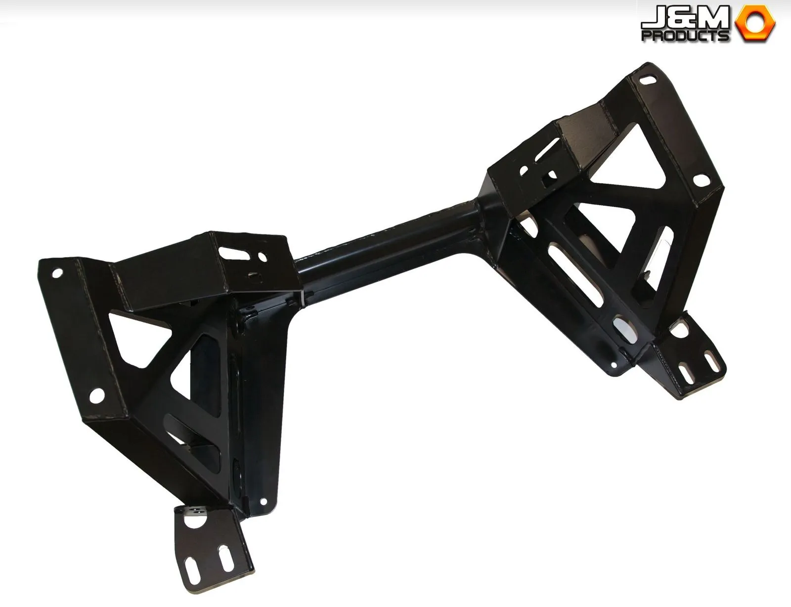

J&M K-Member for the 5.0

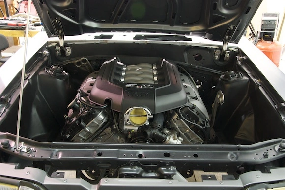

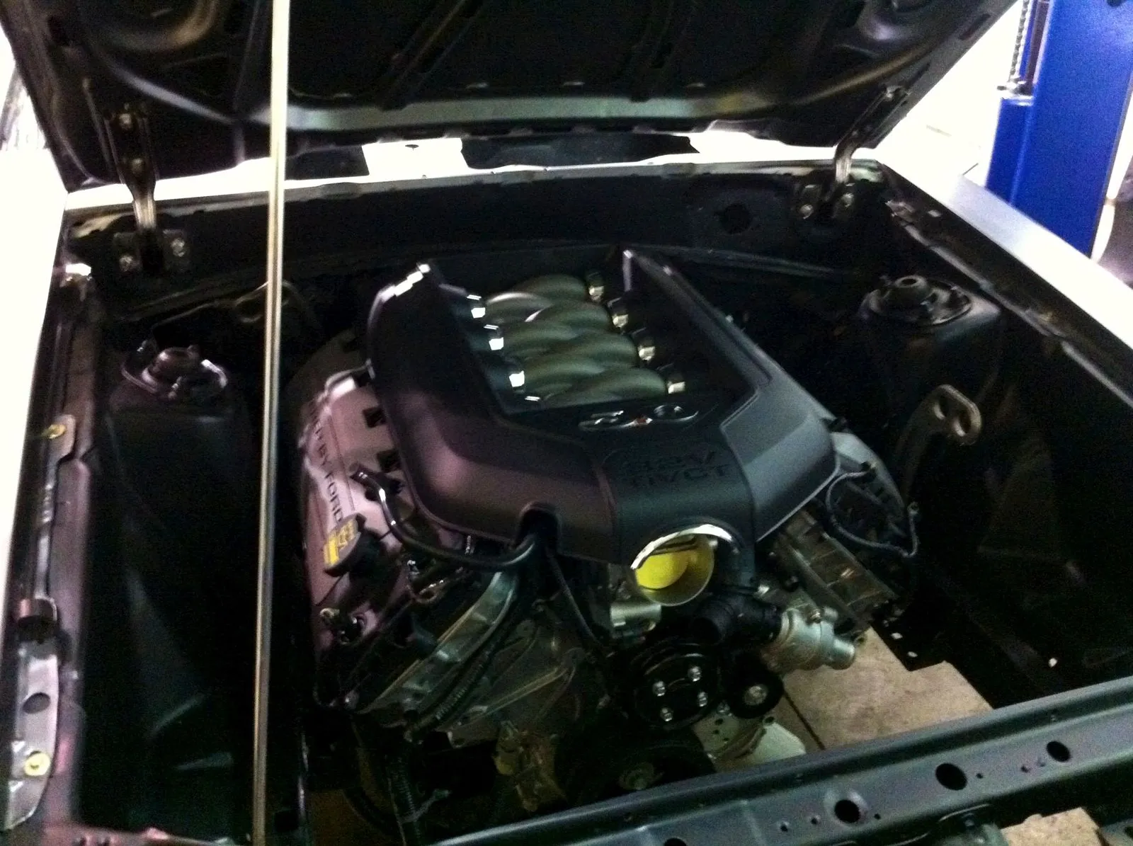

We test fitted the newly designed K-member from J&M today in the BTC project. They designed this new K-member to function/work in 79-04 Mustangs. It comes with 2 LCA arm positions and with or without spring perches (for coil overs) and you will be able to use your own stock LCAs, and I believe they will be making their own J&M LCAs as well. This will also work for other 4.6L engines and they will be fitting pushrod mounts as well for the setup.
The design is radical for sure. No tubing used which actually carries less material if you were to compare to tubing metal content.
The engine went in like a charm and we noted some simple changes we think would benefit the setup and will be going over these with them soon and getting another one built to spec. We wanna tweak the engine mount platforms to give more room for header clearance and some box strength for the platform.
This piece is solid. They put a lot of time in the engineering of this thing for sure! The K-member is much lighter compared to stock and we will get an official weight soon.
There are changes to this new 5.0 motor with the oil pan and some room had to be made in the design of a K-member to accept. The engine is sitting at stock height and to our jubilee the FOX stock hood will work just fine!! The rack mount locations are a little lower (on purpose) and will require a bump steer kit to get the perfect alignment.
I'll keep you posted on this one, but we are excited to see this piece from J&M and appreciate their hard work on getting something built to fill this new market.
