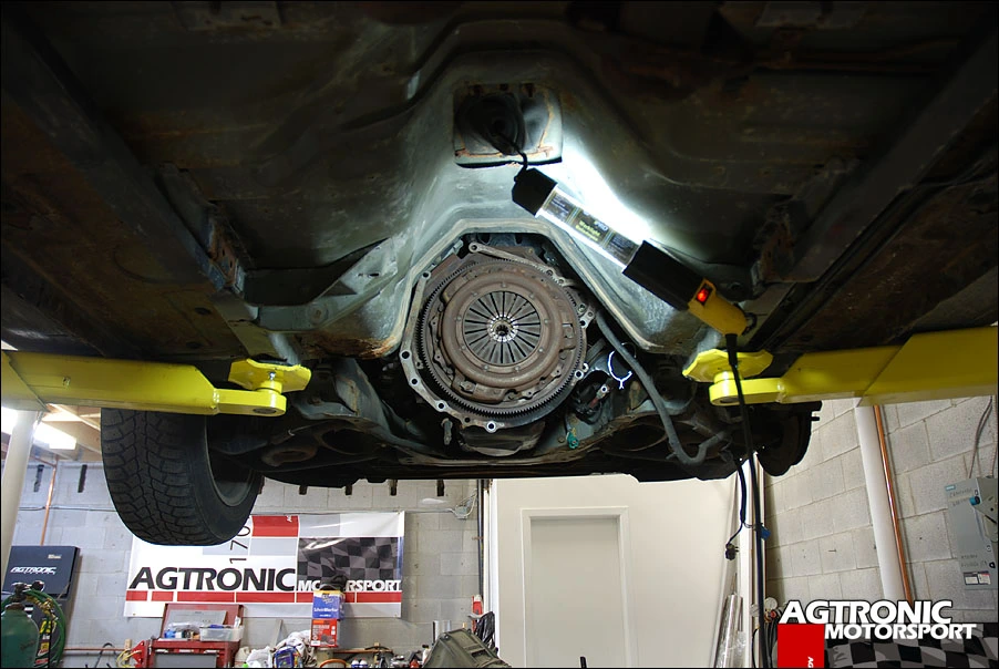

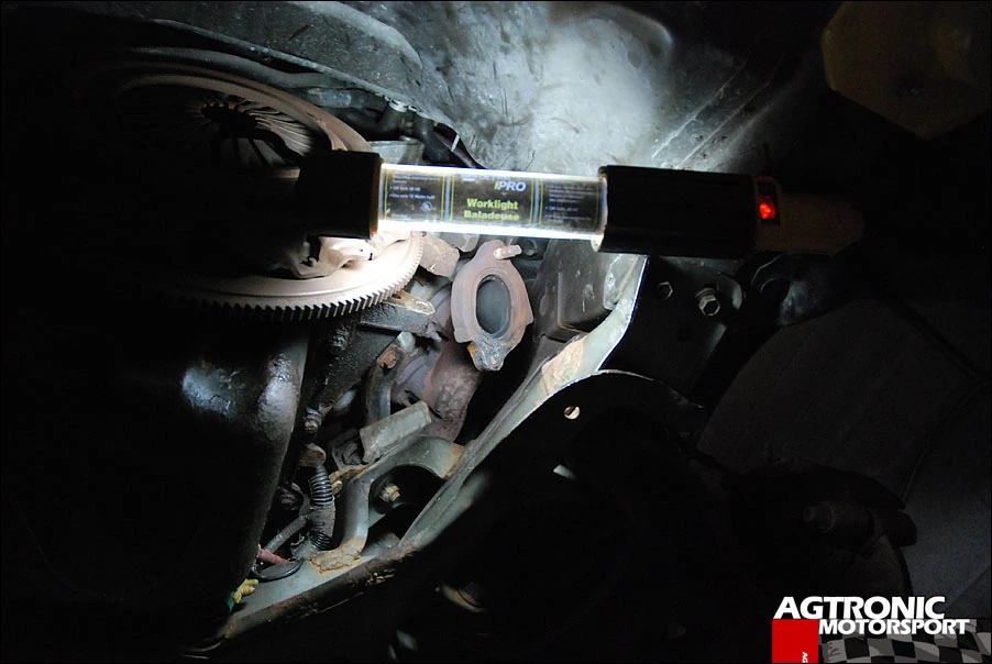

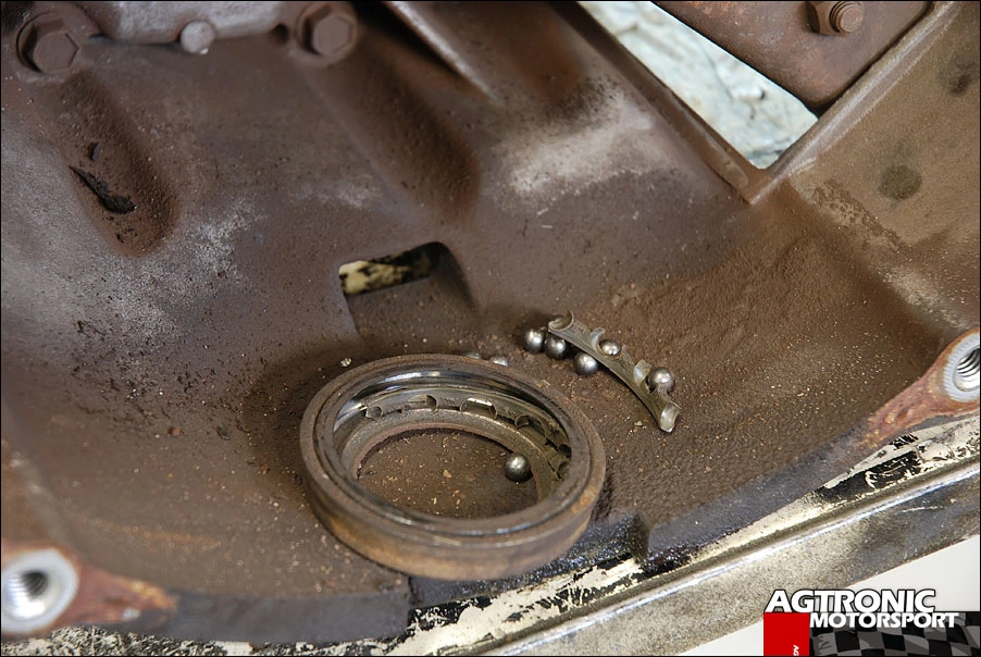

My throw-out bearing is on its last legs on my 96gt, and we're trying to replace it here. This job is quickly becoming a huge nightmare. Everything is rusted, so we had to saw the exhaust apart just to make room to pull the transmission out. We have everything undone, but now we just need to remove the starter.
How the hell are you supposed to reach the uppermost bolt on the starter? The engine mount bracket is in the way. I've tried removing the plastic fender liner, which doesn't help at all. I've tried going from the top, no go.

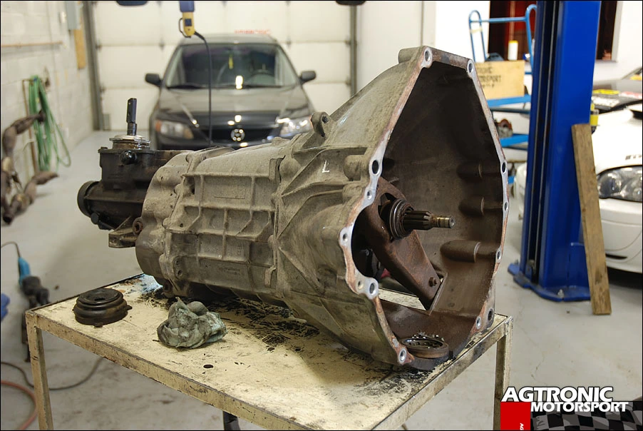

Transmission wasn't too hard to get out either, not as heavy as I thought. I got transmission fluid all down my shoulder as we were wiggling it off, and it stinks something fierce, but it's still better than bringing it to the dealership. :)
Hint: Drain the transmission fluid before removal, or it will leak out of the tailshaft all over you...:D

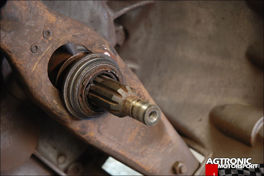

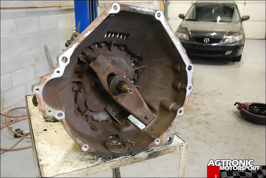

Think it needed replacing?

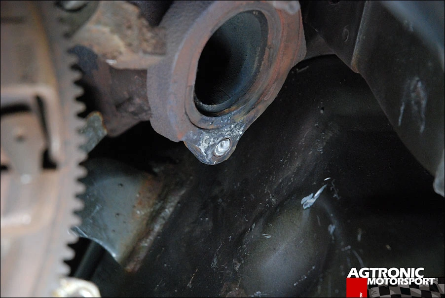

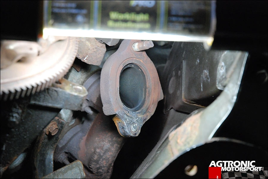

Notice the chopped downpipe :
More nightmares :
