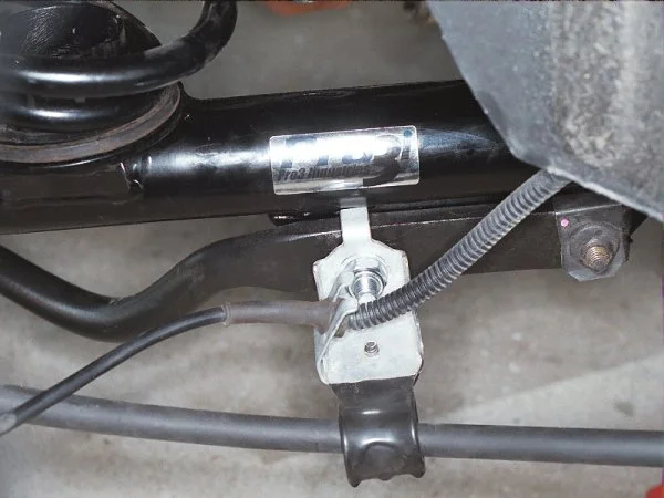

The one nice thing the Pro3i have among other things is a brace under the spring perch,...not many others have this. I think they're great!

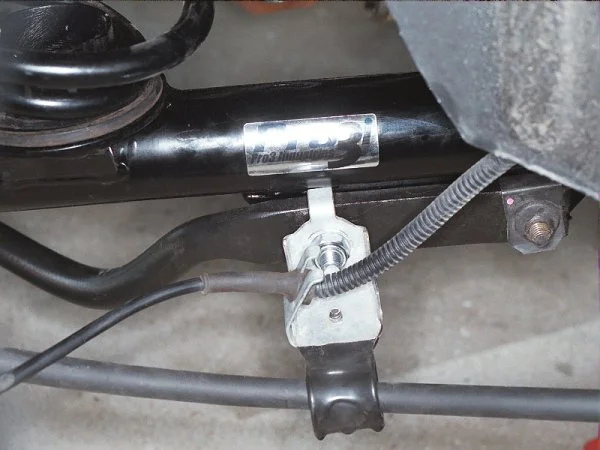

Bugman.dave shows a smart way of reusing the parking brake cable/antilock sensor brkt. Don't know if that will work with 10.5 inch rims. I cut mine off.
