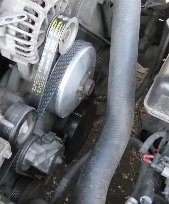

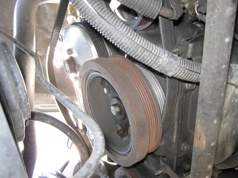

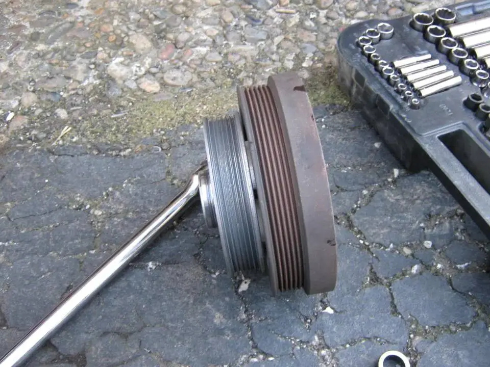

Yea i just couldn't find any info or enough people to give me any info about them so i went with what i knew was a great product. One minor setback though. The Water pump pulley that came with the steedas made the belt not line up correctly, so i just used the pulley from the bbk kit and it worked. I still gotta get a socket big enough to remove the alternator pulley bolt so i can swap the two pulleys so i only have the harmonic balancer on there but thats fine since its the main reason the kit is sought after. well heres some pics i snapped

02nightmaregt said:
so on piggyback setups, the stock balencer just sits there with no belt on it?
I
ItsStock02
Aug 18, 2008
492
Westland, MI
Feb 23, 2009
#15
  • Feb 23, 2009
  • #15
Yep.
Yea, granted in that pic i had already popped the belt off the alt. But yea it just bolts to the silver one in the pic and that is what "balances" the udp. Its a ****ty setup and it vibrated like crazy. If you get a set do yourself a favor and get the Steeda's. I can definately feel a difference in smoothness which makes it feel wayyyyyy better on accel.
