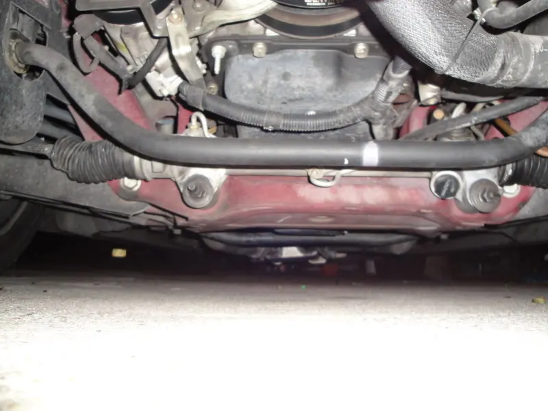

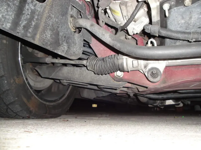

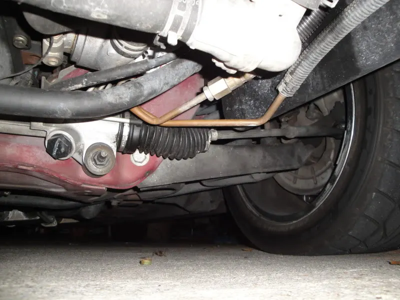

ok, maybe some pix can help
using the flash makes me fee like its sooo dirty under there.... And i think i meant to say that the Tie Rods have the grease fittings...
