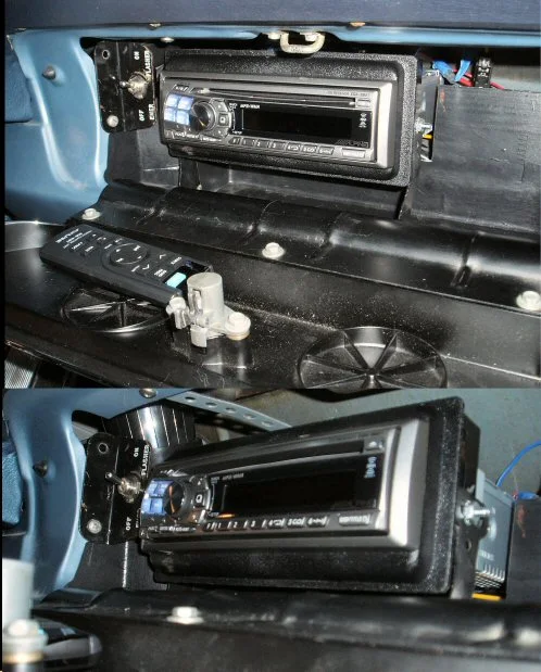

All right here's what I ended up with. A few scrap brackets from the junk box and a universal face mount kit. The lower photo shows the strap supporting the back end. Seems pretty solid so far and sounds much better.

MustangPaul said:
Excellent! I may end up taking part of the top of my glove box unit out so I can brace it at the back. Is it invisible with the door closed? Remote work?

It's totally unseen with the door shut. And no I haven't had any success with the remote through the door, but it will be handy not to reach over for adjustments. Other than to open and close the door. I'm pondering the idea of trying to rig a fiber optic line to it. Don't no if IR travels through that stuff or not.
