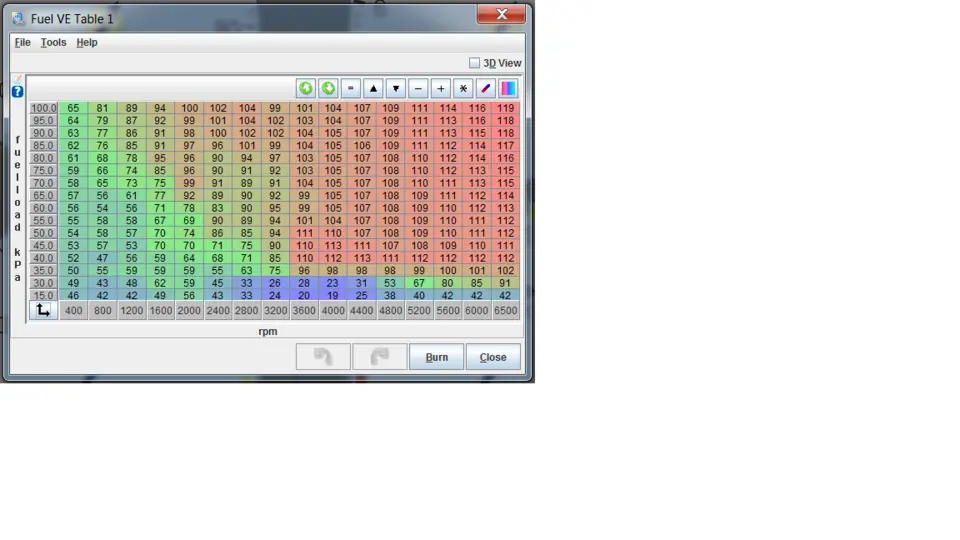

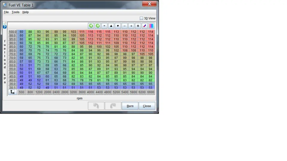

So I took another short run at the tuning last night after getting home late. I redid the spark table but it's still not wanting to rev over 2k rpm. I tried the Autotune function and it seemed to have helped a little, but I think it was too far off for it to be much help. I sent a datalog and the tune to a91what and he confirmed what I was thinking. He says more fuel, so we will give it more fuel. Here is what I had versus what he suggests:
