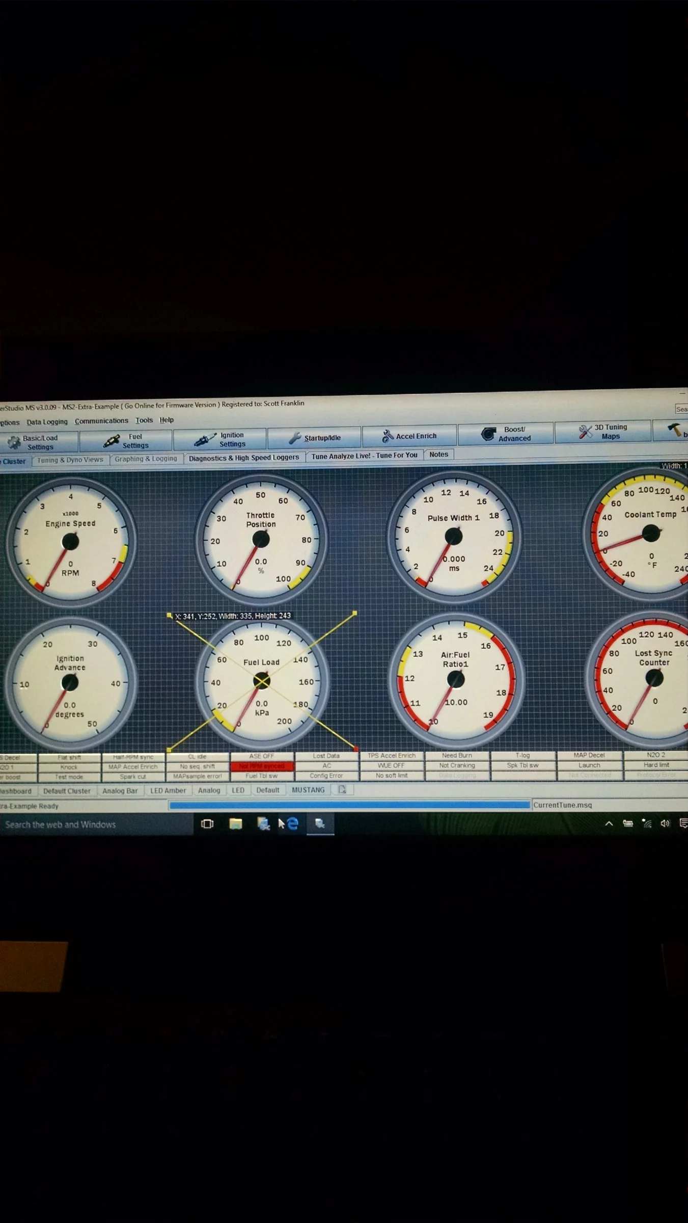

I've got issues already. Do I have to be plugged into a MS computer to adjust the gauges/ dash board ?
I've got a registered version of tunerstudio and can't figure this thing out to save my life.
As soon as I can access stangnet from my laptop I'll start pulling files from here. Having issues with that too.
Steep learning curve....yeah I know all about it. [emoji19]

When you right click the gauge panel there is an option at the bottom called "designer mode" this has to be checked in order to make changes.

I feel like a real idiot...but thanks. What would we do without you man ?
