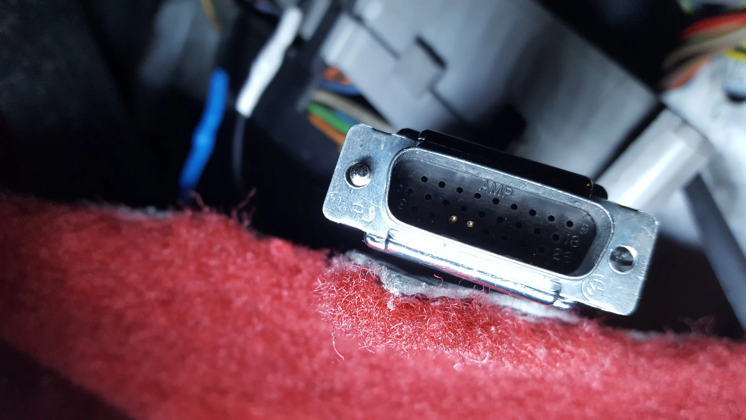

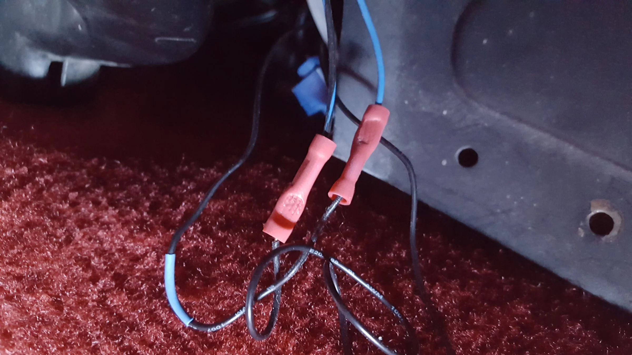

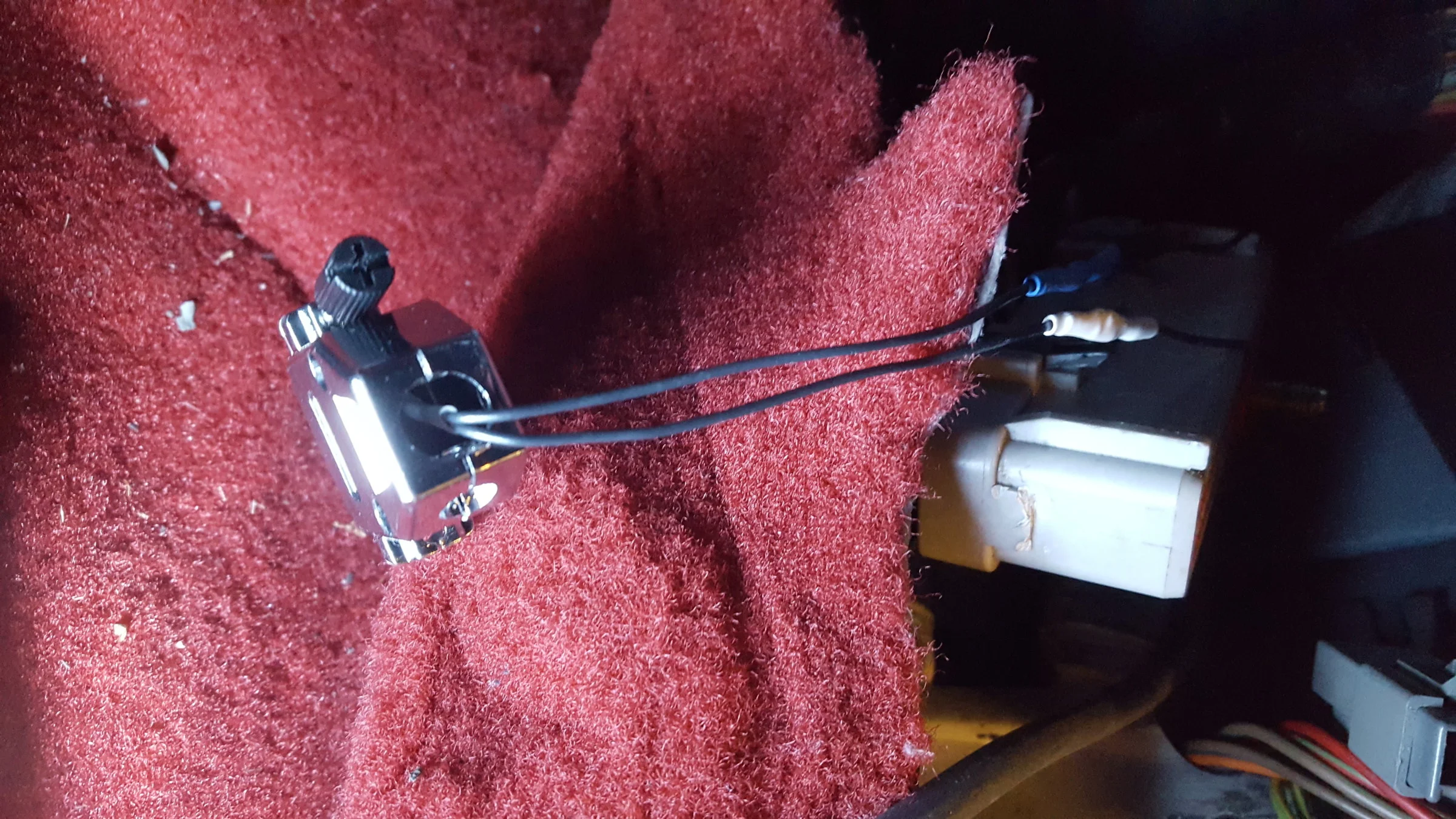

I took everything apart and plugged the male pins directly into the ECU port. Ran car for about 15 min. The gauge is no longer static. Please see if that made a difference. The pins from the WB may not be making a good connection to the ECU female connection. Trying to cover everything on my end. Had to extend wire. The blue wire has the blue heat shrink on it. The third photo of the male connector the blue wire pin is to the left and blk to the right in housing. Thanks
