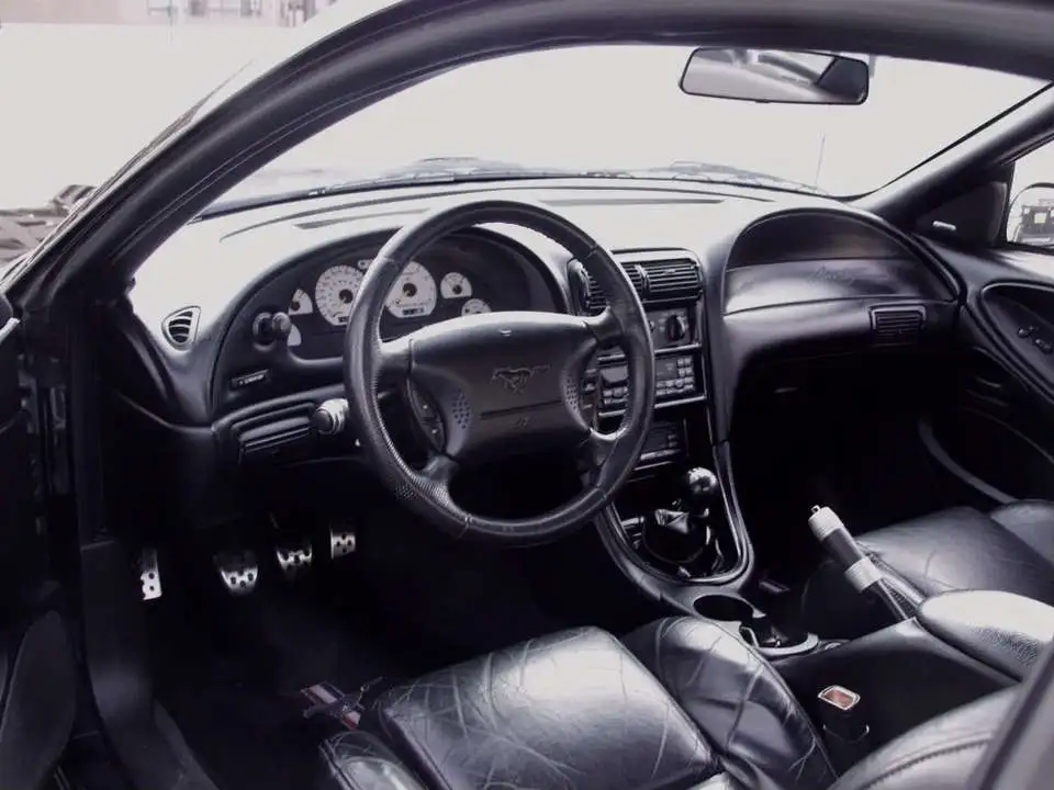

I did the Bullitt pedals a while back and couldn't be happier with them. I didn't think they were that bad to install though. I had a bucket of nearly boiling water, some gloves, and a spray bottle with dilluted dish soap. Worked like a charm :D and they look f'n sweet
Those look exactly like what I have and I hate 'em...LOL. I want some plain old soft rubber ones. I'm going to start looking around and see what I can come up with. I'm more worried about function than what they look like. The stockers look great. What did you do with the ones you took off???...LOL.
