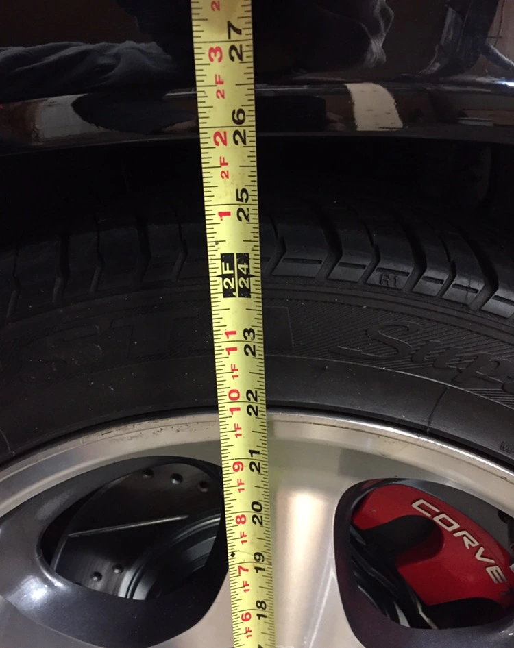

I'm researching for a spring swap over the winter. While the Mach 1 springs ride nice, I could use a slightly lower ride height. I just don't want to go too low, and a lot of comparisons I see compare drop to previous stock height.
I'm curious to how much lower (if any) these springs actually dropped me. Id like to find out go far off stock I actually am
Could someone with a stock spring LX hatch (or any other style) measure from center of center cap of your rim, vertically to the fender lip? Reason I do it this way is because it takes the tire size/inflation pressure out of the equation.
With my Mach 1 springs, I am at
13 3/4" front
14 3/4" rear. (With adjustable LCAs)
Remember, that's Center cap to fender lip. If you want to go total height over the ground, I'm 25 3/4" front. (I only did the front because I had the rear Lcas adjusted for a different size tire and can adjust to match fronts easily )

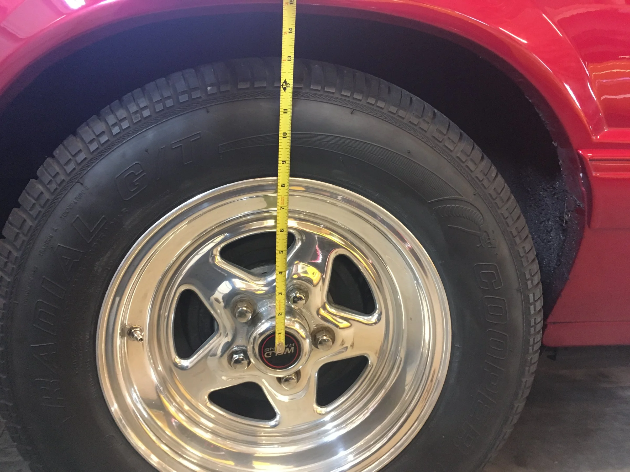

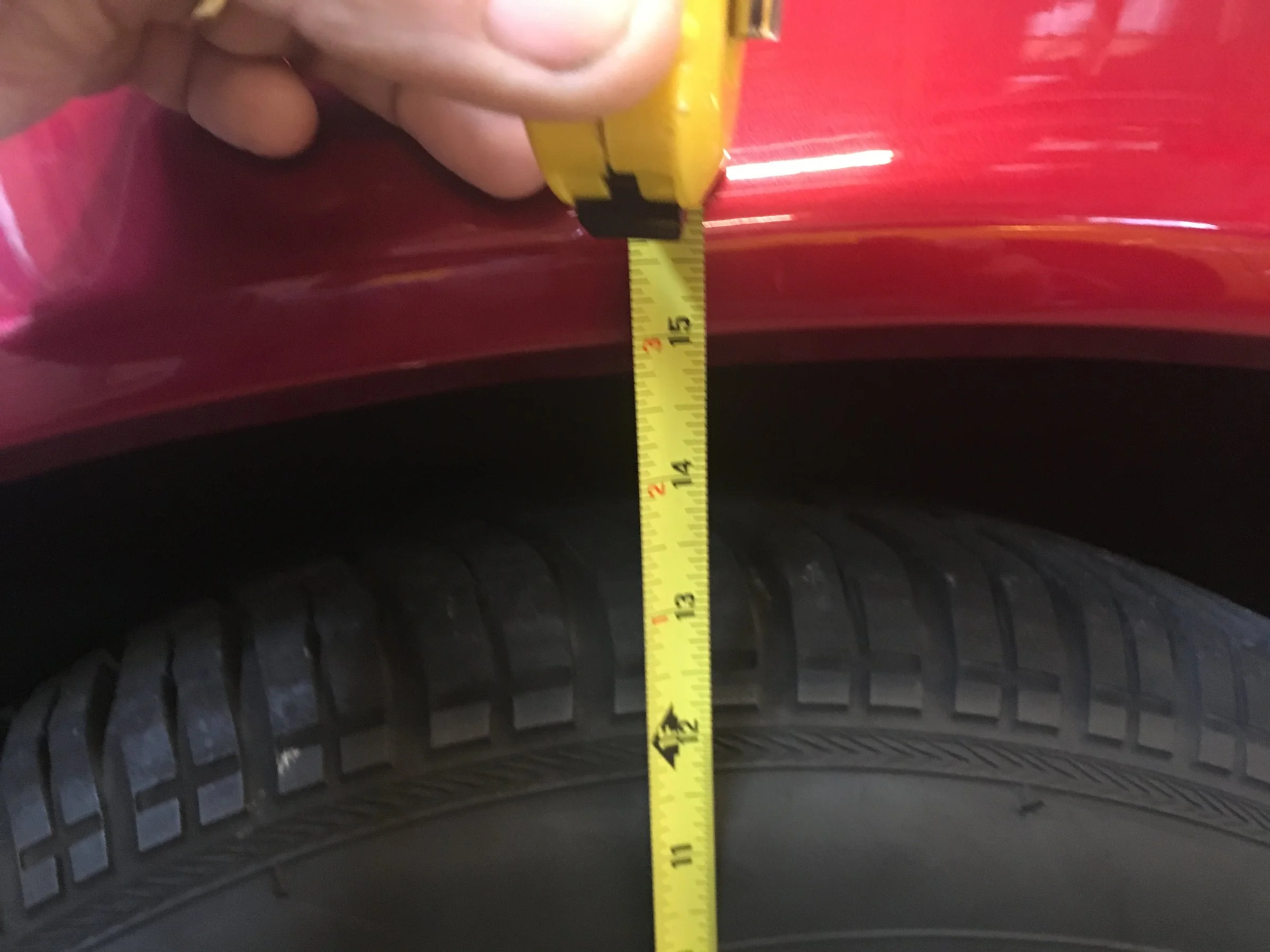

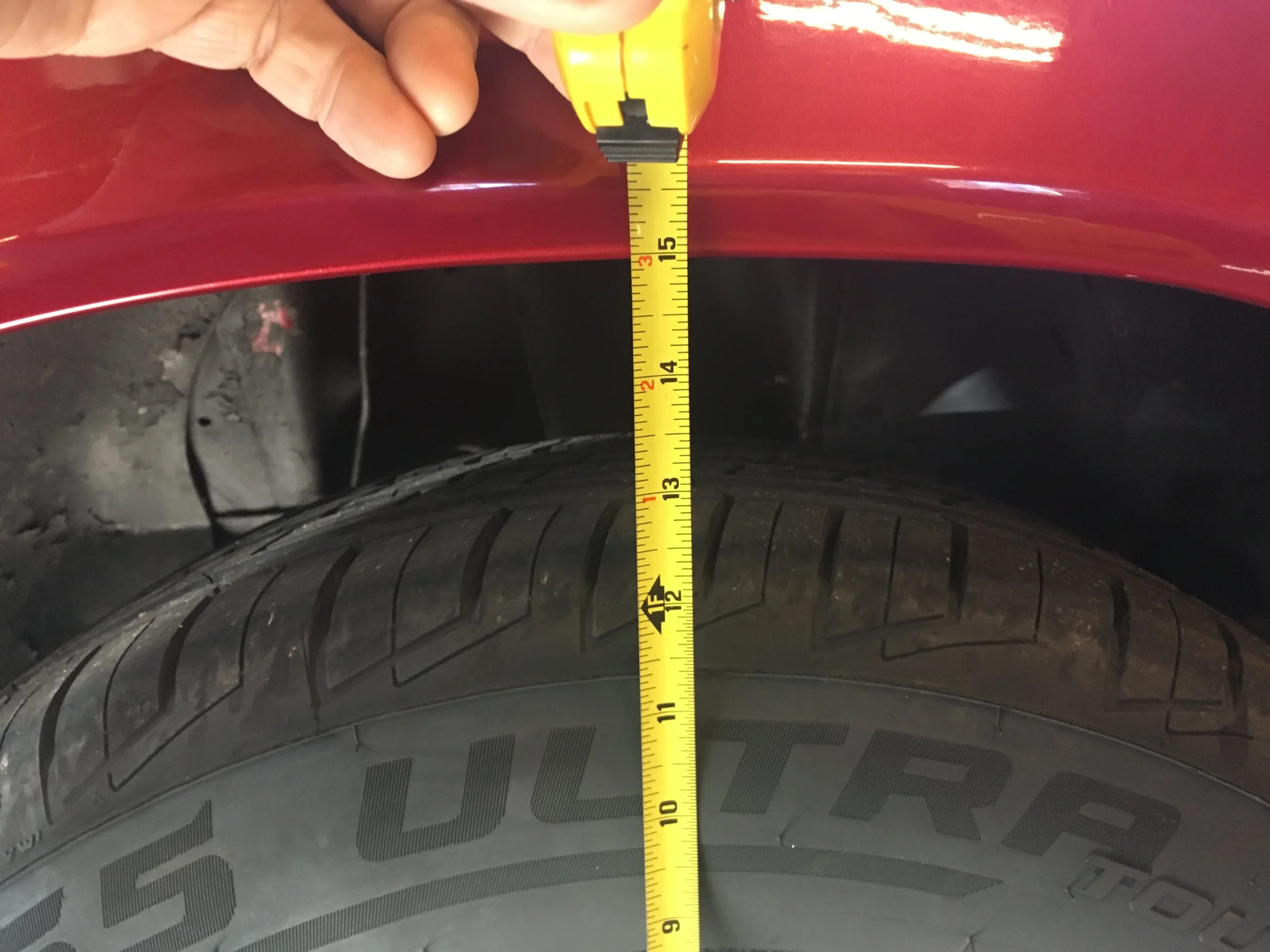

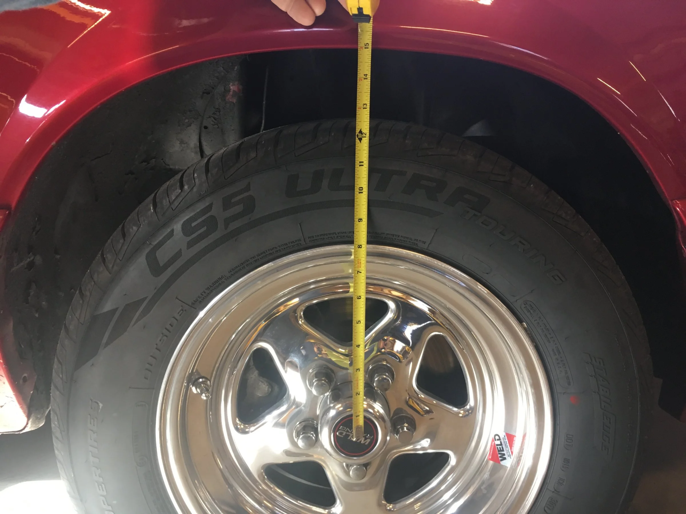

I got roughly 15” both front and rear. These measurements are on a 93 LX convertible. The car is ac and smog pump delete up front so that loss of weight may have effect, although minimal. These are stock springs with isolaters installed. Rear is displayed first followed by front
