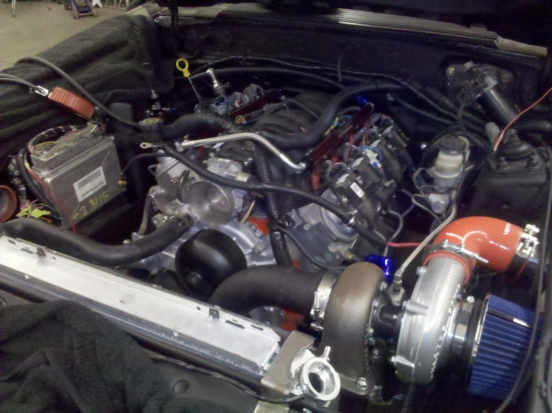

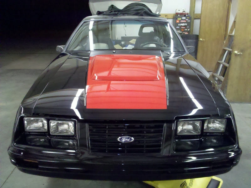

Here's a few pics of the pile, please don't hate too much on my motor choice :D
