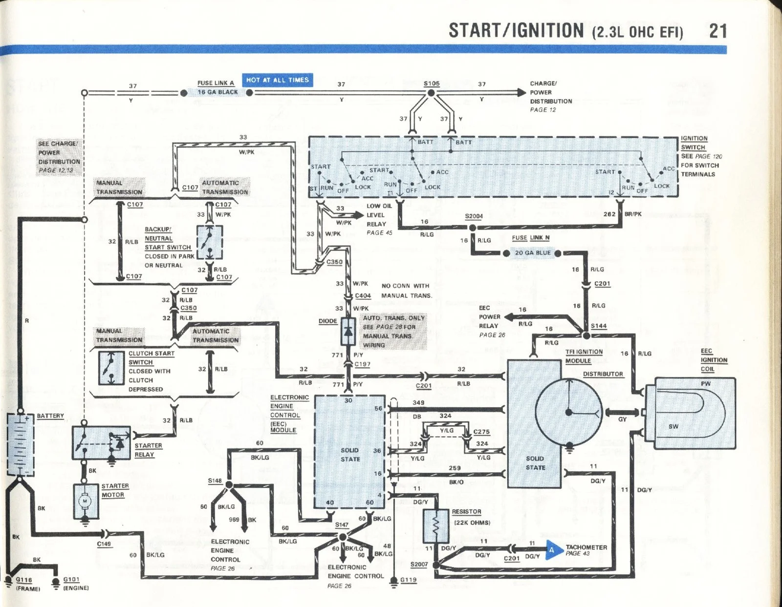

So i tried stock wiring today and no surprise to me it did not work.. tach moves slightly when i turn the ignition on so its getting power, but does not read anything when engine is running.. im assuming either because its the 4cyl tach like mentioned or msd ignition aforementioned..
Edit: So looks like either I’ll be waiting to find a stoch v8 cluster, or possibly a external tach as it seems theres no other options unfortunately.
Wiring is the same, tachometer is different.
