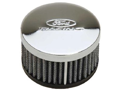

With the Scorpion rockers, you will need to remove the baffle completly. Without the baffles, the line from the tube to the TB will start to suck up oil. I just disconnected the line and ran an open breather. Like this one
