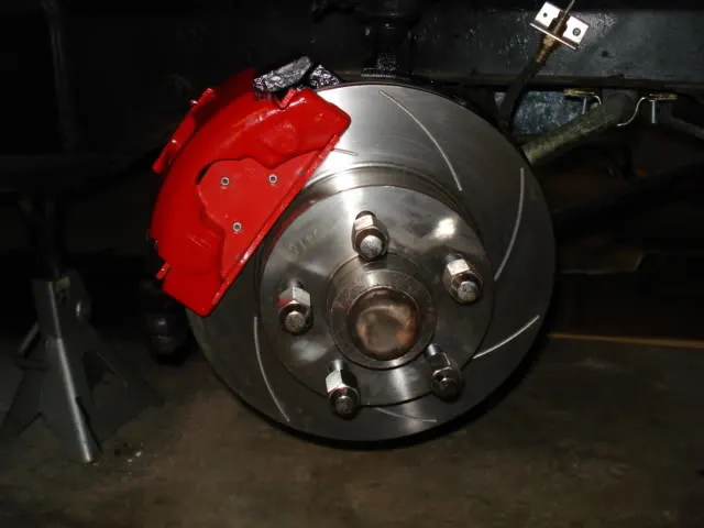

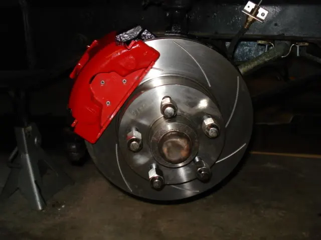

I now have updated to slotted rotos and new calipers (the old one froze up on me) and I did not install a clip on the new set-up. Still to cold and too much salt on the roads to try the new brakes. Once I do, I'll let you know.
New set up shown below:
