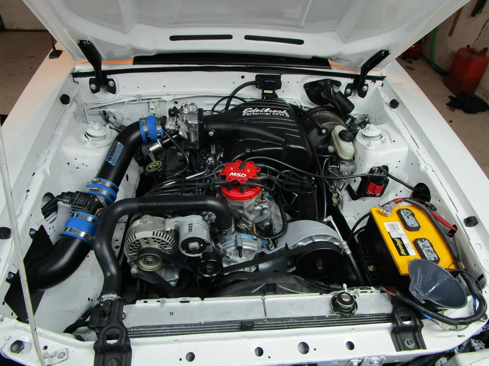

Turned the roller to the tune of 330hp/340tq and was running 1.7/12.4/110 1/4 miles

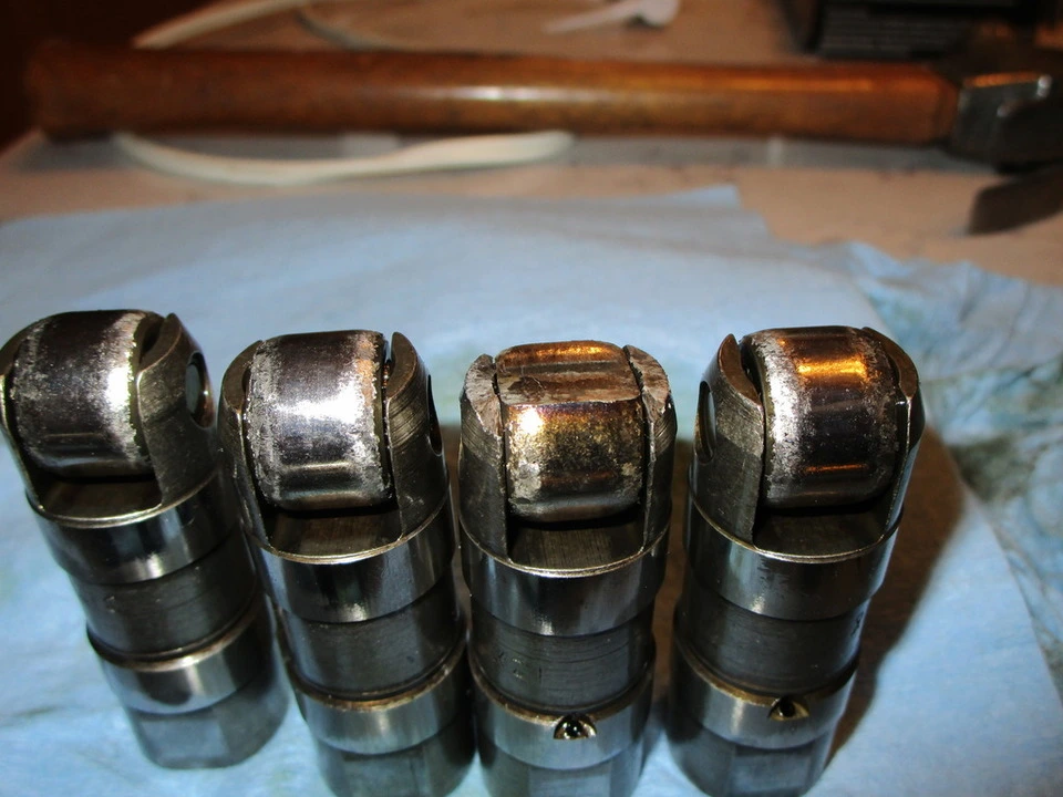

After missing a shift at the track and hearing a really bad noise, I pulled the intake to find this (the spider had let the front 2 dogbones slip out for this to happen):
Topend was pulled off the car and sold:
The old, but till now trusty, explorer 302 was removed last week

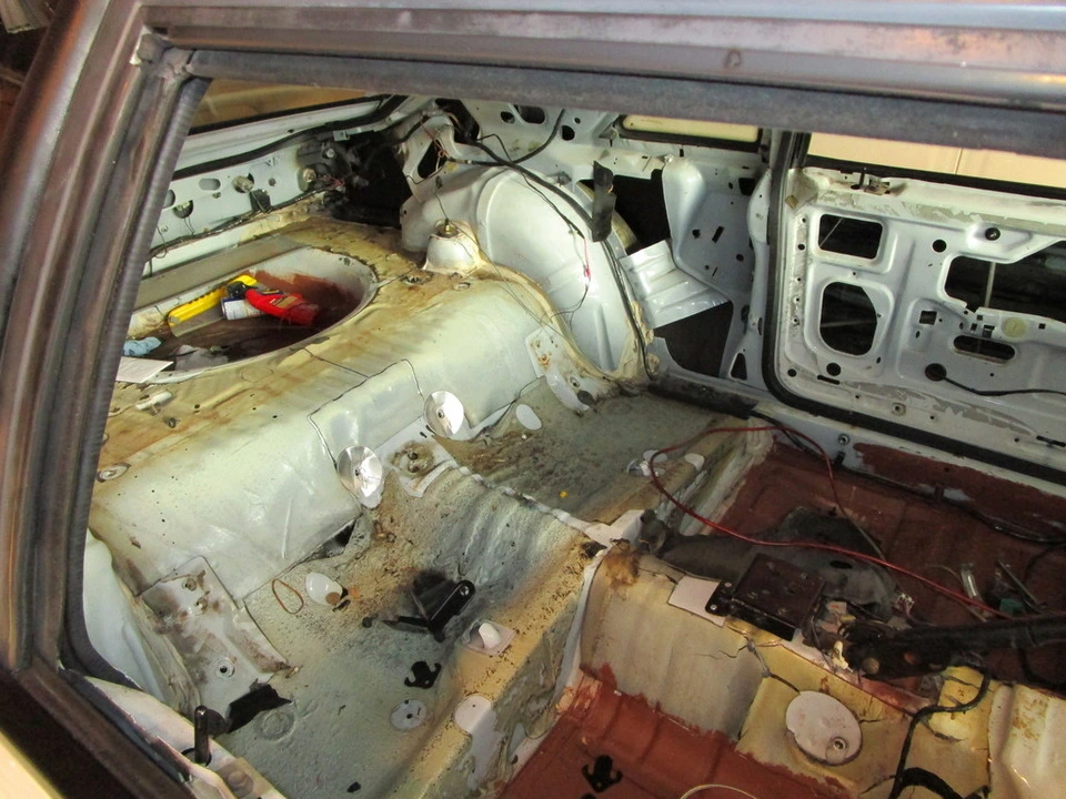

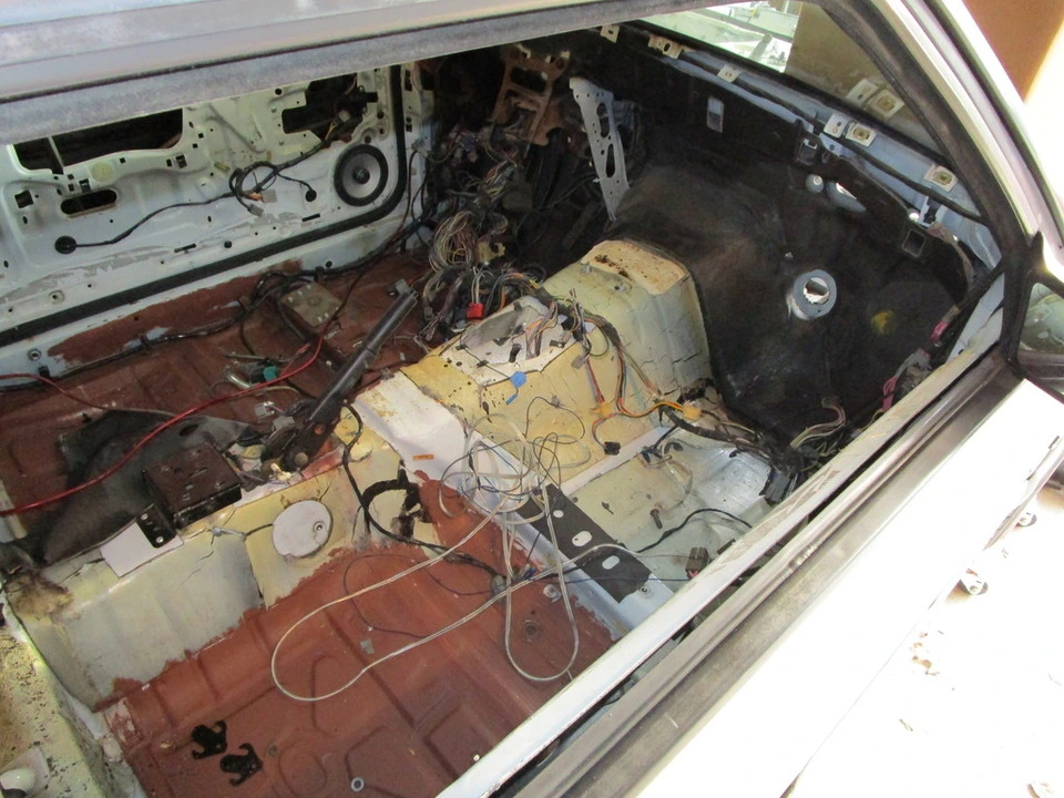

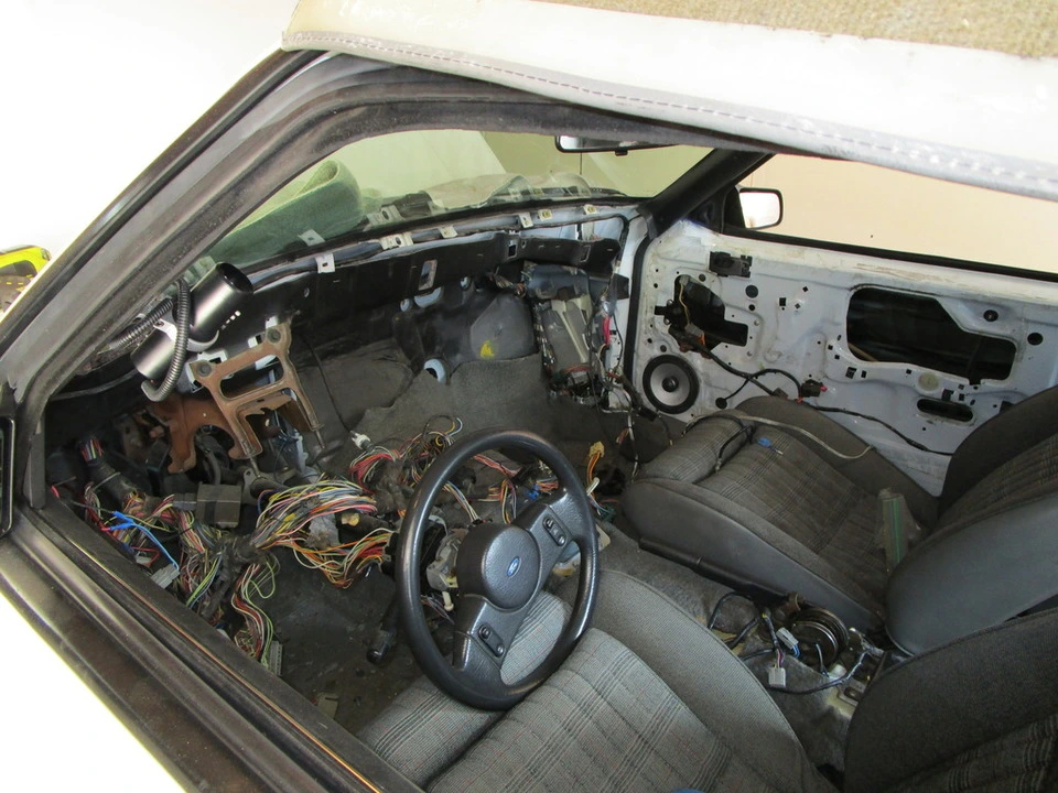

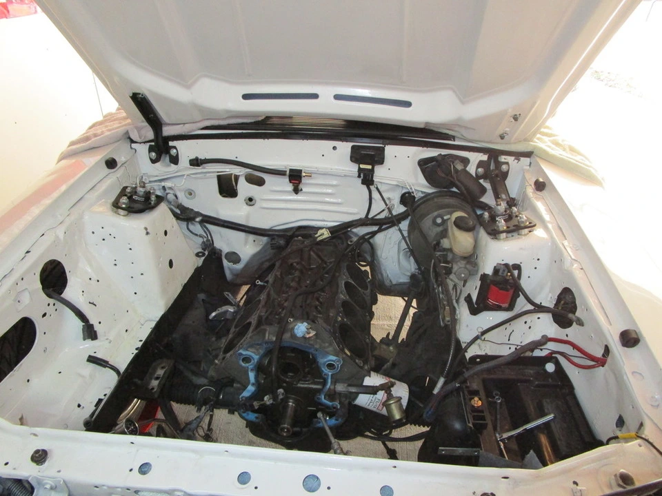

Started pulling the interior a couple weeks ago:
How it sits after a few hours today:

I had the same thing happen to me. The dog bone broke...lifters turned sideways and wiped the cam. Machine shop said the royal purple I was running may have been part of the problem. Told me the synthetic oil doesn't help to hold the lifters down like regular oil. I say BS... Any input ? I was thinking floating a valve allowed the lifter to jump out the bore breaking the dog bone. Would've happened regardless. What oil do you run ?
Agree with you. Valve float/excessive rpms not oil type is the cause.
Reactions: 90sickfox
This. I'm not 100% sure but I think mine spun to or over 7K, which it seems the tfs dual springs couldn't handle.

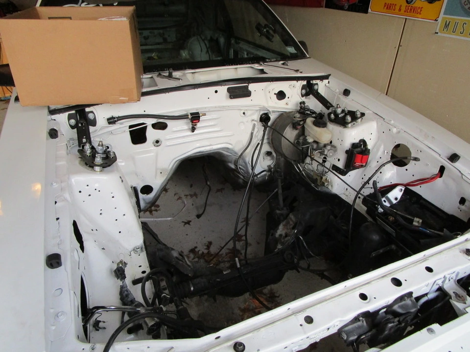

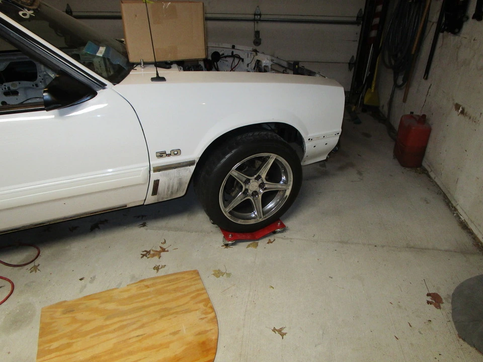

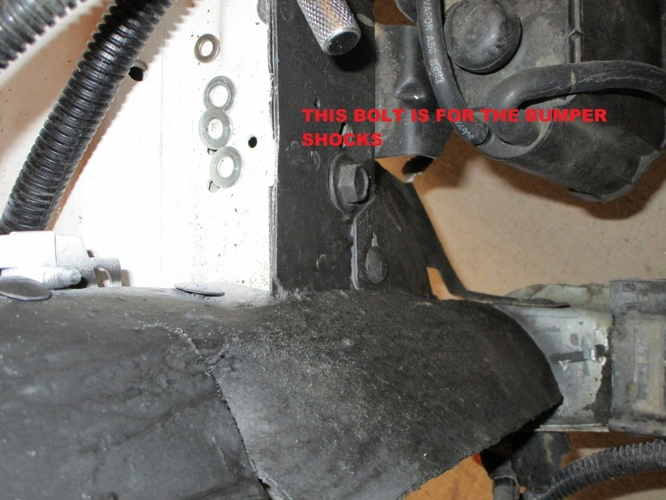

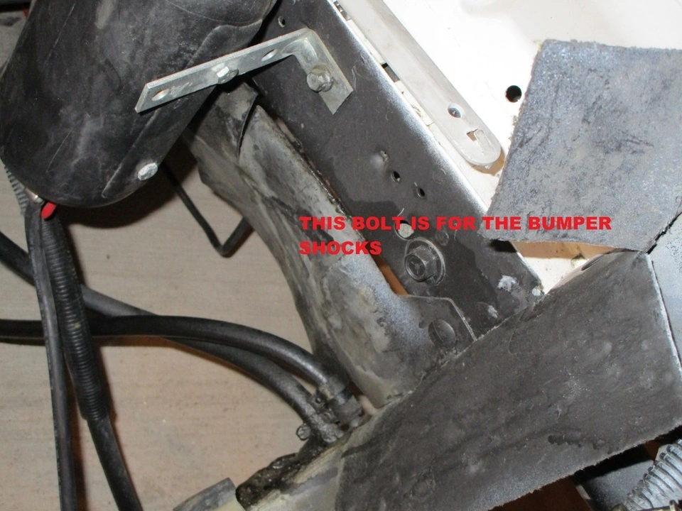

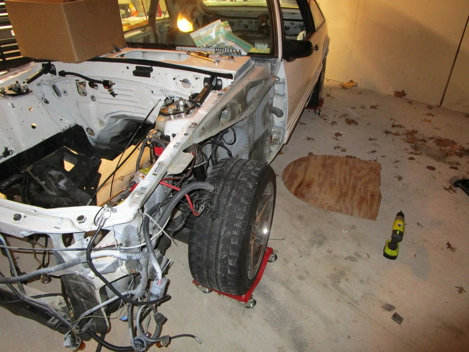

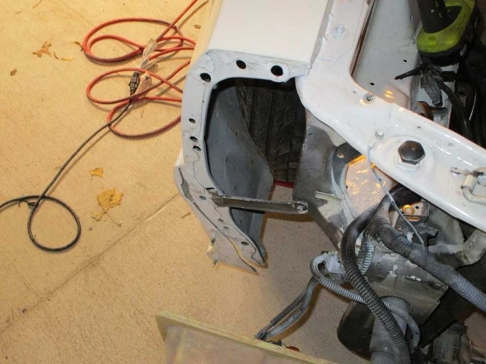

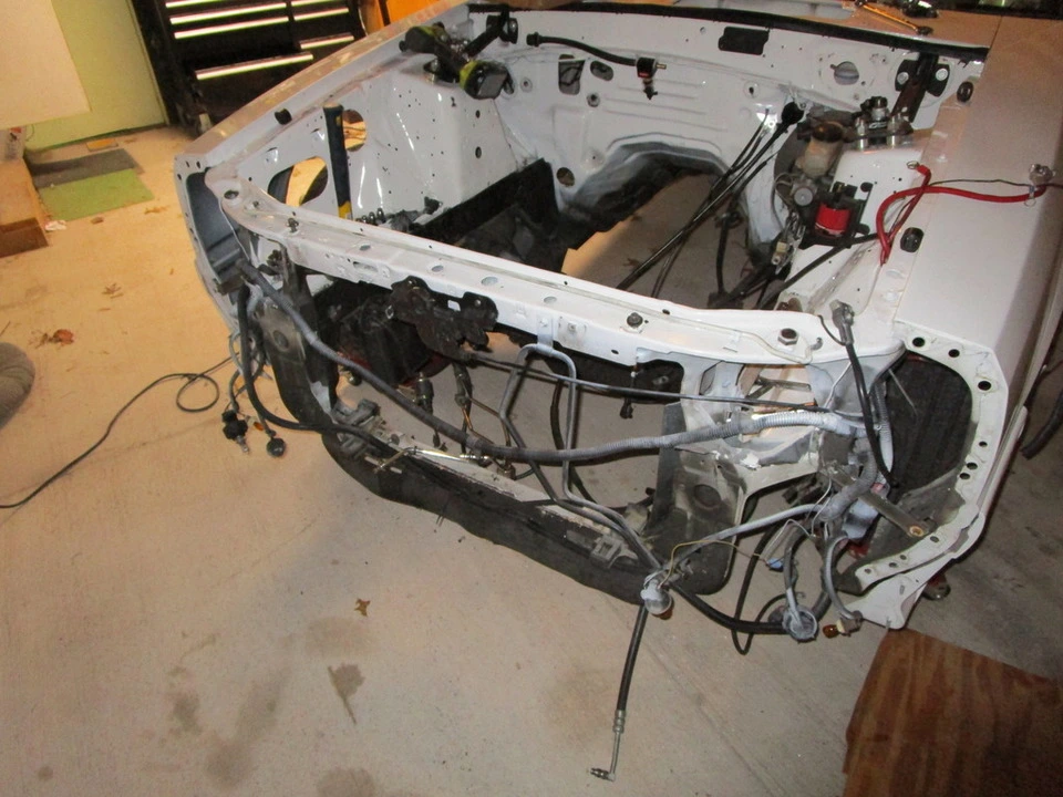

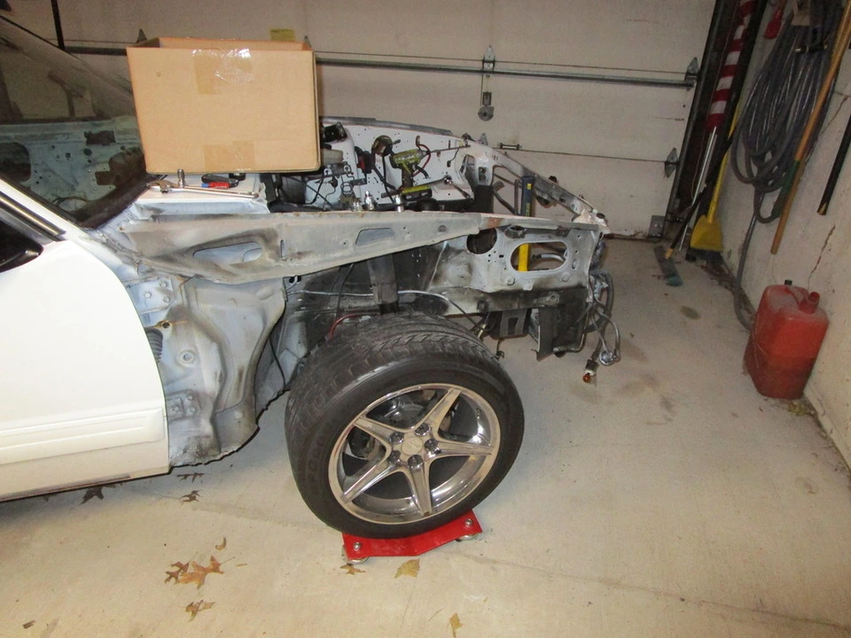

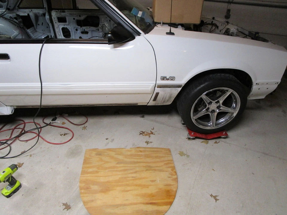

Today's tear down progress. Front bumper, fenders, and skirts are off in preparation for filling all the bay holes. Took my time doing this since I've never torn a car down this far and have NO idea where all the fasteners are. Actual working time (other than looking for bolts/nuts/screws) was really only about an hour, but took me about 2-3 times that.
Some MS Paint notes:
These pictures looks waaaay cleaner than real life, it was dirty as hell under those fender skirts/extensions
Again, way dirtier in real life. The darker stuff is 25+ year old undercoating that I'm going to have to figure out how to get off the whole bottom of the car.

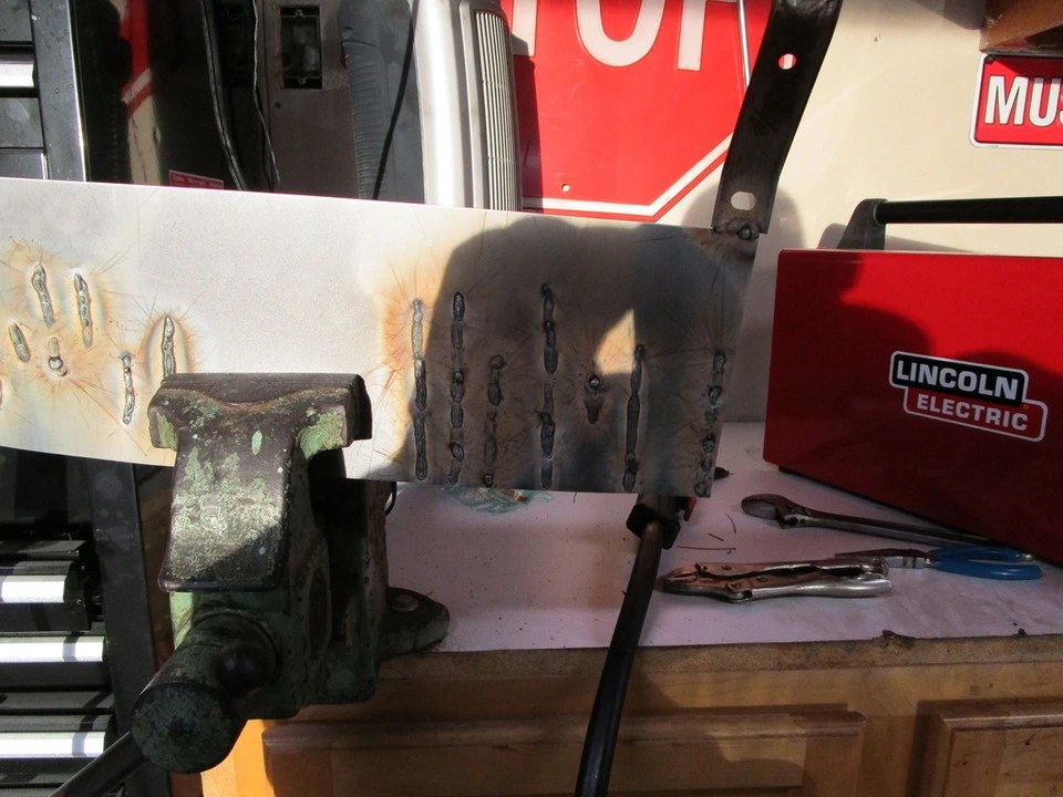

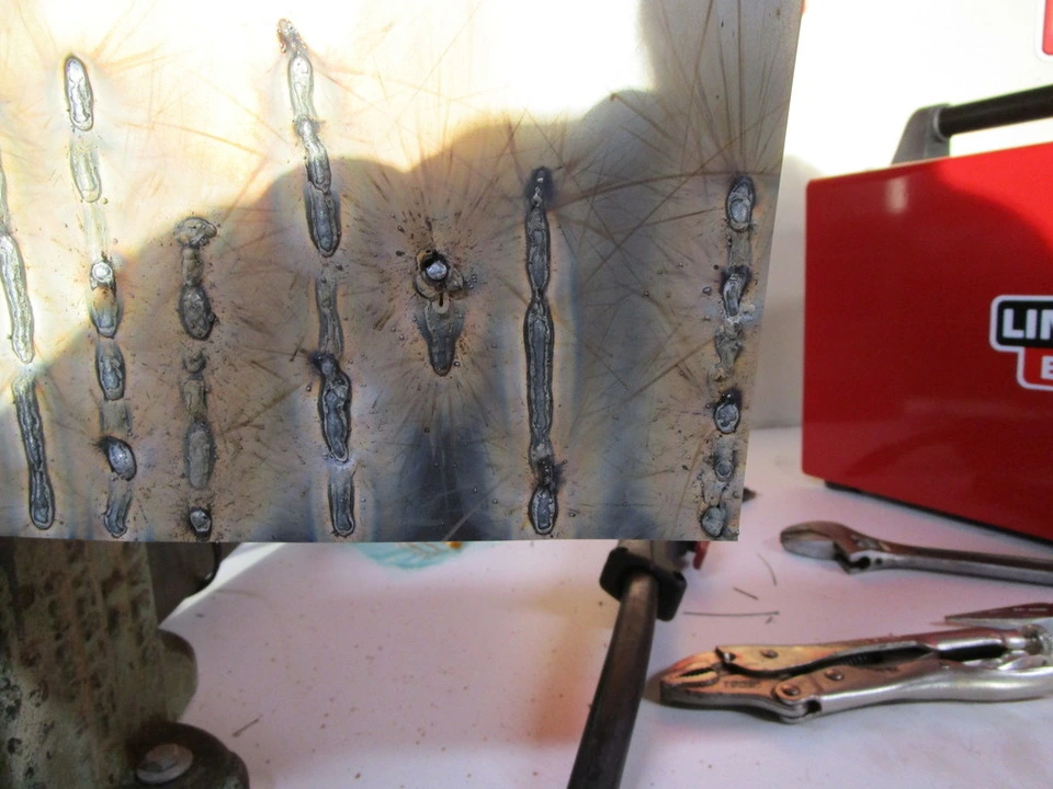

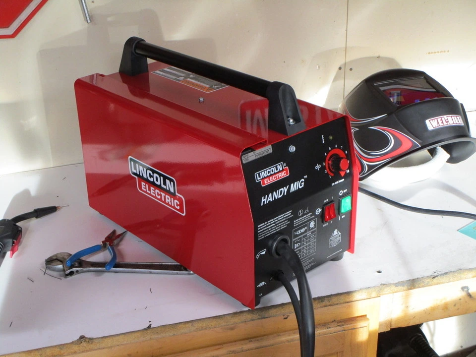

Monday I'm going to see about getting some MIG gas for this little guy

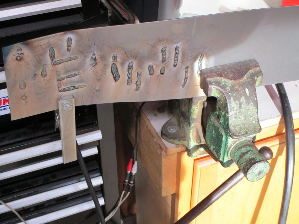

And just to show that it works, some crappy practice with flux-core on a piece of 16 gauge:
Let me give you some advice, do not bother with that trick flow intake, get something with a 4500 base, either a 2828 edelbrock, or a CHI 4.0, ported and matched to the heads. I have the CHI 4.0, but i would go with the 2828 if i had to do it again. I bought the 4150 version of the CHI intake, and ran it for a season like that, then milled it out to a 4500 opening, and gained 20-30hp. The 4150 throttle body and opening was causing 2" of vacuum at peak horsepower. If you buy the right parts the first time, you can make 700hp with it.
Even more food for thought, have you looked into 7721 edelbrock heads? I wish i had used that cylinder head from the start.
@Chuckman
Is that Lincoln setup to accept gas? It should have a gas inlet on the back. If you have an owners manual it will have some info on how to convert over and also how to change the polarity. Make sure you get new wire (flux uses a type of shielded wire) and a new tip for your gun for shielding the gas. Before I did my engine bay smoothing I too converted my Lincoln flux to use gas and happy I did so. My Lincoln was already plumbed and setup to be converted to gas. I have the Lincoln 140 and 0.025 wire worked best for me when welding up my 20ga panels.
Welder is setup for gas, came with regulator, lines, wire, tips, everything except the tank itself (or a decent helmet).

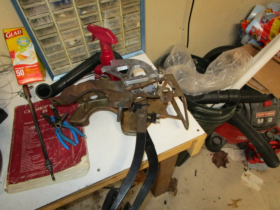

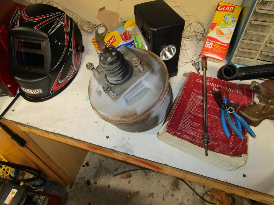

So let just say that this thing:
and this thing:
are SO MUCH EASIER to take out with the dash out. I've done it twice with the interior still in the car (once for the T5 swap, once for the booster upgrade) and holy crap, what a difference.

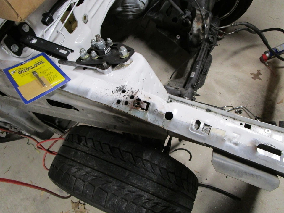

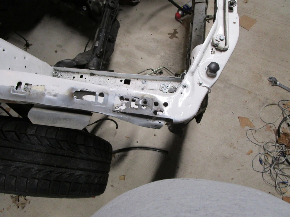

And on to things that are even more of a pain, I bought 3 of these spot weld cutters:
And after maybe 30-45 minutes (and one dead drill battery, and figuring out the hard way it was easier to drill a pilot hole first than to just use a punch), I stopped here for the night:
Since I know you've done these before @hoopty5.0, am I on the right path with the way I'm doing these? Any tips/tricks?

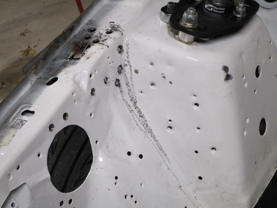

So I've spent the last couple nights learning how much I SUCK at welding. I think I finally have the machine set right to where it won't just blow a hole through (which usually happens to me when trying to "plug" weld thru where the old spot weld was and trying to fill the whole thing at once), but there's sections on the aprons that join 3 layers together that are then a complete pita. Probably also didn't strip off enough paint/e-coat, and i tossed some weld-thru primer at it also which i dont think is helping anything.
I'd post pics, but they're waaay too embarrassing to show.
It's fine they all grind down flat anyways. Besides, after you grind them down you'll see a whole and have to weld it again. The best thing to do is to practice on some extra sheet metal. Once you get it down then you get busy in the engine bay.
I bought some 1 1/2" copper pipe, cut it open and wrapped it around a dolly. Place it behind a hole you want to weld with the copper facing the hole and weld the hole closed. The weld won't stick to copper. Helps a lot! I'll take a picture of mine when I get home so you see what I mean exactly.
