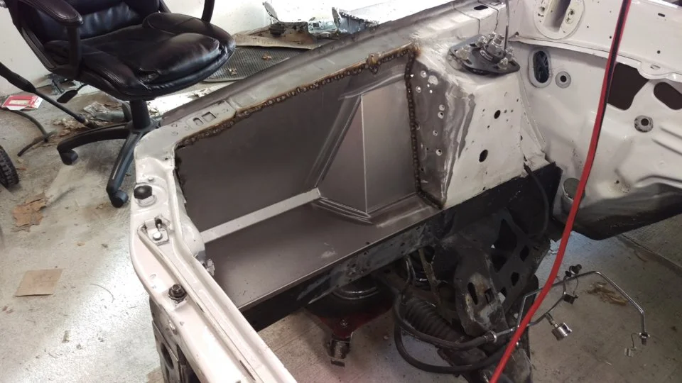

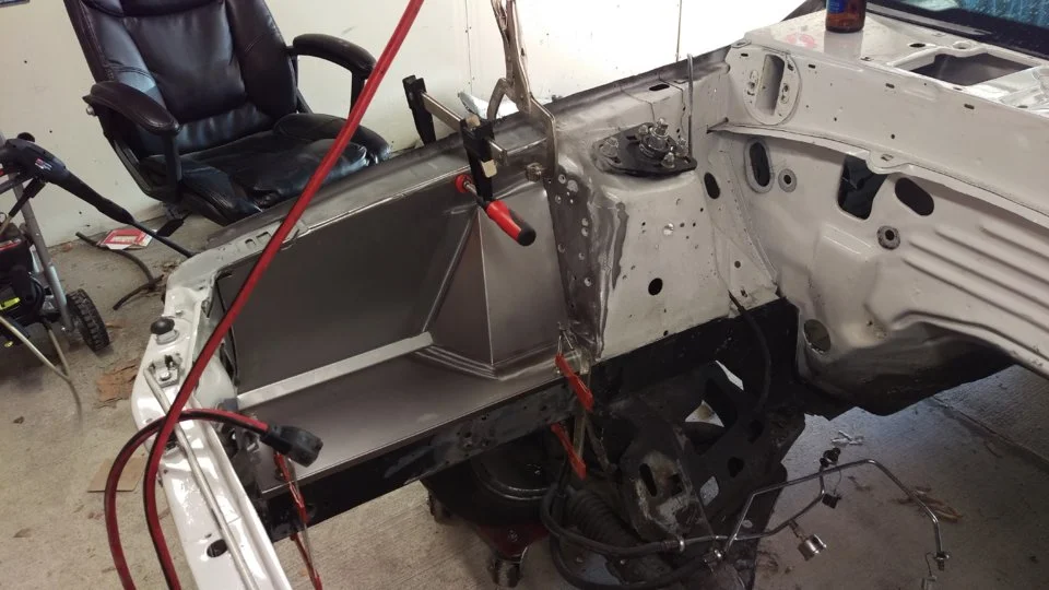

So I finally switched back to day shift today, which boosts the motivation factor enough to get a bit done this afternoon:
and melted in (future note to self again-only use the weld thru primer on the BACK of the panel, otherwise it's a complete PITA)
Ill try to get the other side tomorrow.

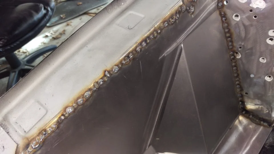

Question for those that are more weld-talented than i (like @hoopty5.0 ): on that panel above, I was able to get what seemed to be decent welds (no holes, and the right "bzzzt" sound) along the top (bare-is metal, bit of primer and e-coat) and front (still some paint), but along that strut tower (bare metal with sem weld thru primer) it just wanted to to keep popping and melting holes in the thinner panel. Do I need to adjust my welders settings, not use that primer, or just all around do something different? Using a small 110v handy mig with the provided wire and mix gas, with the gun at a 45 to both panels making a series of tacks about 3-4" apart.

If it's burning thru, turn it down. The other alternative is to move faster, but for someone who's not used to it the best bet is to drop the voltage, then adjust wire speed back where it needs to be. Sounds like bacon frying when it's right.

From my limited (and I mean limited) talents on welding, I agree with @Boosted92LX , either go faster, or turn down the heat and wire speed. One thing I've found in my welding self tutorial is that swinging a little wider on my welds makes them smoother, probably the same thing as speeding up. I cover more territory with the wire.
I don't know of anyway to actually run a bead on those panels though. If I remember right with mine, SR even says to tack weld around the parameter. The metal is just so thin. Maybe it's different with a TIG, I don't know.

It took a lot of trial and error, but I had it setup pretty good for plug welding the lrs panels which I think are 18ga. The SR ones are 22-20ga. And like I said it did fine around the other sides, it just didn't like that corner for some reason. Same settings (little less wire speed) as when I did the last panels. I'll try turning the amps down a bit tomorrow (was going to work on it today but a too tall lawn and an uncooperative lawn mower wore me out).
I'm actually trying to avoid a full bead entirely and just stitch weld with a :poo: ton of tacks to keep them from warping. A tig would be great if I knew how to use it, and it wasn't such of pita to on your back under the car doing torque boxes (a future project I have planned, actually ordered those before I had the car down to a shell)

I'm gonna guess that you are experiencing blow out from the galvanized metal not playing well when being asked to marry the mild steel you're trying to stick to it. If that's the case, you'll literally get a eruption of the molten metal that usually ends in a big assed hole. The solution is to prep the metal before trying to weld something to it. Since galvanizing is a top coated process, usually it can be ground/sanded off before trying to weld something to it. But at this juncture, it's too late for that. You'll just have to weld, and fix the mess that's made as a result of it.

Yeah, but there's bare steel, and then that section of bare steel having the galvanizing on the weld area ground off with a flap wheel. Unless you did that, you were welding galvanized metal. Was there white cob web looking junk on the back side of the weld in the shock tower? As for weld through primer.... I have never had good luck with it.

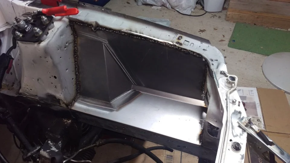

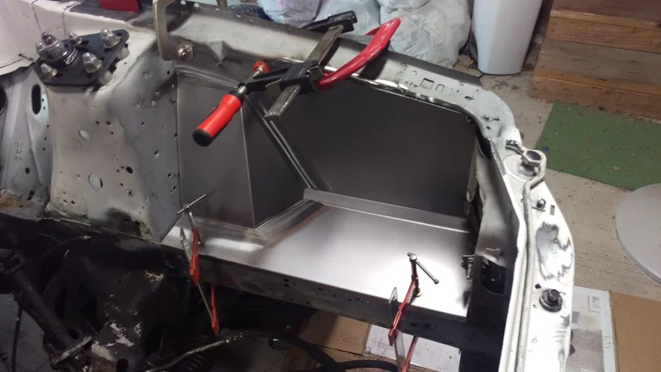

So got the passenger side panel about 80% welded before I ran out of both gas AND wire. Stripped all the weld primer from the areas I was going to be in, and it acted much better.
Now for some pics:
Now for some pics:
