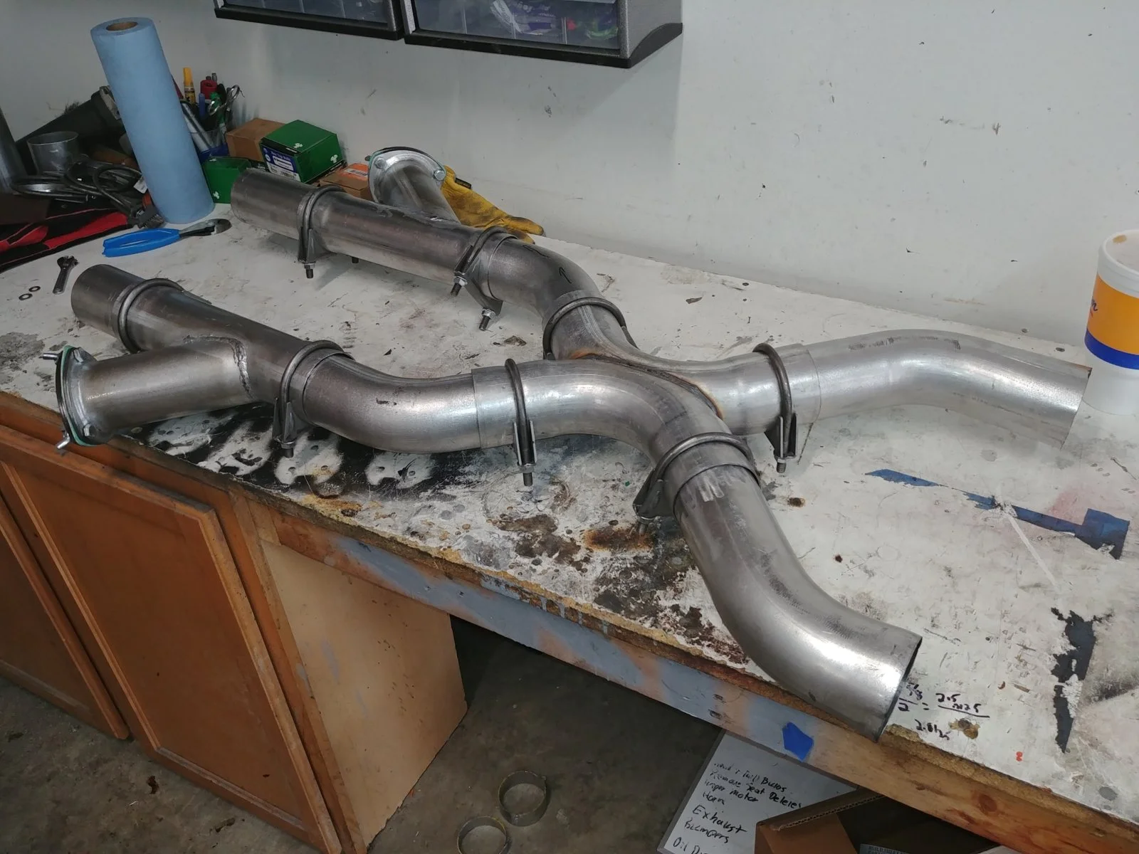

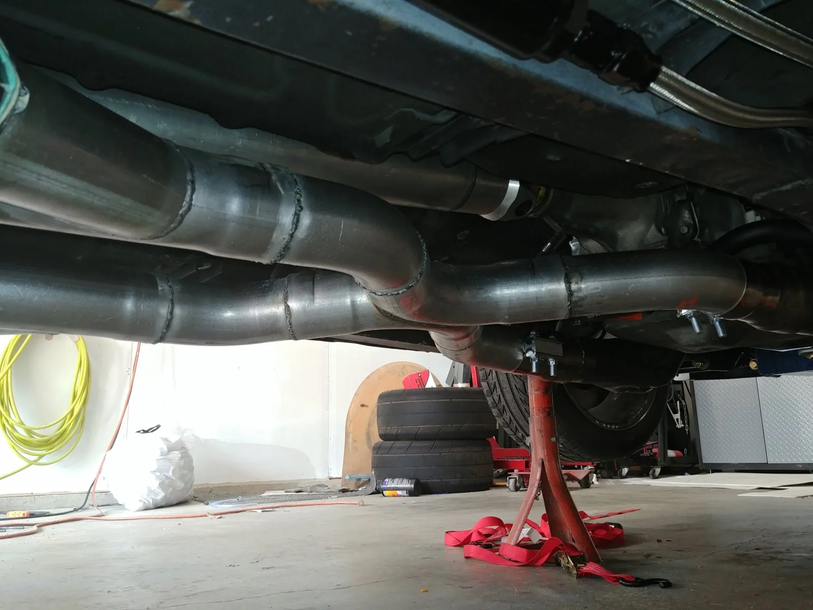

sn95 hanger, so the bigger 3/8 feed but still a dinky 1/4" return. the rest of the system is all -8, so if i ever get the itch i can swap in a different tank with a bigger (or multiple) pump.
just a bit. exhaust is on now, just clamped up ran out of mig gas and cant find my flux core tips so that will wait till tomorrow at least.
it is making a hell of a mechanical clack though, i know one rocker trunnion is looser side-to-side than the others, just hoping it something like that and not a rod bearing on a brand new motor (oil pressure is 50psi at idle and never drops, which amazes me since all my 302's have been like 25 or so). it's been making this noise since the first start, way more noticeable now with mufflers.

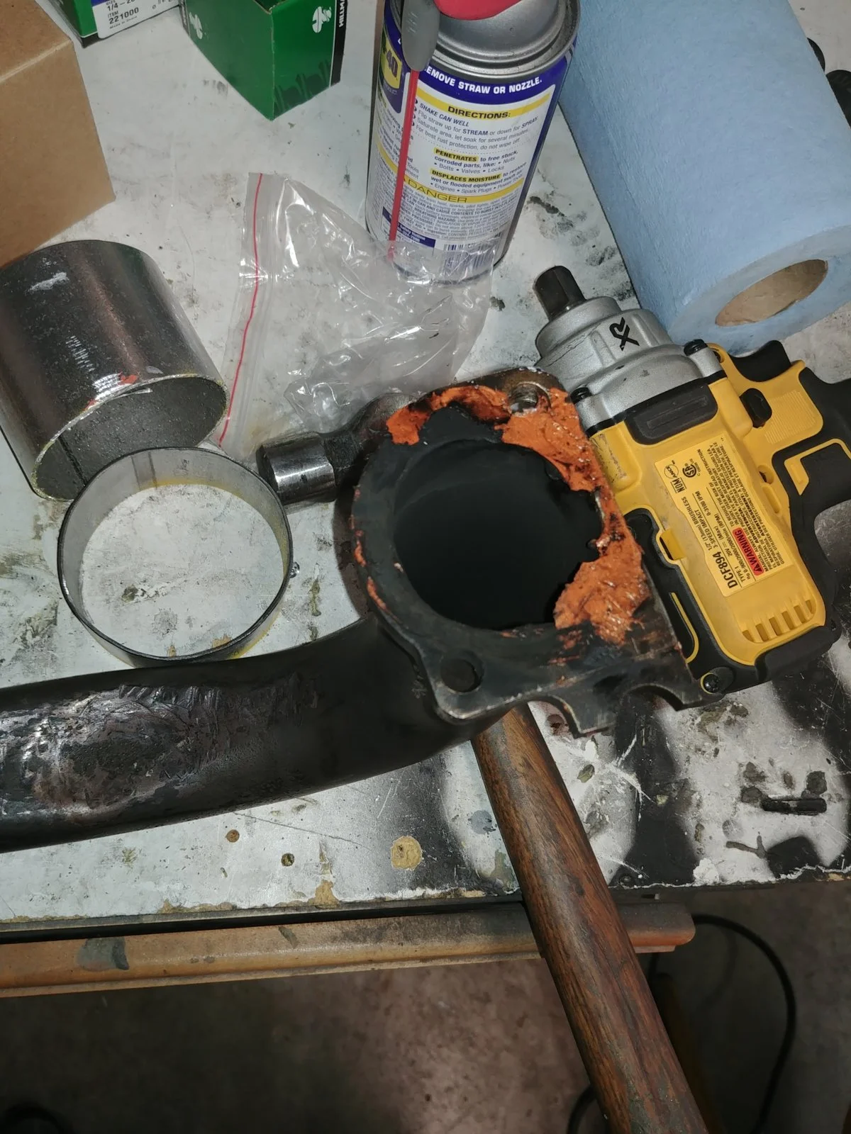

Just pulled the rockers and pushrods off #8 and noise is gone. Trunnion on both rockers has the same amount of side clearance, but the one on the intake once bolted down had way more wiggle than any other. That header primary also seems to be leaking pretty good at the flange, its the one single tube on that side and I already fixed a leak on the other end so I'll pull that tube, relash the rockers and if the noise is still there I'll order a couple lone rockers

Leaking for sure....also pig rich, but that's a whole other story

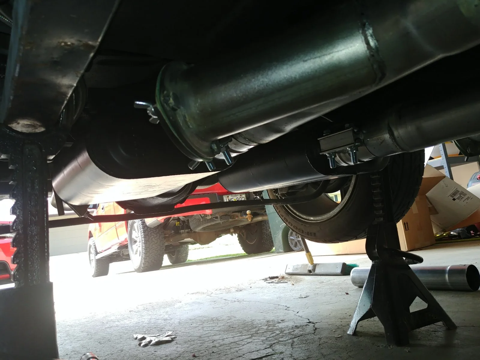

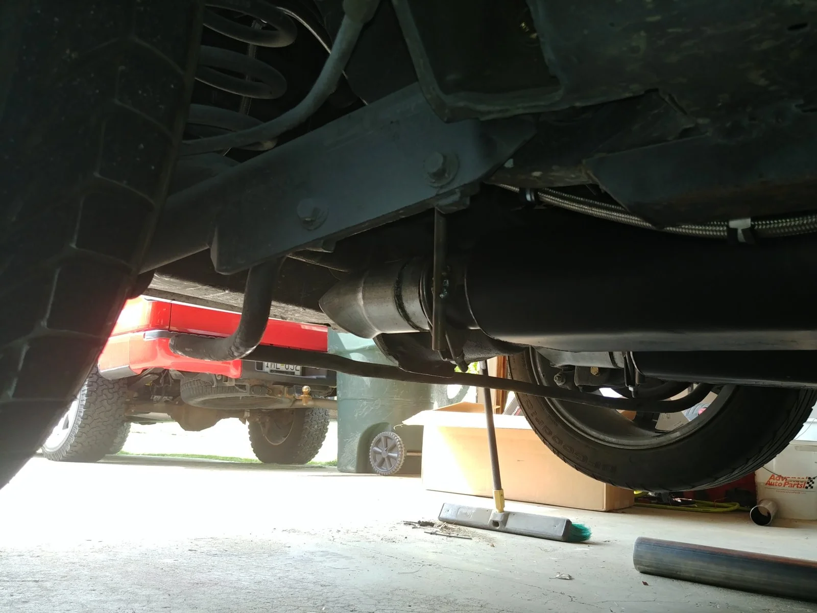

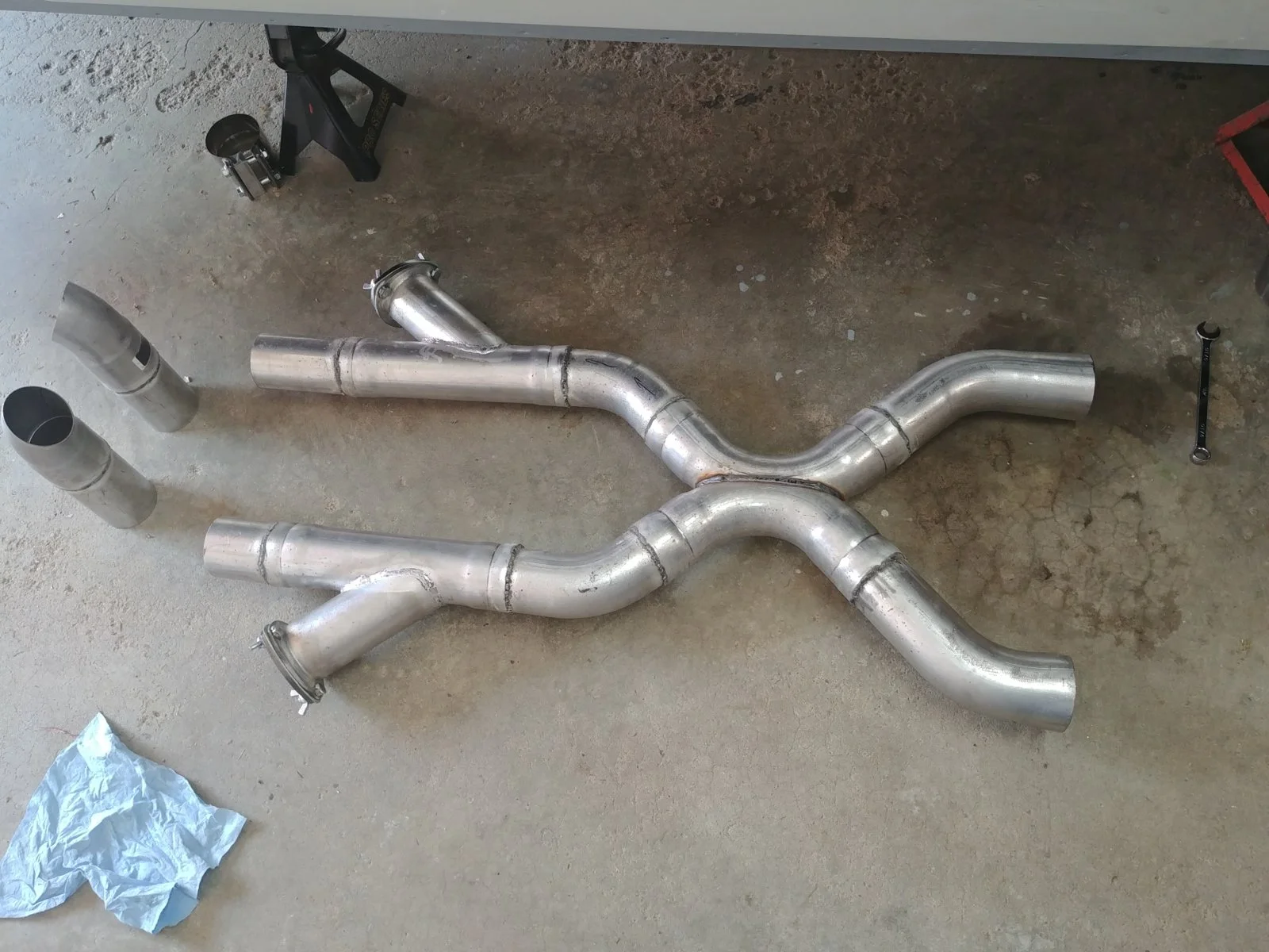

Welp, its for sure just a massive exhaust leak that i cant seem to get rid of. if i unplug the #8 plug wire noise goes away. resealed it and still no bueno (granted the rtv im using only had like 4-6 hours to setup but still). will have to put the thinking cap on for this one.
anyway, while i let that rtv set up, pulled the x, welded it up (had to switch to flux core, which it seems my machine runs better ), made some dumps, and threw it all back in. will get tails eventually if i can find a set of 3" with the gt dumps or find a set of lx ones cheap enough that i dont mind cutting the ends off.

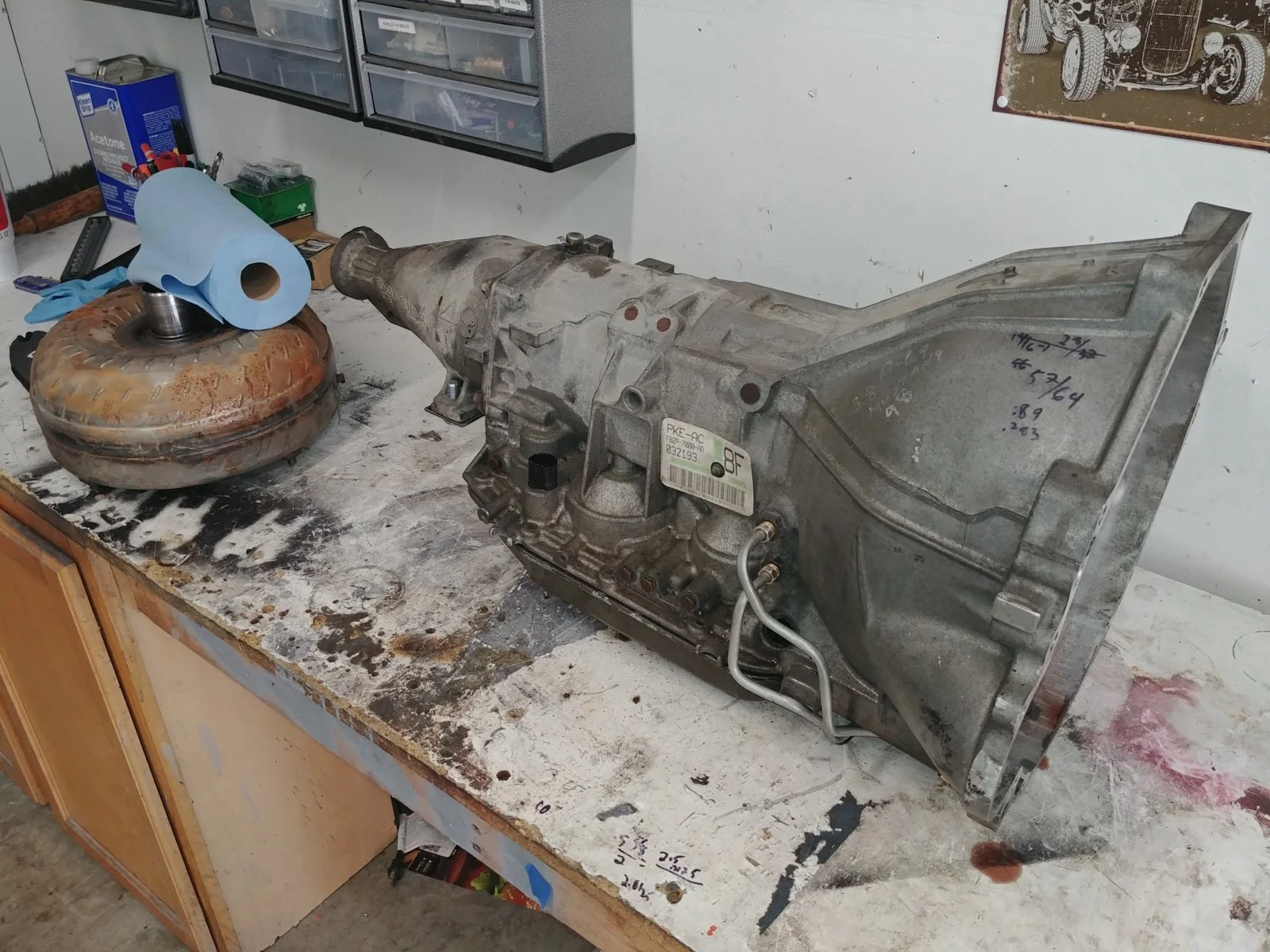

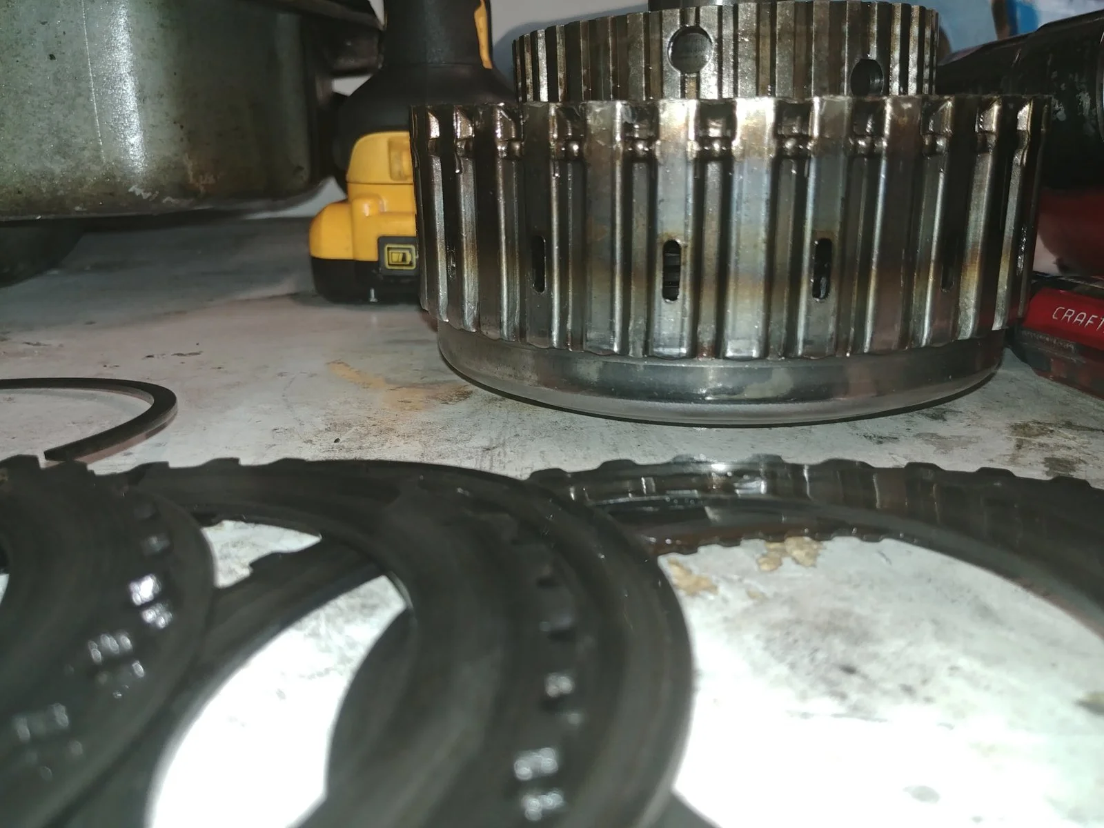

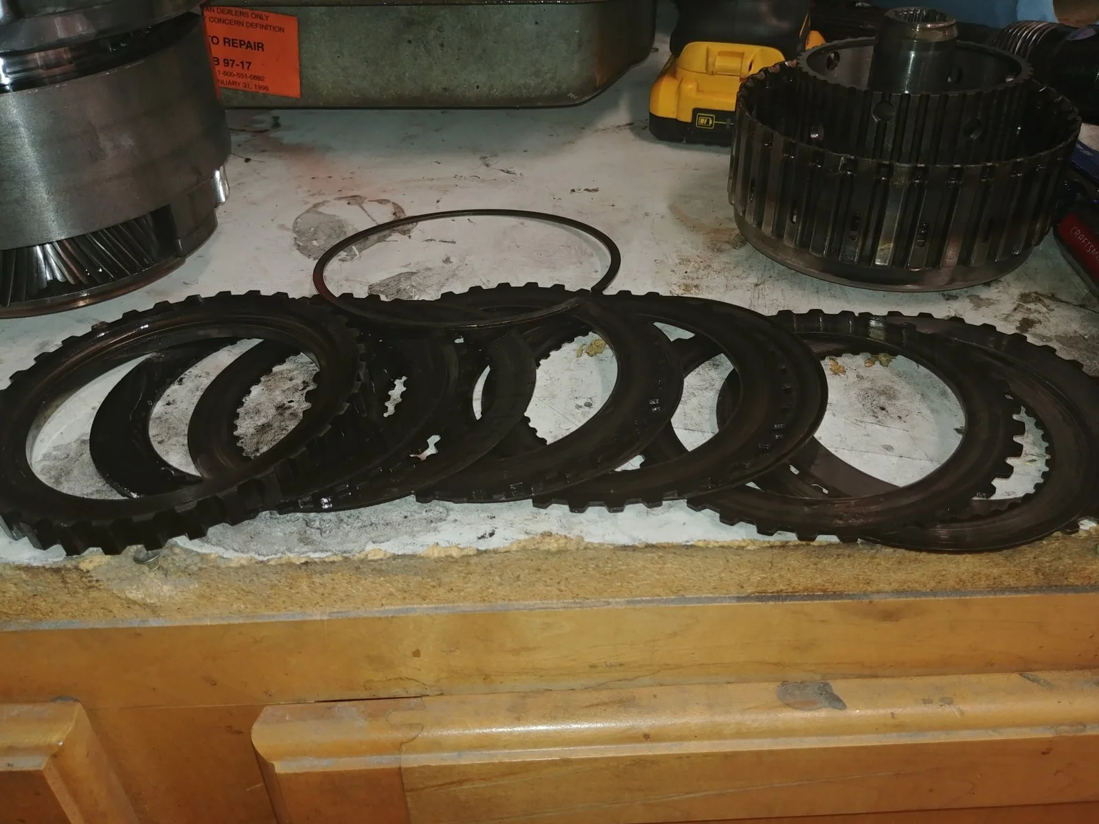

so i got plates for this thing, drove it to work a couple times, then this happened:
thankfully this happened on my way home from work and not TO work. had to limp it home in 2nd, not fun
out of 6 frictions, only the last one has any actual friction material, and thats only on one side.
have a rebuild kit with upgraded clutches (raybestos red) already, but that direct drum looks a bit too heat treated for my liking so going to order a new one. sonnax has an upgraded one that fits more frictions, is billet, and makes it and the stub shaft one piece (as well as a stronger sun gear). about to look up pricing but betting its waaaay out of my range. even the thicker top plate is heated all the way through.
intermediate pack also looks a bit toasty, havent taken apart the forward or reverse packs yet but the drums look fine so far from the outside. the od band looked suprisingly mint though so

FWIW-cause I am making no where near the power you are making, so I just ordered stock replacement parts-but I went through a local trans shop to order my drums etc and got them a lot cheaper than what Sonnax had those parts listed for online

The sonnax stuff is for sure super expensive, their upgraded direct setup is around $600, and the forward is another couple hundred. But it seems that's what you need for 1k+ hp (well that and maybe an upgraded planetary if someone can be persuaded to make them). I'm nowhere near that, so I just grabbed another used stock loaded drum off ebay. If I didn't already have the friction kit, there are modifications to add 1-2 clutches to the factory drums. While I knew the clutch pack was probably toast, I didn't think it would take the non-consumable parts with it.
Also have an oil leak to figure out (hoping it's just a valve cover or needs more etc on the rear China wall and not a rear main issue). Will also need to rebuild my dropped trans mount (seems my little welder doesn't have enough ass for 1/8" hotrolled in actual mig mode) as well as remake an exhaust hanger (mig failure again).

How many transmissions have you gone through (ie taken apart and reassembled)? I really want to find a core and take it apart, but after watching a few videos, I can't convince myself to do it. Seeing your pics above made my palms get sweaty.
i tore down a t5 before i found out mine was some bastard child and couldnt find a new input shaft, and also rebuilt a tko. this is my first auto, but as far as the drivetrain goes its amazingly simple. the only pita parts are some snap rings that need what the hold in, pressed down so you can get the rings out.
heres a good step-by-step vid series on the 4r, the aod is pretty much the same other than the electronics and some of the upgrades youll want to do (like 4r guts, larger od piston, and the input shaft deal). even has some clever ways to get around the "pressing" issue.
View: https://www.youtube.com/playlist?list=PL9lVw8TP7bh4_mIyEjmCq5fKrG-tb2Eml
im going a bit tangental in a few places for some upgrades (one extra clutch in direct, forward, and intermediate) but otherwise im following that series exaclty.
