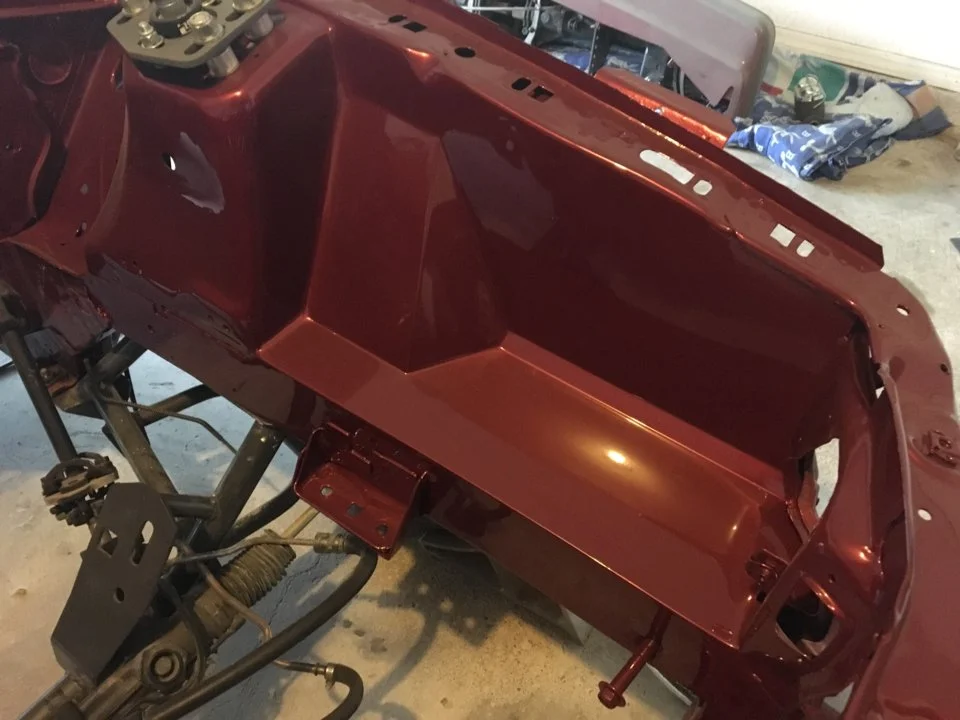

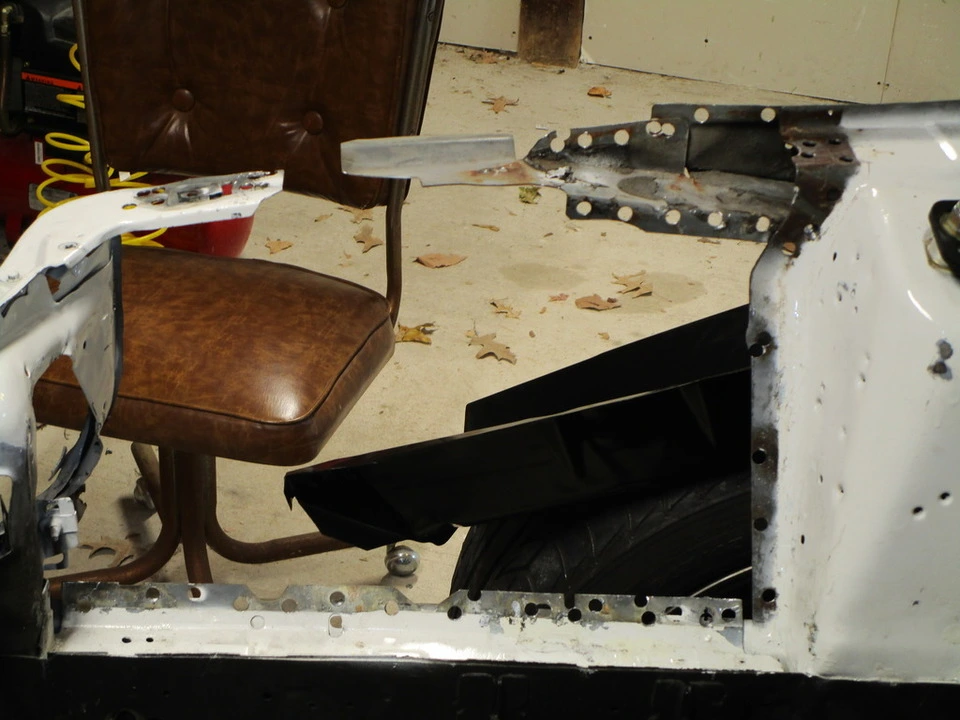

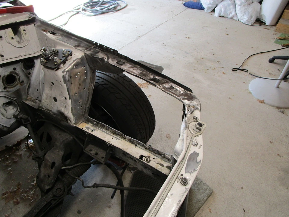

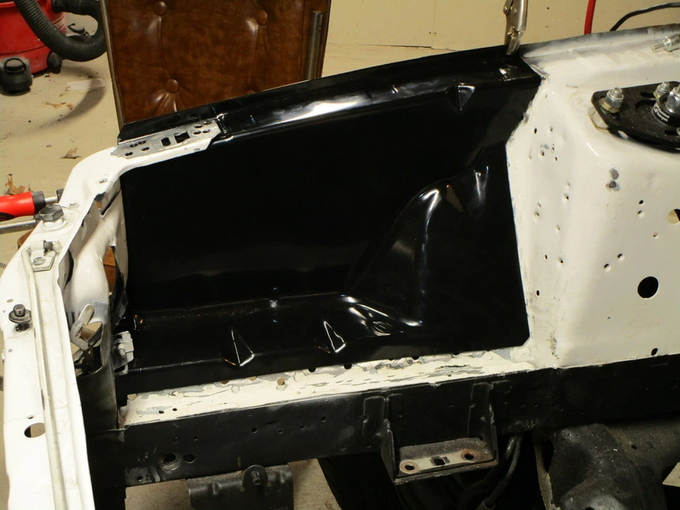

So after a few nites of piddling around with it (and getting a tad frustrated with my crap welding skills), I finally have the first fender apron in.
The hole the old one left (ick on the surface rust on the top there)
Test fitting the new panel, other than the fold over the the upper "rail" it fit pretty good.
Welded and partly dressed. Not sure if I'm going to to grind down the welds on the bottom since the plan is to cap off the top of the frame well and it will be hidden.
As an aside, since one of the stock Pirellis on the coyote started a slow leak (not to mention that at 24.5k they were getting damn scary in the wet), I splurged and get her some new shoes.

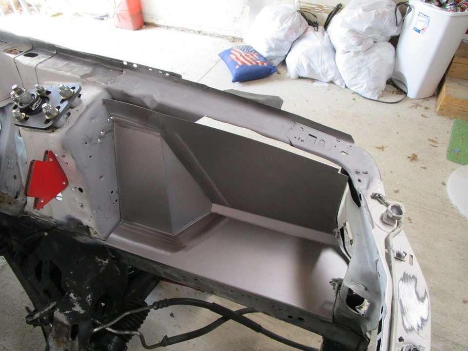

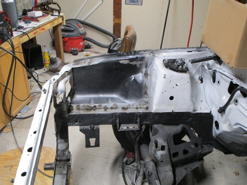

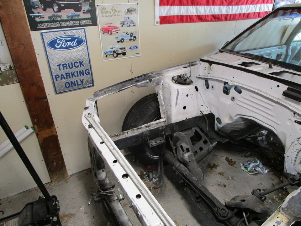

Bringing this back from purgatory. I've been living in what was my mom's place since she passed (actually grew up in this house), and I finally came to the conclusion that it's time to move on and find a place of my own again, which put car stuff on hiatus while I made up my mind on what to do. I think its going to be easier to just use some of these parts than moving them potentially twice (once to storage, and again to a new house), so I'm making some progress again. Also ran into a small snag kinda early on, hoping someone ( like @Davedacarpainter since you just used these, and I know there's lots of others) can help.

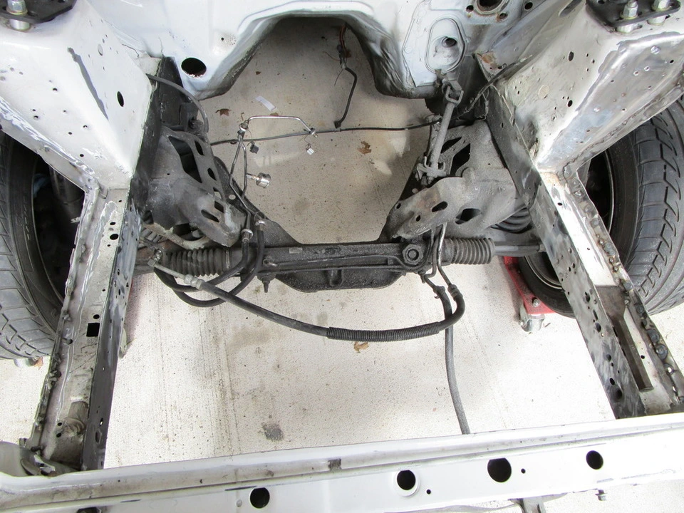

I decided after welding them in that I HATED the way the lrs aprons looked compared to the Scott Rod stuff, so I ordered the SR aprons.
Cut the old ones out (drivers side took almost a whole pack of reinforced dremel discs, I smartened up on the passenger side and use a 4 1/2" cutoff wheel on my grinder and had it out in less than 10mins)
Also took out the sway bar mounts (breaking 4 1/8" drills in the process, wtf? I didnt break any when piloting all spot welds removing the aprons) and then gave the bay a quick powerwash.

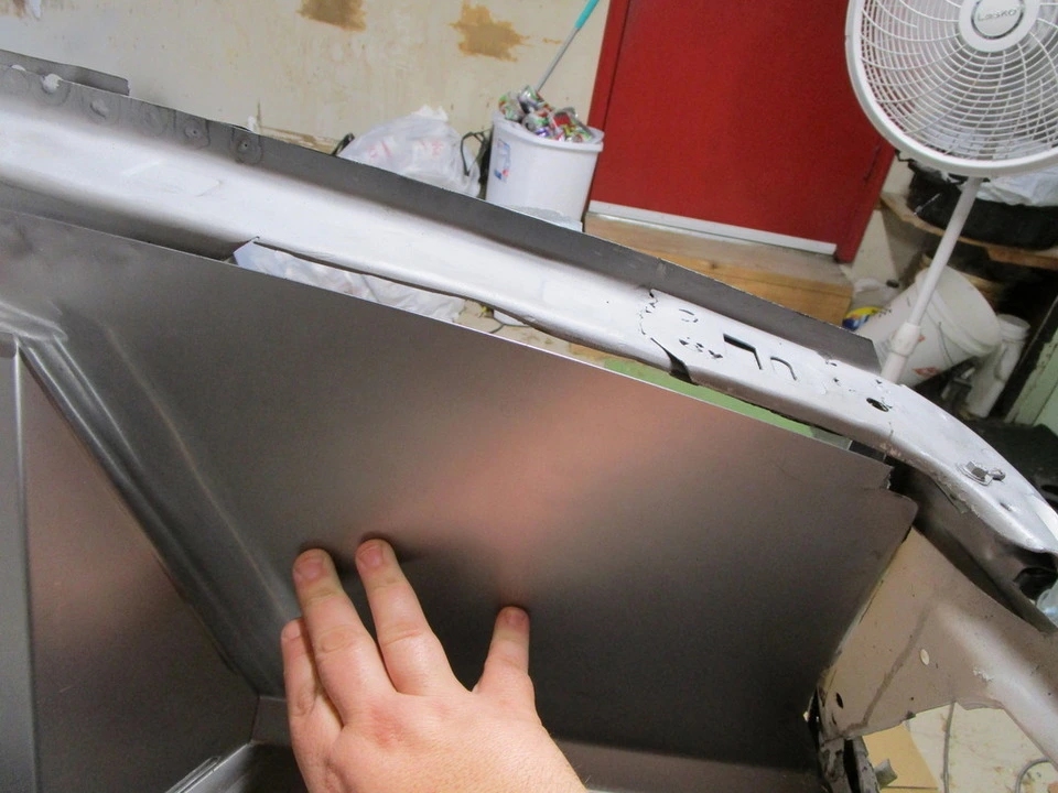

And here's where my problems began. I started test fitting the new panels, and had to trim the front end of both of them a bit. The passenger side fits great:
But the drivers side i can get to fit flush at the top at all?
I don't see anywhere where its hanging up, and its sitting on the top of the frame rail like i think its supposed to (the tang is supposed to wrap over the rail, right?). It almost seems as though the frame rail is too far inboard? Of course, I could just be doing something wrong somewhere I'm not seeing? This car has been hit in the front, but that was really just on the other corner/side that seems to fit perfect? I don't want to just muscle into place as i think that will make the thing start to wave up.

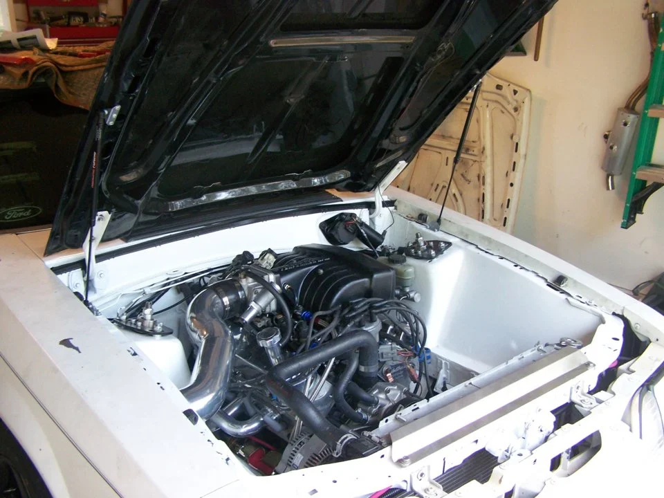

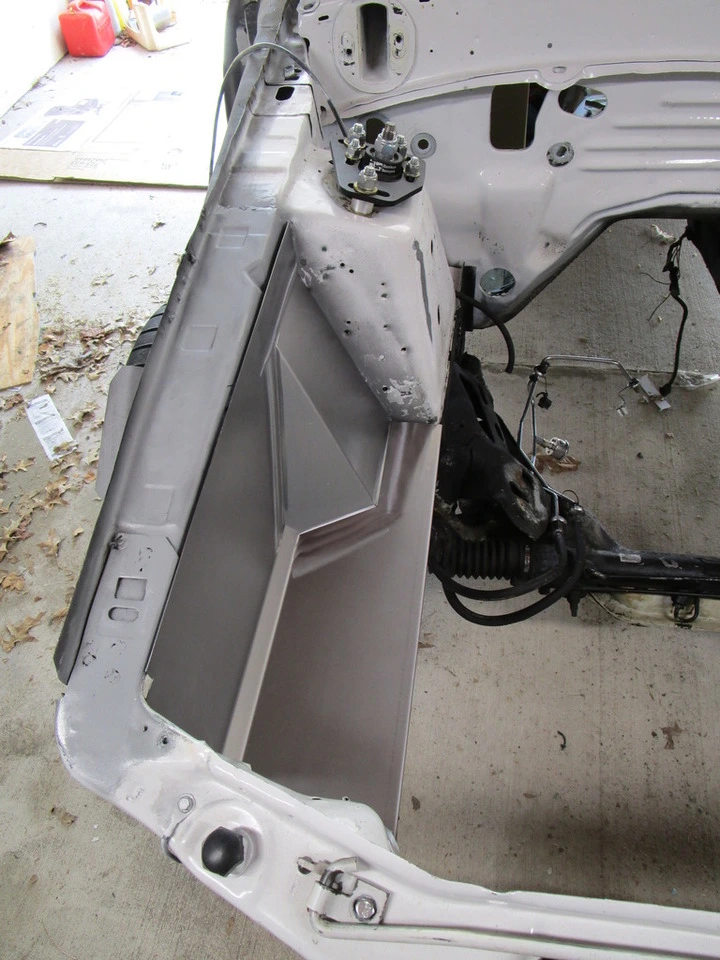

Hey man, Scott Rod pieces, nice.
I just put mine in a while back. I had to trim on the driver's side by the shock tower to get it to fit. I welded mine straight down on top of the frame rail. The frame rail is not exactly straight, huh?
You could dig through my thread and see how I put mine in if that will help you.
Here's mine all painted, I love the look of Scott's panels.
Let me know if I can help you out.

Frame rails definitely ain't straight, they kinda splay apart towards the front.
I think I found my problem though, looks like I didn't remove enough if the lrs panel on the front bottom corner, and was tilting the SR panel. Got back in there with the cutoff wheel and it fits much better, but now it looks like I cut too much off the top on that side cause when I laid it out the top of the SR panel was sitting even with the fender mount surface, looks like it's actually supposed to be significantly lower. Oh well, I think I have a plan to fix it so might be no biggie.

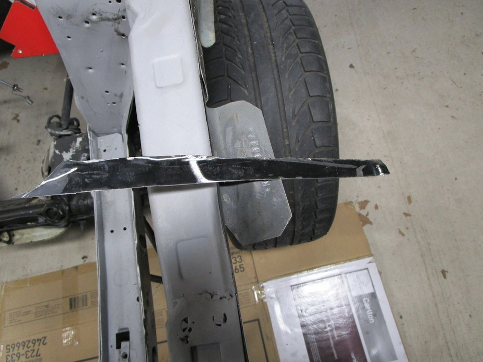

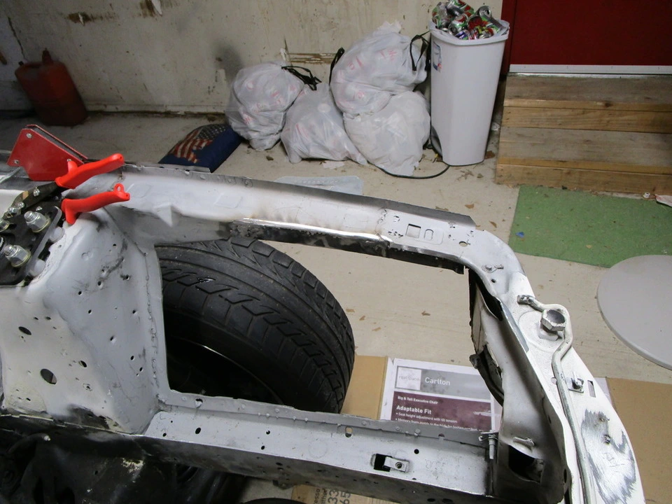

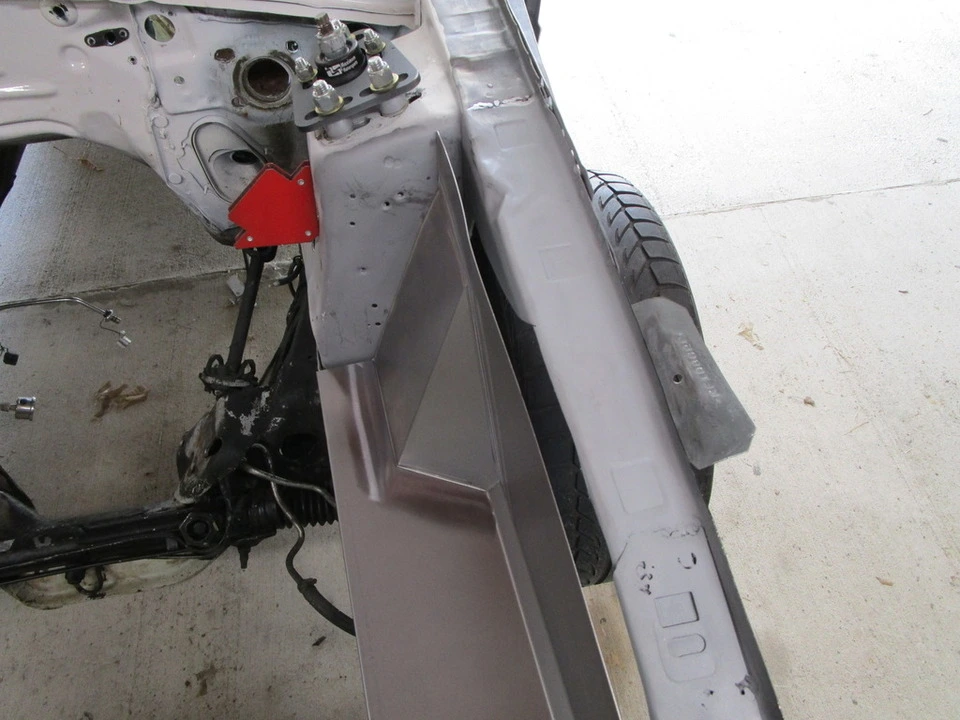

So looks like my fix plan is gonna work. Take notes, kids, cause its easier to do this right the first time than it is to fix a silly up like this.
So here's where i cut too much off the old apron, waaaaay to much to just fill with weld, though i know some idiot some where would try:
Solution part one: Cut a strip out of the old apron that you saved for just such an occasion:
After a little welding and grinding (and welding, and grinding......man i need to remember to turn my wire speed back down after failing to fix a chair), you have enough "old" apron left to weld your new apron to again:
I'm back to work tomorrow night (took a long weekend while my aunt flew into town), hopefully I'll be able to switch back to day shift here before too much longer, but maybe I can get at least one apron in by the weekend.
Reactions: A5literMan and Davedacarpainter

Glad you got the panel fitted, like I was saying, I had to tweak mine a little along the shock tower area.
Don't throw fits over the way the SR panel fits to the frame rail, like you said, the rails aren't straight.
I guess you saw what I did to mine, I tacked originally to the top of the rail, use a cutter to cut along the straight SR bend, then ground down that edge to follow the frame rail. I'm glad I went back and did that, it looks good painted that way. Don't be a bonehead like me and tack it down too fast. That thin metal warped real nicely. You don't sound as stupid as me though!
I read the rest of your build plan, big project, isn't it?
Love the idea of your engine, I wouldn't mind having that myself, maybe someday......
Of course you're going to mini-tub while you have the interior out?
