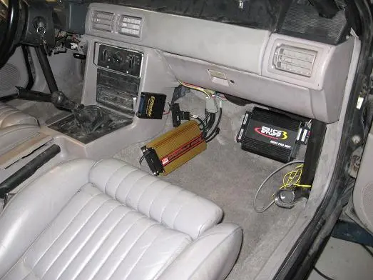

No sir. I am in love with the recaros in that car. It's the black car:

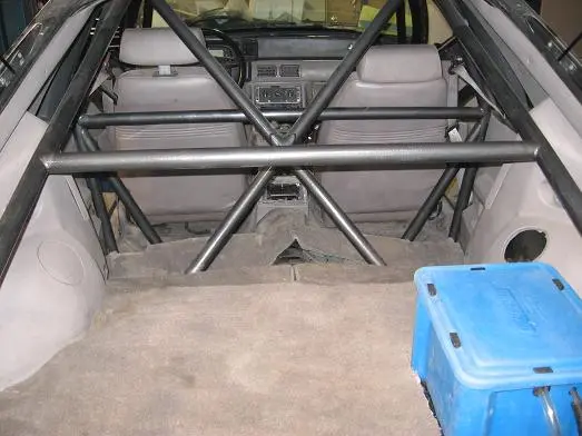

BTW, still thinking it'll have a black interior in the future. So, black seats make sense. Also, here's what the bars look like, if it matters:
630281
It's an older pic from before the mini-tub...

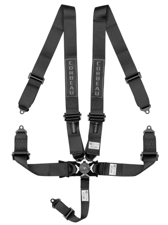

Crow harnesses with the cam lock got my vote for sure.
