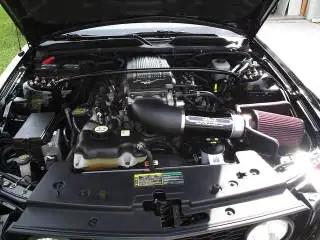

you might check this? Or maybe not. I keep getting the message my pics have too many pixels to post. Don't know how to change them. What I can tell you is if you use an open ended "Barrel Nut" you can then thread the nut in place of the factory nut, then install your T/Brace. This will effectively raise tour brace approx 3/4". Have done this with mine and have no clearance problems. FRPP Ford Racing brace, with intake cover installed.

Your JLT Intake looks a little different then mine.... Is that the JLT sticker on the inlet tube or something else and did you add something around the heat shield or did it come with it?

What I mean by open ended is, you can thread a bolt or threaded rod from both sides of the barrel nut. In other words, replace the two shock tower nuts with the barrel nuts, [use loctite for ins.] Now you should have approx 1/2" to 3/4" in of clear thread at the top of the nut . Using a flat washer, then your brace, another washer, [if nec] then bolt through once again using loctite. wahlah! Looks clean and no clearance probs. Got my Barrel nuts beleive it or not, at Ace hardware. Try to get Stainless Steel!!! Won't rust, just don't overtighten or the might gall. I pulled to 20lbs on upper bolts.
