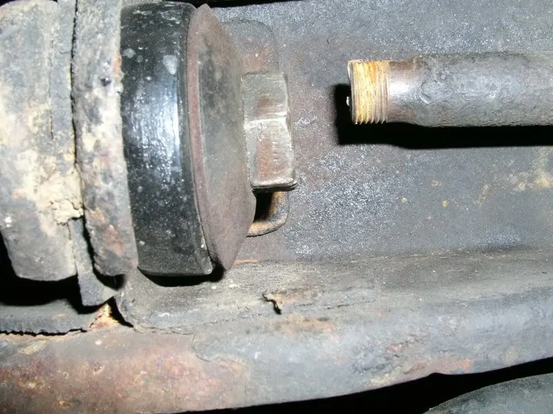

Which are the best, poly or rubber bushes as regards stress on the strut rod, and has any one experienced or know of a strut rod shearing off with poly bushes fitted?
You mean like this?

The rod in the pic has urethane bushings, and since it failed at the thread, where it thins slightly, corrosion was not the cause. The stiffness of the urethane bushings force the strut to flex at this point slightly, which they were not meant to do, that's the bushings' job. I wouldn't use anything but neoprene on these.
