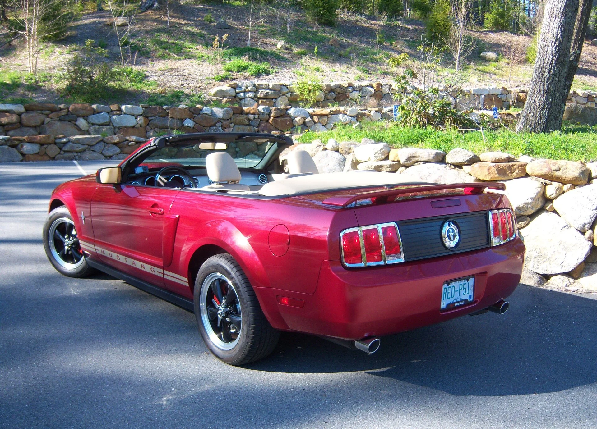

I agree with cbxer55. I keep the OD off until I need it. No shudder on mine, just a bit of a drone sound going uphill in New Hampshire mountains with the Flowmaster exhaust system. Maybe the car is asking to put the top down. lol

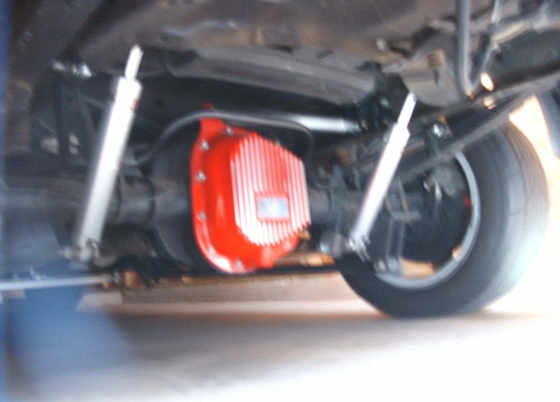

I've had my 98 Ranger 20 years and changed the fluid and filter twice, at around 10 years each time. Had my Lightning 10 years and will be doing that here soon. Have a deep pan for it with a 4 X 4 filter and 16 quarts of fluid. Mag-Hytec pan. The pan matches the differential cover. Bought as a matched set.
