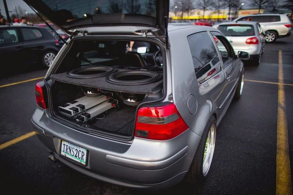

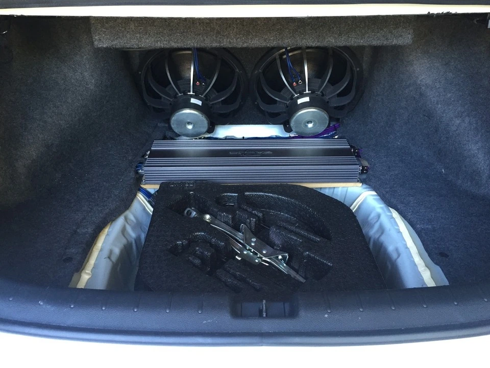

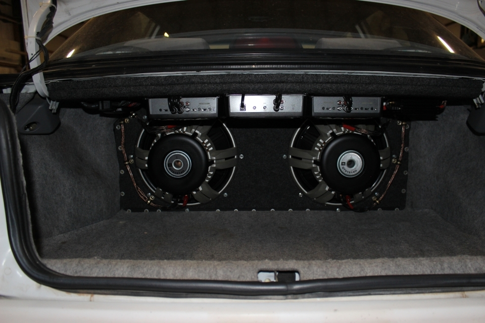

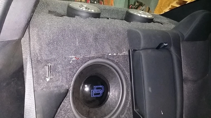

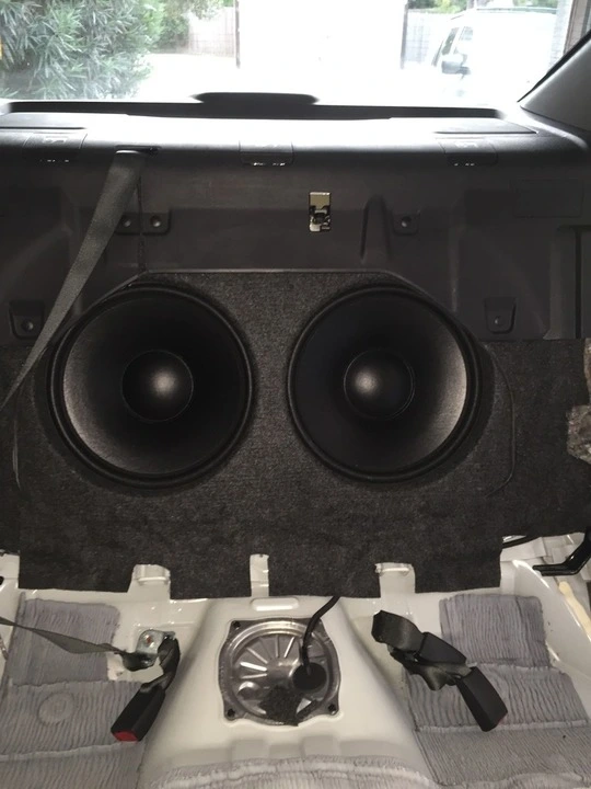

Well depending on the subs you can just go isobaric. Just make the rear seat delete section secure and sealed to the opening, cut the sub holes, mount them and you are done. With the right sub IB configuration is quite spectacular. You have to remember you will reduce the speakers power rating but that does not matter as they will be louder per watt.
Image Dynamics, JL W6 or W7, Dayton Ultimax, Dynaudio Esotar, Focal Powers and a few others do excellent in this configuration.
Well depending on the subs you can just go isobaric. Just make the rear seat delete section secure and the sealed to the opening, cut the sub holes, mount them and you are done. With the right sub IB configuration is quite spectacular. You have to remember you will reduce the speakers power rating but that does not matter as they will be louder per watt.

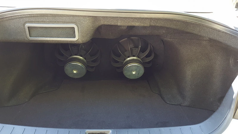

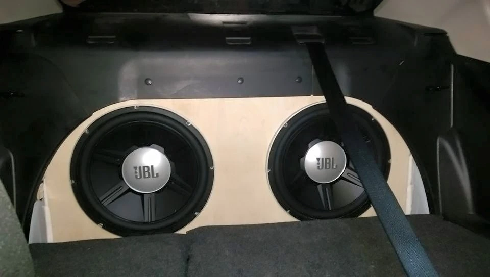

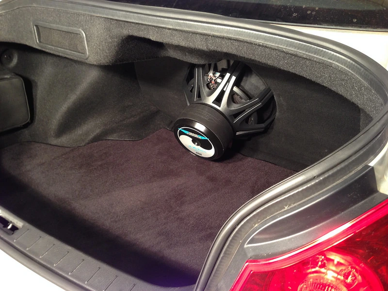

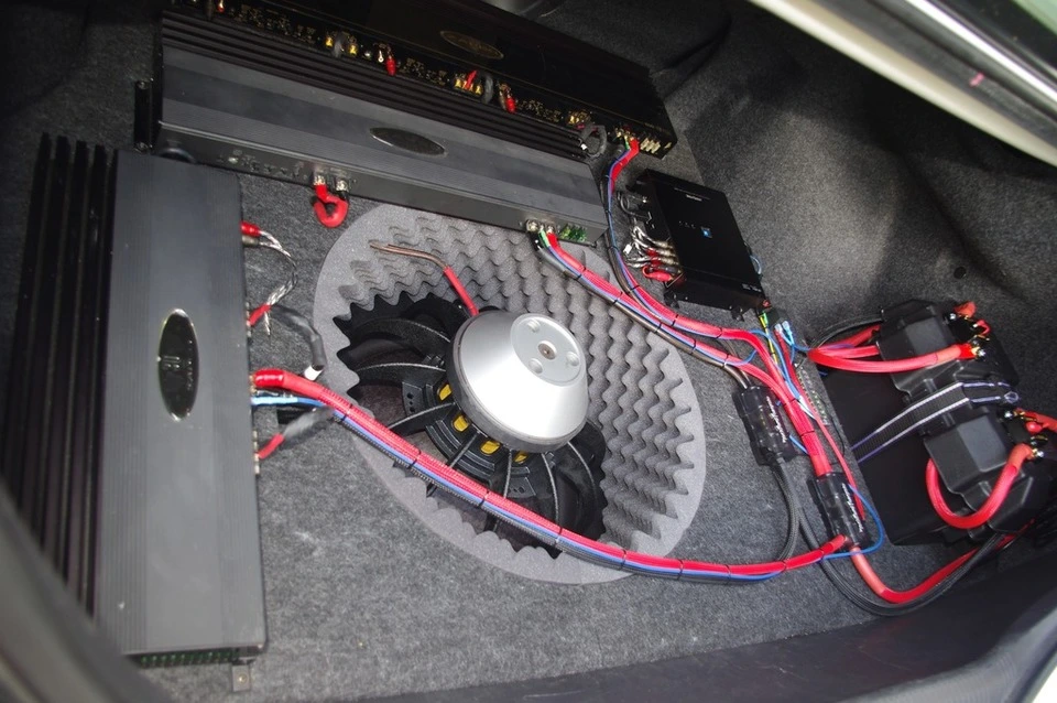

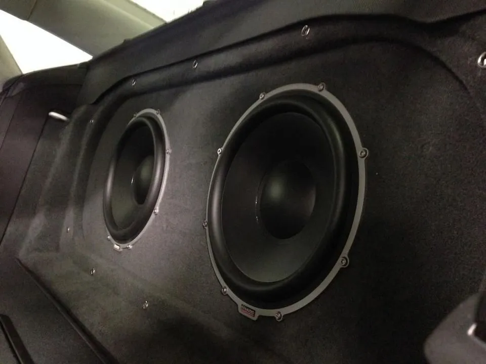

Some of the winningest systems run IB. Those subs would work great in that config with the small Mustang trunk. Just make sure the trunk lid seal is good and you will want to sound deaden the entire trunk but it will work fine.
Here are several $15k+ systems:
