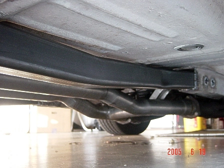

We're using Maier's SFC and liked the install very much. with the "4 points" mounting it acts like a truce which significantly stiffens the body. These weld in. We initially bought some bolt-ons and they became scrap tubing in my scrap pile. although not shown yet, we are in the process of assembling our 65. See posts by AdamInChains.
http://www.midnightdsigns.com/Mustang/subframe.html
