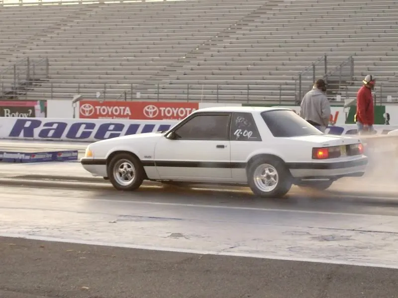

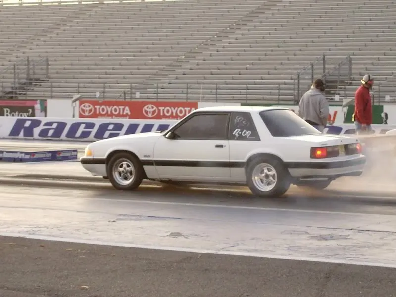

I have a couple crappy pics.
Here's a white notch with pro-stars that we saw at the track.

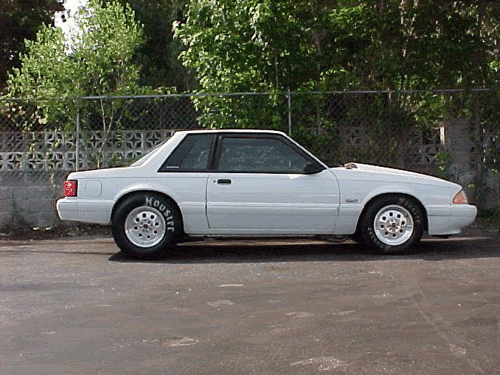

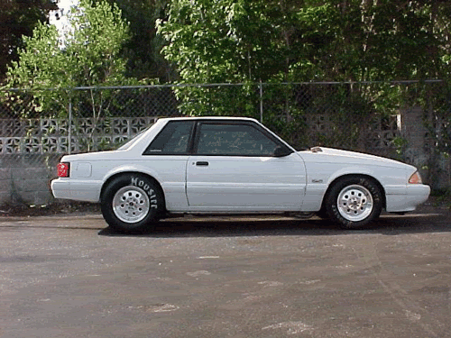

Here's one with draglites.

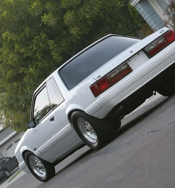

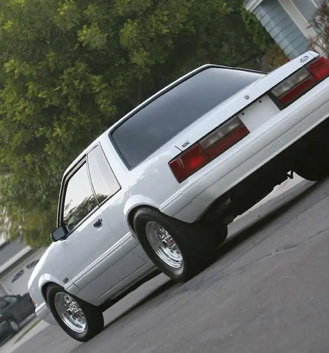

And a really nice one with draglites.
